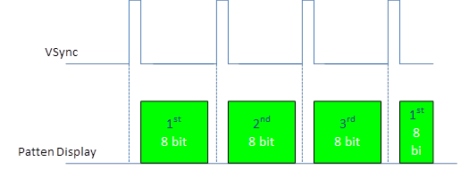

  • Hi Diao,
    Your steps are correct. Unfortunately this behavior cannot be avoided. The reason provided below.
    The DLP_Display_DisplayPatternAutoStepForSinglePass is firmware realized feature in the DLPC200 controller.
    The embedded firmware of DLPC200 keep track of number of patterns in the sequence so on every pattern dipsplay it keeps decrementing the number of patterns counter until the last pattern. Note, the  patterns must be shown for defined exposure time so all the patterns have to be displayed for the complete exposure time. Now  after the last pattern is displayed the firmware basically disable the Illumination LED_Enable strobes and stops the pattern display sequence. Therefore, there is a latency involved from the time of displaying last pattern to the actual disabling of illumination and Sequence Stop, until then the next pattern (which is the first pattern) is displayed.  There is no way this behavior cannot be avoided.
    Referring to picture below, for 3 8bit pattern display sequence after the last pattern display, the 1st pattern is shown for a short time until the LED_Enable and Sequence stop.
    You will realize by observing that the first pattern displayed after the last pattern is displayed for short duration time, it is not displayed complete exposure time.
    Sanjeev

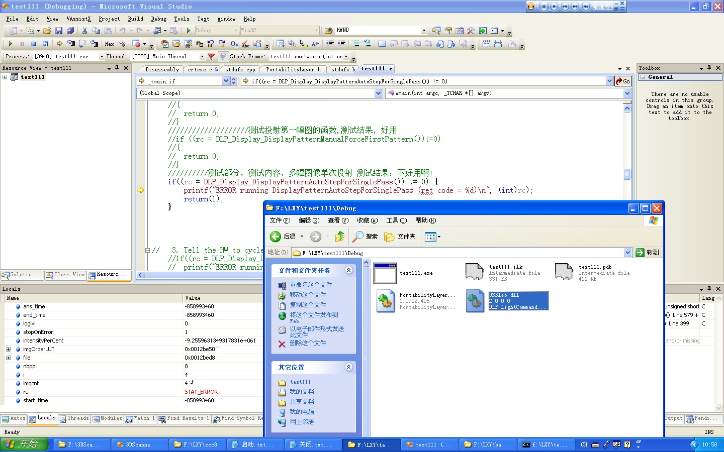

  • Hi~
    here is my programme
    it doesn't work sometimes.
    thank you~~
    -diao

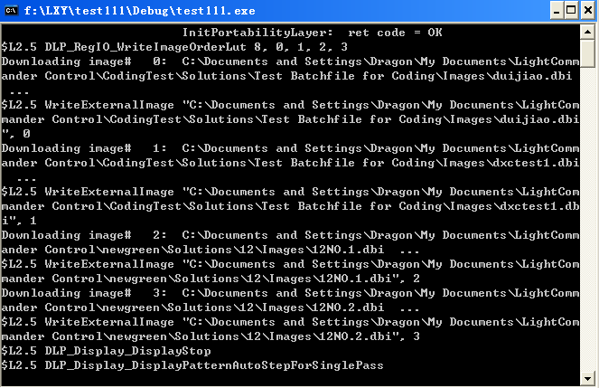

  • Hi Diao,
    Your code looks proper to me.
    Can you also send us the log file when you run this code? I am interested to see where it is failing... Is it always failing at DLP_Display_DisplayPatternAutoStepForSinglePass() call?
    There are many printf statemenent with ERROR running.... so having a log when the failure happens definately helps.
    Also provide more info on, exposure time, number of patterns, pattern bit-depth etc...
    Sanjeev

    the number of patterns is 4, pattern bit-depth is 8,exposure time is 16000us, the log is also inserted.
    thank you~~
    -diao

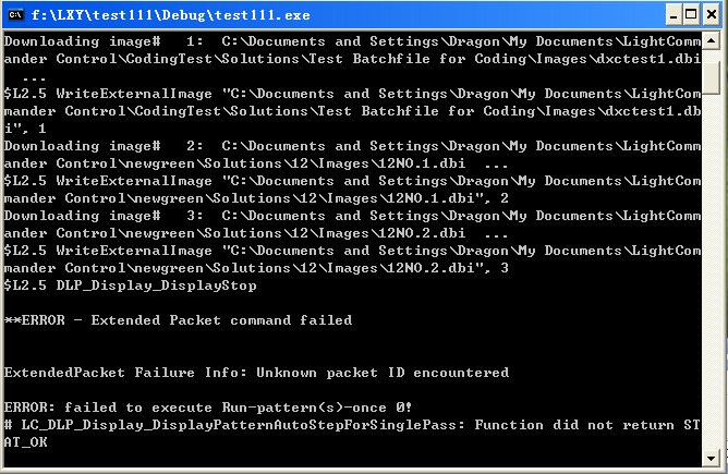

  • Hi Sanjeev
    we have been working on it , but the problem still not sloved
    there is no error occured ,
    but the display stops at the first image (without single pass pattern before it, only one image )
    can you help us?
    Thank you ~~
    -diao

    and , we encountered errors
    thank you !
    -diao
  • Hi Diao,
    It is evident that your MCU firmware is not upgraded to the latest.
    Goto this link and download the MCU firmware from here http://www.ti.com/tool/dlpr200 DLPR200F.
    Then download and install the firmware on your machine. Then using LC GUI tool update the firmware via Tools->Update Master Controller Program Memory ... Alt+C option.
    After upgrading power down and power the system. Read the system status via Help->About LightCommander Control and verify the MCU version is 2.1.6
    Now try to run your application it should work.
    Sanjeev
