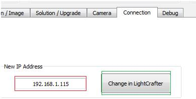

    1. Connect ‘first’ device to your PC using GUI. Change the IP address in the “Connection” tab, click on ‘Change in LightCrafter’ button and wait until the command is successful.

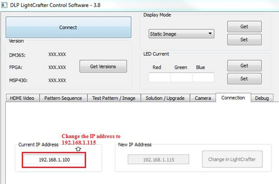

    2. Power cycle the LightCrafter. Before clicking on ‘Connect’, change the Current IP address to reflect the new value.
    To connect to the GUI, manually change the “Current IP Address” value to 192.168.1.115.
    3. Now, click on ‘Connect’ and you should be able to establish a connection with the device.
    4. For the second device, repeat steps 1, 2 and 3 but make sure the IP address last subnet is 2 numbers higher or lower than the previous one.
    In the above case, since 192.168.1.115 has been assigned to the LightCrafter, the virtual IP on the PC would be 192.168.1.114.

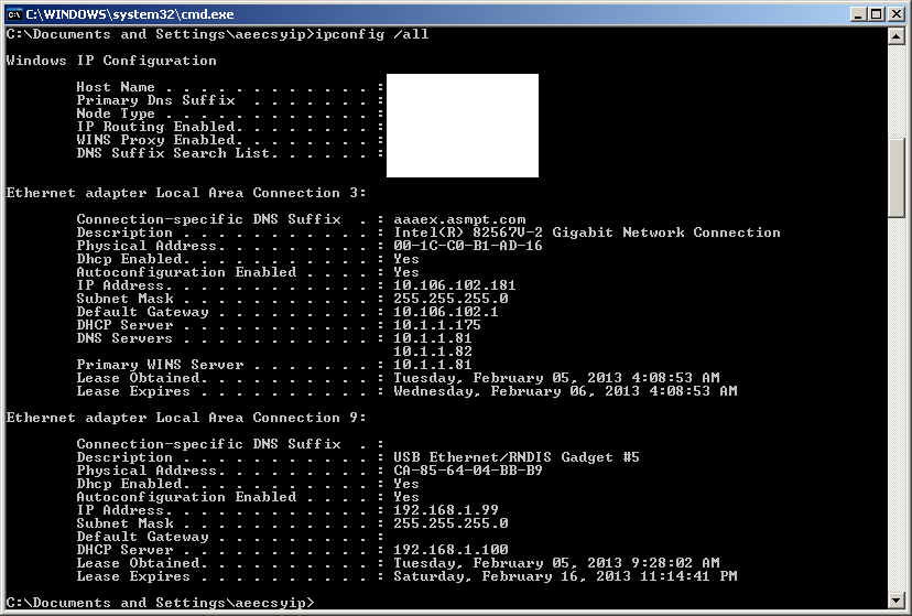

  • Hi Cheung Ka Yan,
    Can you please post your ipconfig log and GUI settings. This will help in debugging the issue.
    Divya

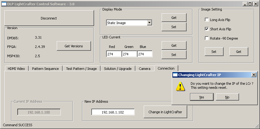

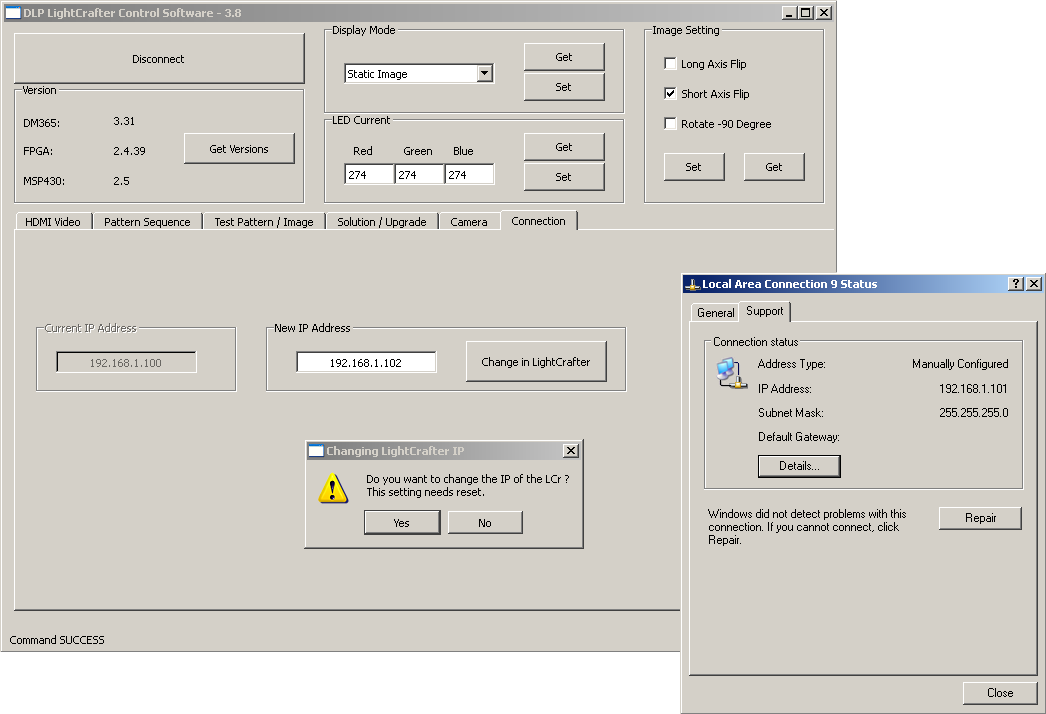

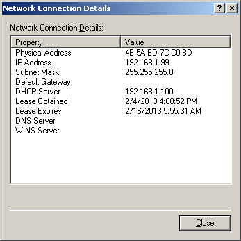

  • Hi Divya, Sorry for the inconvenience!
     Origin state
     Change IP
    REBOOT the device
     Cannot connect using the configured address...
    ...but the original one.
     The DHCP service address from device remains the same.

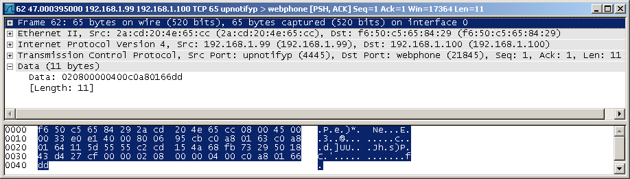

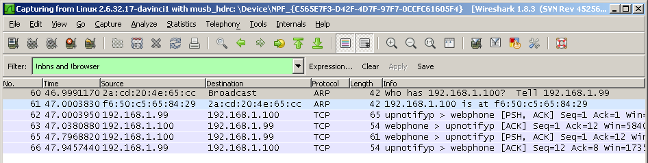

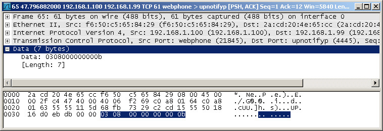

     Grabbed packets during configuring.
     COMMAND packet
     COMMAND REPLY packet

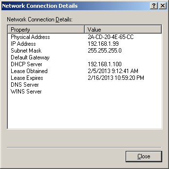

     All ip config
    Please help to judge. Thank you!

  • Hi Cheung,
    Can you please try one more thing,
    Before assigning 'New IP Address' in the GUI, change the IP address in the Network connections as follows,
    • Go to Network Connections. Right click on the new LAN connection, and choose "Properties"
    • In the box "This connection uses the following items" under the Networking tab, look for “Internet Protocol Version 4”. Highlight by clicking on it, and then click “Properties” underneath the box.
    •  Choose "Use the following IP address" and enter the address and subnet mask you would like to assign (192.168.1.101). Power-cycle the LightCrafter.
    Now, change the IP address (192.168.1.102) in GUI and see if you are able to connect. Please let me know of your findings.
    Divya

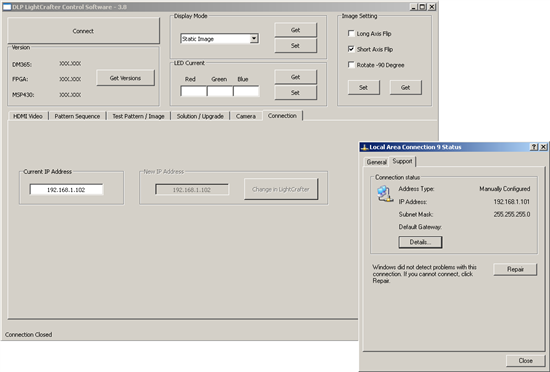

  • Hi Divya:
    Happy Lunar New Year! Thanks for the reply!
    We've tried the method and it doesn't work.
    Here are the screen captures:
  • Hi Cheung Ka Yan,
    Thank you and I wish you a very Happy Lunar New Year :)
    I wonder why the DHCP server address is not changing for this LightCrafter. The DM365 command sets this value and I request you to reload the DM365 build booting from NAND and try connecting.
    Divya

    But the operation of modifying IP address is still not working. The phenomenon is identical with the one before.
    And actually we have tried to re-upgrade all firmwares before but it doesn't work.
    Does this possibly show the existence of a hardware defect?
