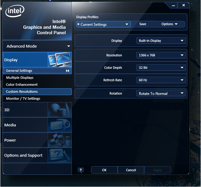

1) Can I drive the Pico 2.0 at all from Windows 7?  I tried connecting the HDMI through a MiniDisplayPort connector to my laptop, but I can't set my resolution to 640x480, so can't send a signal to the Pico. Should I eventually be able to send a suitable signal, or I just shouldn't be trying from Win7?

    1) The ability to drive the Pico 2.0 from Win 7 depends on your video card. You may have to go into the graphics control panel (right click in an empty space in the desktop, choose "Graphics Properties", select "Advanced"). Then go to "Custom Resolutions".
    The results will depend upon the capabilities of your graphics card.

  • 1) Thanks for pointing me at the right control panel. After unplugging my VGA monitor and having only the HDMI connection, I was able to get it running from Win7 at 640x480. Should I expect to be able to drive it at native 480x320, or the default mode at boot up only supports 640x480 with resampling?

    1) Great! No, you should not use 480x320 in video mode. 640x480 is the video mode. There is a way to have the Pico Kit display only the HVGA, but it is "zoomed" from a 640x480 input. See the app note: http://www.ti.com/lit/an/dlpa021a/dlpa021a.pdf Using the DLP Pico 2.0 Kit for Structured Light Applications.
