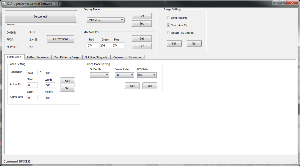

    Please make sure that the LightCrafter settings look like this:
    Notice that the "Active Pix" and "Active Line" must be set to 608 and 684, as well as set in the "Resolution" box.
    Remember that the "Set" button has to be pressed after each change.

    Well - first connect power and USB to the LightCrafter, allow it to boot up to the static pattern - usually the vertical colored bars.
    After a 90 second or so delay, connect to it using the GUI. Make sure that the "Version" info loads.
    Under "Display Mode" click on the button and select "HDMI video" and then click set. The bottom panel shifts to the HDMI video tab.
    Verify, or enter the "Resolution" 608x684 and click set. Then click "Get". If the "Active Pix" and "Active Line" boxes do not show 0, 606 and 0, 684 respectively, then enter those values in the appropriate boxes and click "Set". Then click "Get" again to make sure that they are set.
    Set "Video Mode Setting" check the settings ("Get"), or enter the following: "Bit Depth" 8, "Frame Rate" 60, and "LED Select" to RGB. Again, hit "Set" then "Get" to verify.
    Now, connect your HDMI video input - which should be set also to 608x684 60 Hz.
    You should see the video displayed by the projector. Depending on what your source image is, it will probably be stretched or compressed by the 608x684 diamond array geometry. But it should be clear and steady, and you shouldn't see other static or shimmering artifacts. The input image should fill the whole array.
