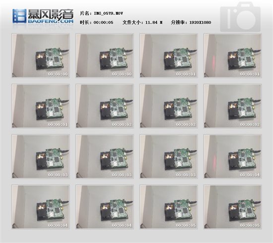

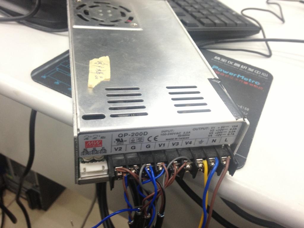

  • Hi Pascal,
    I had contact the distributor, and he instructed me to do some test, however it is still not work. The projection light (RED) is flashing intermittently. I am sure the power input is DC 5V and sufficient for requirement of 2~3A.
    Some picture were attached as follows:
    Bokai
  • Bokai,
    We have had reports from some customers who used power supplies which seemed adequate, but were unable to respond to the rapid current demand changes in the LightCrafter during boot-up. This was surprising, but we have had it confirmed by several people. Could you possibly try another power supply. We have had great success with small, 5V 2.5A plugin switching power supplies (wall wart type). You may find that a simpler supply does the trick.
    If that still doesn't work, I suggest you go back to your point of purchase and tell them it still doesn't work.
