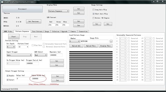

    #3. Are you not seeing the trigger pulse at all? Please set non-zero pulse width and verify if it helps. For example- Set Output Trigger Pulse Width to 10uSec.
    Sanjeev

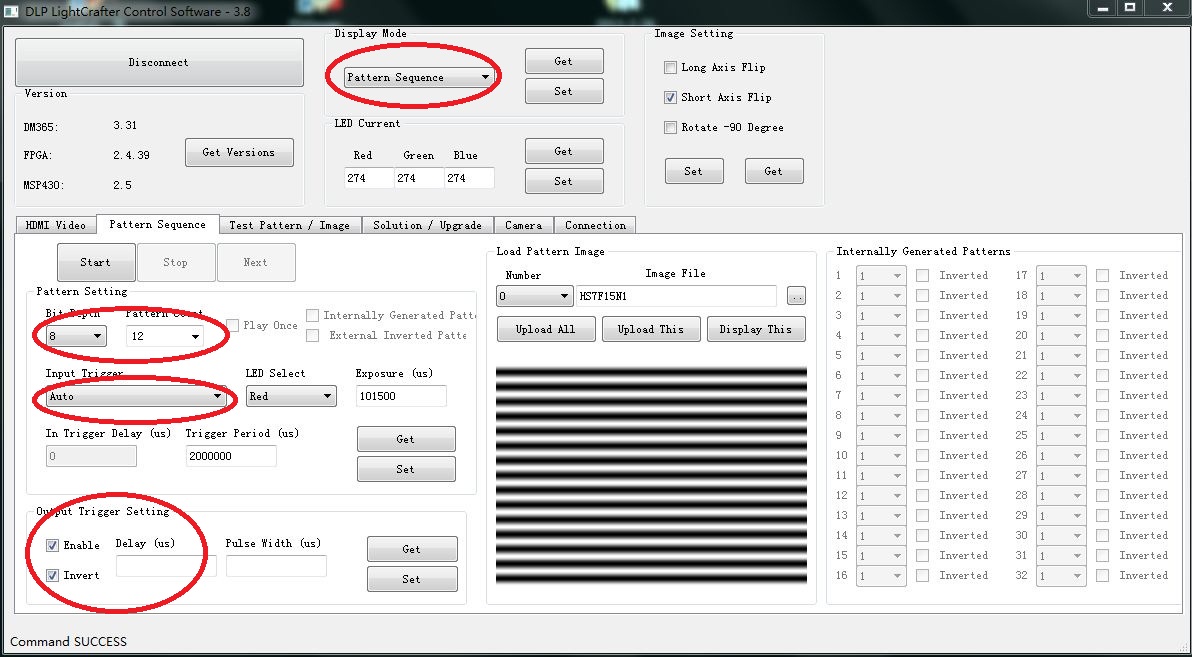

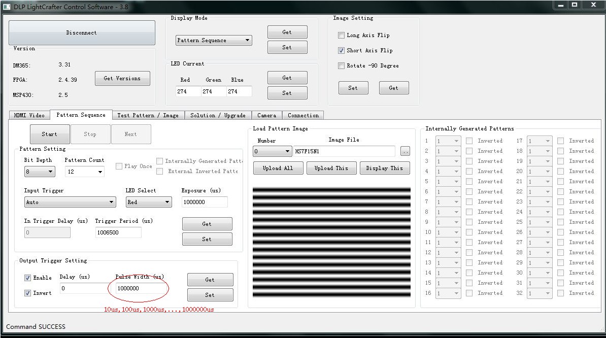

  • Hello Sanjeev,
    Thank you for your reply. I set the trigger pulse(10us,100us,1000us,...,1000000us), but it can't  work.
    #1.This is the LightCrafter's settings. As follow:

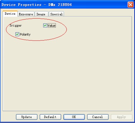

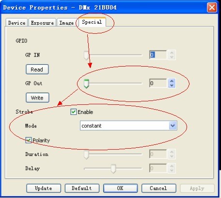

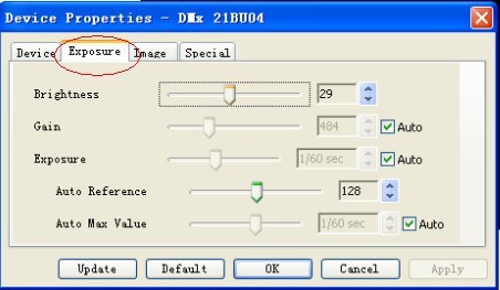

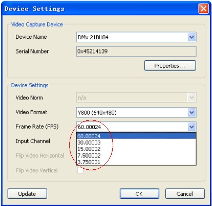

    #2.The camera's settings:
    (1)frames rate: 60.00024
    (2) Device trigger : value and polarity
    (3) Exposure :
    (4) Special:

  • Hello Lou Jin,
    #1. OK.
    #2. (3) Exposure picture - You may want to disable Auto functionality. By enabling this you end up reading the modified pixel data on the camera as it starts dynamically adjusting the gain of image.

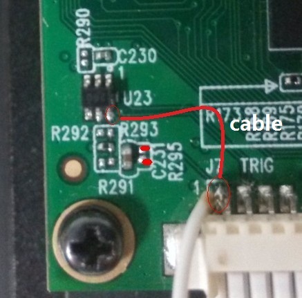

  • Hi Sanjeev,
    I really  appreciate your help. And I refered to the thread above. But I understand a little.
    # 1. How to remove R292 on the board? I do this as follow:
    It is detached from the system board.
    # 2. How to  install 0Ohm at R291. I use a cable to connect two pin on R291. See :
    # 3. Above all , right ? If not, what's right?
    # 4. I have a idea that I make a voltage  amplifier, and place it between the camera and J7. Is it available?
    Lou Jin
  • Hello Lou Jin,
    #2 instead of connecting cable you could have used the same 0Ohm resistor you removed from R292.
    #3. Your changes look proper to me.
    Before going to option #4 I would suggest to test just with #1 and #2 changes.
    Sanjeev

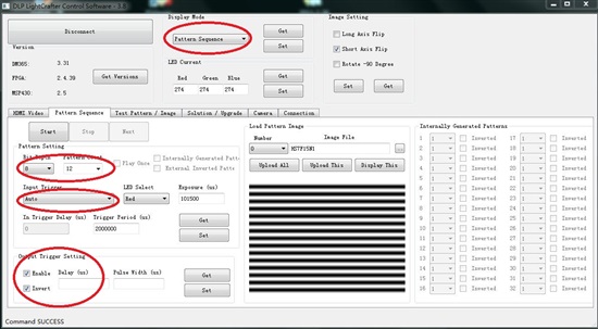

  • Hi Sanjeev,
    I still have some questions. Last night I did my experiment. I found no signal between Pin 1 and Pin 3. No signal! But Pin 2 and Pin 4 is 3.3 Voltage. I have no head.
    DLP LightCrafter Control SoftWare's settings :
    (if the settings is right)

  • Hello Sanjeev,
    Recently, I'm busy doing something else. Last yesterday, I took it to a PCB board shop. And they used a cable instead of the 0 ohm resistor. They didn't install the cable at R295(two red points), but see figure(two red circles):
    # 1. Is this logical?
    # 2. I test its voltage, if other settings have done, and the result is 3.3V, 0V, -3.3V. They are volatile. I deduce that above the way  is right. Your outlook?
    Lou Jin
  • Hello Lou Jin,
    Looks OK to me as well.
    Sanjeev

  • Bing,
    The trig_out_con signal on pin 3 of J7 is an open drain connection. That is, it cannot source current, but it can sink current. The correct way to create a 5V trigger is to place zero-ohm jumpers in place of R295 and R291. R292 and R293 should remain open (no zero-ohm jumper). This will place 5V on ext_trig_VCC, pin 1 of J7. Then, to your camera, connect pin 1 of J7 to the trigger input pin, and connect pin 3 of J7 to the camera trigger ground. The ground pins 4, 5, and 6 of J7 should not be connected to the camera.
    Do not connect J7 Vcc pin to pin 6 of U23, except by inserting the zero ohm jumper R295.
