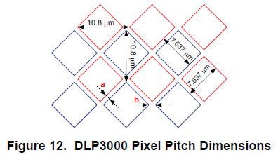

I have some questions about DSP3000 and DLP LightCrafter. Could you let me know?
 - How long is the clearance between the micromirror and a next micromirror on DLP3000 ?

  • Hello RY,
    [Sanjeev--updated] The nominal distance between micromirrors is 1um.

  • Sanjeev-san,
    Thank you so much for your answer.
    Sanjeev said:
    [Sanjeev] 0.5uM
    I am sorry that my question was not clear.
    Your answer means the length (a) rather than length (b). Is that right?
  • Hi RY9983,
    Yes the 0.5uM is for 'a'.
