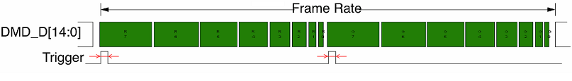

    Is the OUTPUT_TRIGGER pulse width variable?
    I would like to know the pulse width of 8-bit Monochrome External Video case.

  • Hello Rossinag,
    As I mentioned earlier the output trigger pulse is fixed when it it used without FPGA and DM365.
    The pulse width can be determined using below formula.
    Monochrome External Video Case:
    For bit-depths between 1 through 7  OutputTrigger pulse width (in uSec) = ( 1/frame_rate ) * (1 / (floor)(24/pattern_bit_depth) ) * 10^6
    For bit-depth 8                                          OutputTrigger pulse width (in uSec) = ( 1/frame_rate ) * (1 /  ( (24/8) -1) ) * 10^6
    Example:
    1bpp patterns at 60Hz in the Monochrome External video case will be (1/60) * (1/ (24/1)) * 10^6 = 694.44uSec the actual measured value on the photo detector would be close to ~670uSec this is because in the formula above we have not considered other overhead timings it will be between 2 to 3% of the actual value.
    Similarly applying the same math for 2bpp patterns @ 60Hz from the formula it will be 1388uSec again the actual measure value will be 1349uSec
    In case of 8bpp @ 60Hz the pulse width according to formula it is 8333uSec actual measured value will be around 8148.45uSec
    You can use the above formula to approximately find the output trigger pulse width value for other bit depth patterns.
    Let me know if anything not clear.
    Sanjeev

    I understand that the dlpc300's "OUTPUT_TRIGGER" signal will be asserting while a pattern image exists on the DMD.
    So , in the 8 bit monochrome case, the 8 bit planes will be displaying while the "OUTPUT_TRIGGER" is asserted.
    If I am misunderstanding please let me know.
    Thank you and best regards,
    Rossinag
  • Hello Rossinag,
    Your understanding is correct.
    Sanjeev
