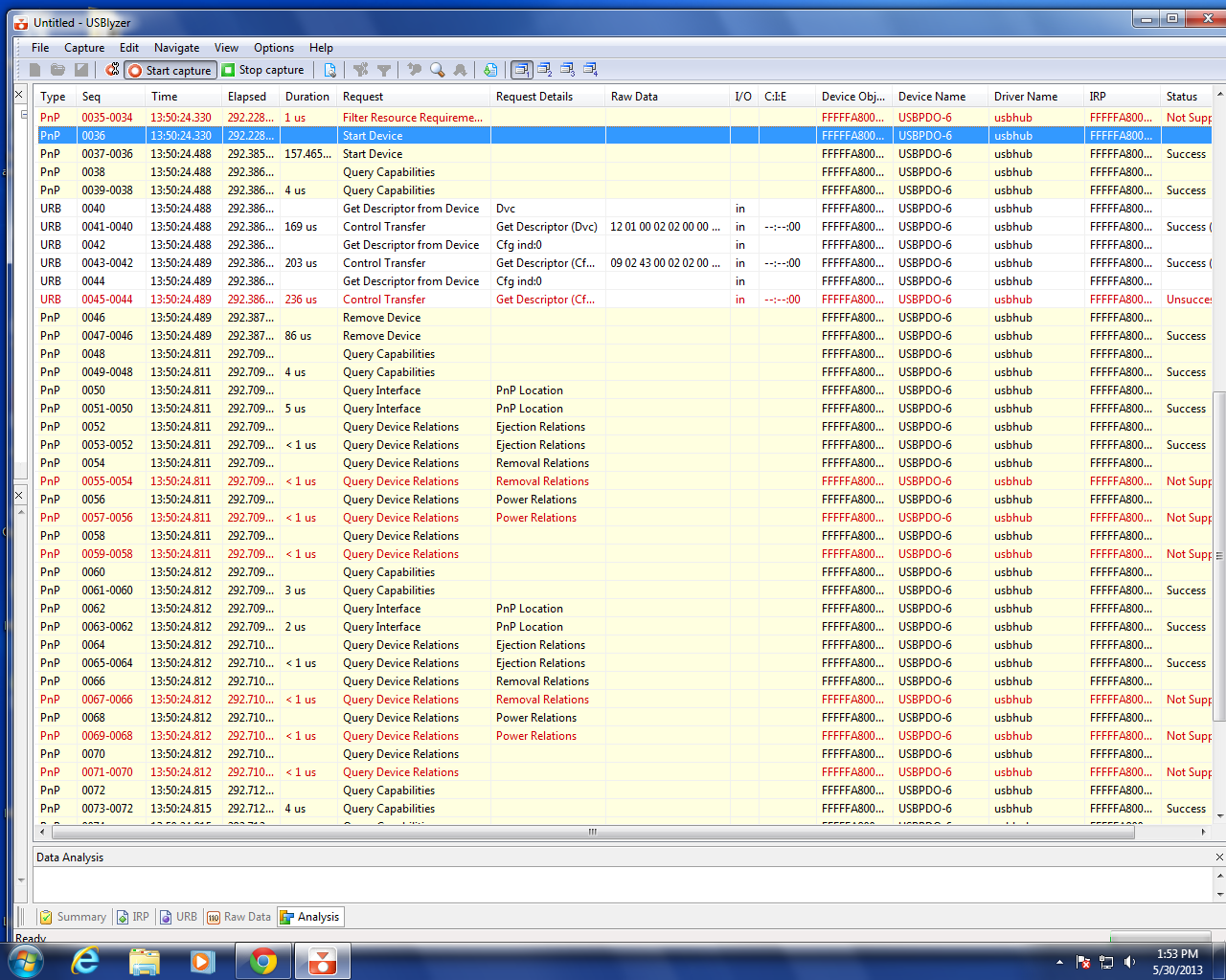

    Seems that LightCrafter is not able to enumerate properly. Can you please load a USB Traffic Sniffer tool to see the USB transactions and post that back. Here are a couple:
    http://www.usblyzer.com/download.htm
    http://desowin.org/usbpcap/
      Pedro
  • Pedro,
    I ran USBlyzer while attempting to update the driver and this is what showed up
    This may not be very useful to you; is there something specific you need from the output?
  • I will attempt the firmware update first thing next week; do you think this might solve the problem?
  • Scott,
    The screen capture shows that it failed to enumerate. It could not get the full descriptor information. I would suggest to try to reflash the DM365 firmware since it is not able to complete the first part of USB enumeration. Try also booting from SD card with the DM365 firmware, as well as, reflashing NAND.
      Pedro
