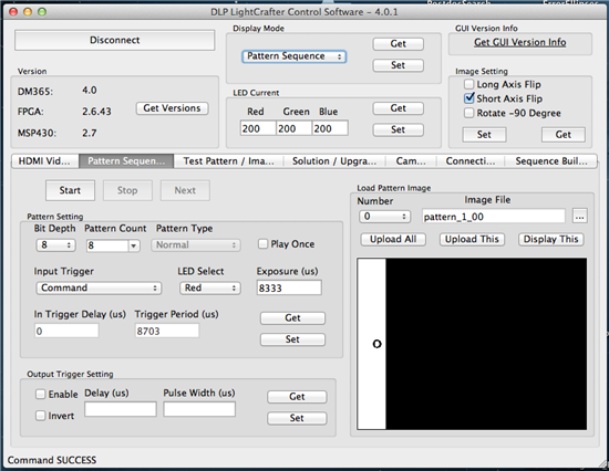

  • Here is a screen shot of my Pattern Sequence settings. When I press "Start" I get "Command FAILED"
    I have not made any hardware modifications.
    -Greg
  • Hi Greg,
    The pattern settings look good to me. Can you check few more things,
    1. Do you have a 2.0 red sticker on LightCrafter's thermal plate?
    2. Can you check if  R205 (below the DM365 on systems board) installed on your board? This is for extended pattern sequence mode. The v2.0 boards should have the resistor installed by default.
    3. In your settings, can you change the "number" from 0-7 and see if the images are displayed correctly in the preview pane. Sorry for several questions, but I am trying to see if its a hardware/ firmware issue.
    Divya
