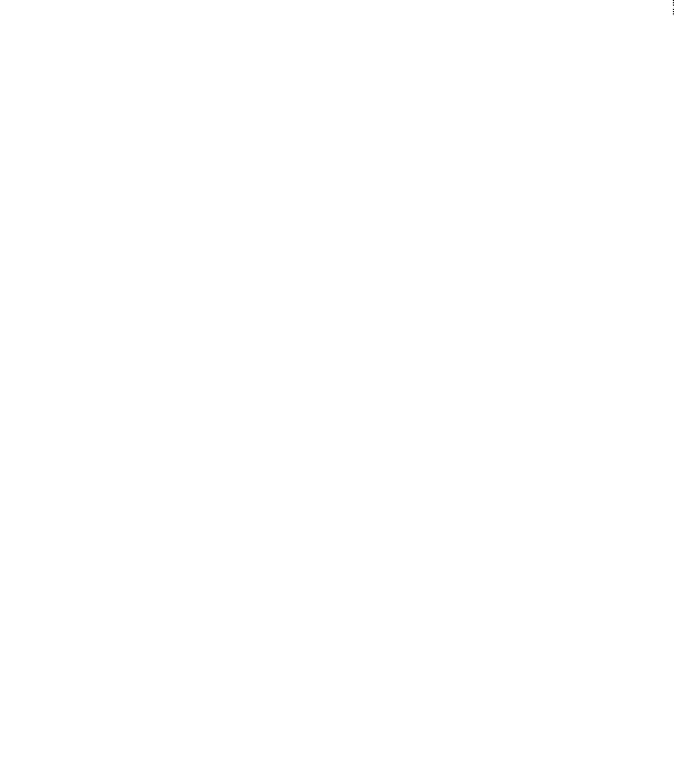

66? is this the number of the frame? There is only one frame, why is this 66? (See image below for what I uploaded)
Can you help me interpret this packet from the 78 onwards?

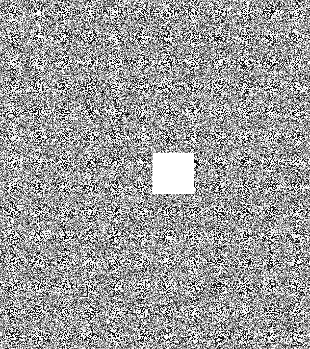

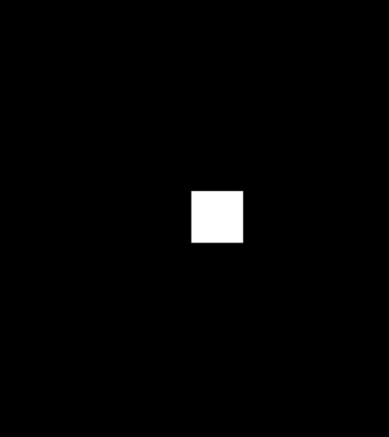

Below is the image I sent it. 608x684. Two sets of 3 dots, at the right hand corner of the image. Each dot is 1pix in size and within a group of 3 is 1pix apart. **I realize that these will get jumbled as the image is remapped from rectilinear coordinates to the Diamond pixel array, but for the purposes of the packet this doesn't matter**

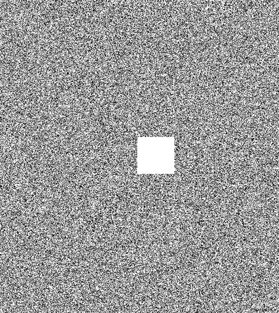

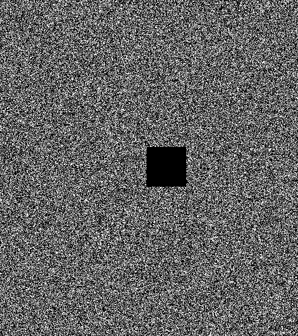

  • alright I'm making some progress. I've asked the LCr for as many bytes as are available. I've examined the host read response for 3 different kinds of images that I've attached at the bottom of this post. Immediately below are the read responses from the LCR. Each column is the response for 3 different images. I understand the first 6 bytes of the packet. The next 62 are identical for all 3 images, even though the image data for them is quite different. Flag is 0 so I assume that all the image data is in this packet. The last 444 bytes are different for all three, suggesting that these are image data. Consistent with this the sum of column 2 and 3 at row 70 and greater is 255 - given that 2 and 3 are just inverts of one another I expect this.  I still have problems figuring out how 444 corresponds to 608x684. There is no round multiple that will get me from 444 to 415872.
    How are these 444 values respresenting the images below the chart? They are attached in column order.
    Please Folks, any help would be great
    b&w b&w with noise B&W&noise with invert

  • Hello Arjun,
    Here are the answers to your queries -
    #1.
    As per DLP LightCrafter DM365 Command Interface Guide http://www.ti.com/lit/ug/dlpu007c/dlpu007c.pdf refer to two sections, Section #2, packet structure, and section 3.11 Pattern Definition (04 01) Table 14 and Table15.
    #2.
    The read command response to Pattern Definition (04 01) actually returns the pattern data in the BMP file format. That is why you are seeing the BMP file header has the same data. Now in the payload first byte BYTE0 has the pattern-number between 0 to 95. The bytes following BYTE#0 until the last byte contains the data for the BMP file.
    In short -
    6 - bytes ..... Packet Header
    7th - byte ..... Pattern number <0-95> 1st byte of the BMP file
    8th - byte ..... 1st byte of the BMP file  2nd byte of the BMP file
    (N-1)th - byte ..... last byte of the BMP file
    Nth - byte.....checksum byte
    #3.
    You can copy the contents of the BMP file from the response then save it as BMP file on the PC. Now you can open the saved file to see the contents.
    #4.
    While sending the pattern data you must send the entire BMP file content.
    Sanjeev

  • Hi Arjun,
    Here are the responses.
    Since, the used image is of 1bpp (1bit-per-pixel) format, what you calculated is correct. Each byte occupies 8-pixels information.
    #1. It is a mistake, have updated the post, the response does NOT carry the PatternNumber information. The BMP file information starts with the BMP signature, in this case it is a two byte header, with ASCII names 'M' and 'B'. 'M' is put in the MSB byte and 'B' is for the LSB byte. So ASCII value of 'B' = 66.
    #3. Is it simple, just create a binary file with <name>.bmp. Now from the response packet, copy the binary data from 7th byte until the (last-1) byte, last byte is for check-sum.
    #4. You mean, you are sending, the BMP file read-back back to the LCr in the write pattern definition command packet? If so, sure,  it should work unless there is mistake in copying the response BMP file contents.
    Sanjeev
