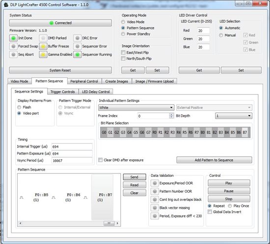

    You must create a pattern sequence for the LightCrafter 4500 to display 1bpp images from the video port. Could you send me a screenshot of your settings from when you tried to create a pattern sequence?
    Blair
  • Here are my current settings:
    I've also noticed that if I hit "Send", I get no errors, but if I follow it by hitting "Read", it loses my settings and switches back to "Flash->Internal/External"

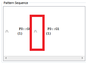

  • Thank you Aaron. I believe your problem with displaying the sequence is that you did not remove the external trigger (the VSYNC signal from the HDMI) before the patterns following your first pattern. Before each pattern (except for the first one), right-click on the trigger icon....
    ...and select "Remove Trigger-In". Do not remove the trigger before the first pattern though.
    I will need to look into the "Read" problem you're seeing. Thank you for notifying us. Let me know if you need any more help and if what I've suggested solves your problem.

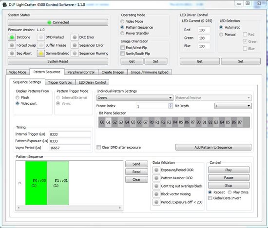

  • I've tried a number of things, and still can't get the 4500 to display 1440/2880fps sequences over HDMI. To isolate the problem, I've removed as much complexity as possible. I'm now creating the same video sequence I was sending before to get a 1440fps sequence (60Hz X 24 bitplanes @ 1 bit per pixel) to the previous LightCrafter; however, I'm only displaying a two-frame sequence; I've attached a snapshot of my setup below:
    With these settings, I'm seeing a number of problems that look like bugs, but may be related to the reason why this isn't working for me:
    1) With these settings, If I hit "Send" and then later hit "Read" (under Pattern Sequence in the lower left), it switches back to "Display Patterns from: Flash", which is incorrect - Nothing should change. If I then switch it back to "Display Patterns from: Video Port", I have to re-create the Pattern Sequence.
    2) If I only set two bitplanes in the video sequence (G0 and G1 in the case above), I see clear cross-talk between the bitplanes. For example, if the first and second bitplanes contain overlapping solid rectangles, the region of overlap is inverted (off).
    3) If I set more than the two bitplanes in the video stream, I see even more crosstalk, even if I'm only referencing a subset of bitplanes in the pattern sequences as in the case above; the other bitplanes are being presented as well, and a high-speed camera shows that two frames are being presented in the timing I'd expect, but the pixels illuminated are a jumble of pixels from the other bitplanes. If I didn't know better, I'd assume the light engine's logic is stepping in and complicating things rather than presenting each of the bitplanes as its own one-bit image during its frame.
    4) I see a significant chunk of noise at the bottom of the screen. I suspect it's the difference between the 1280x800 resolution detected by Windows and the 912x1140 mirror array, as it appears to cut of right around 800 pixels down the screen.
    On a side note, does anyone know what the "Frame Index" does for patterns displayed via the video port? I've tried both leaving it zero and incrementing it per-frame, but have had no luck with either, and the documentation gives no insight into what it means.
    In conclusion, has anyone managed to get high-framerate (1440/2880fps) sequences running via HDMI on the LightCrafter 4500? It's the sole purpose we bought the device for, but so far it's been a huge time sink. Any help would be greatly appreciated.

  • First, let me answer your questions: 1) I've got the device in 24-bit 912x1140 at 60Hz running from a PC via HDMI, and the "Buffer Freeze" icon is greyed out (as it is in the screenshot I posted above). Yes, I'm using a PC to stream at 60Hz; Currently, I'm sending it two bitplanes (G0 and G1) in a 24-bit bitmap at 60Hz. I've got Internal Trigger and Pattern Exposure set to 8000us, with Vsync at 16667us, and "Clear DMD after exposure" set on the second frame; that should produce a 120Hz image from the two bitplanes.
    Bitplane G0 contains a rectangle starting at x,y position 330, 700, and 100 pixels in width and height. Bitplane G1 contains an identically sized rectangle at a 20 pixel offset to positions 350, 720. I would expect to see the two rectangles in dark green, with a brighter area in the 80x80 pixel section where they overlap. Instead, the overlap area is pitch black. If I film with a high-speed camera, here's what I see:
    * 8ms - Bitplane G0 (minus the area where it overlaps with the rectangle in G1 as described above)
    * 8ms - Bitplane G1 (minus the area where it overlaps with the rectangle in G0 as described above)
    (repeat)
    So as long as I have enough time to clear DMD after exposure (that one bit me when I was running 8333 rather than 8000us with a 16667us), I get a 120Hz sequence. However, the bitplanes are clearly interacting here. If I have overlapping data in other bitplanes (G3, G4, for instance), subsets of the other planes get jumbled in the two frames (G0 and G1) that do get rendered.

  • Hi Aaron,
    We created several sequences that had overlapping data and we did not see the strange behavior you've described. However, when we tried the HDMI output from our PC's we did not get pixel/bit accurate images and saw very strange results even when the resolution was correct.
    Could you send me the image you're using? I will test it to see if I get the same results you've been seeing.
    Blair
  • Ah - That's it!
    For the sake of anyone else who comes across the thread, this last bug was on us. I sent a snapshot from our video stream to Blair via email, who reproduced the issue and confirmed that the pixel values were not as expected. As it turns out, one of our engineers had swapped our back buffer format to SRGB, which was causing our color values to be bit-incorrect, causing what looked like bitplane cross-talk.
