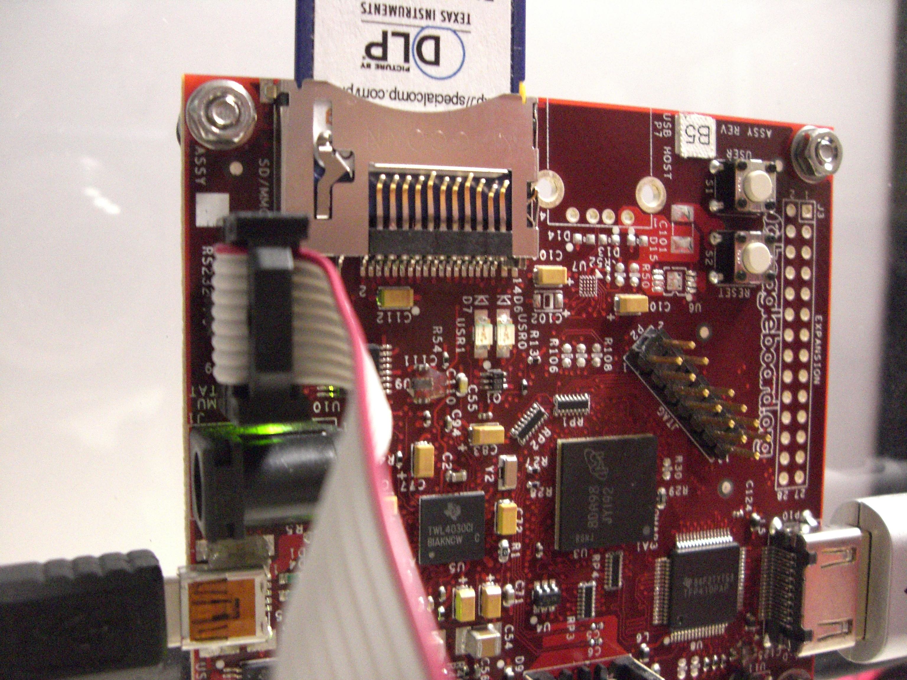

  • Takashi,
    I would recommend that you connect the Pico to a BeagleBoard and start from there to begin communicating to the Pico. You can do this by following the instructions below:
    1. Connect Pico2.0 to the Beagle board using the HDMI cable
    2. Connect the 10-pin end of serial cable to Beagle board with Pin 1 on top (connector DB9 Male to 10 Pin Header) (see image)
    3. Connect the serial end (DB9) of the cable to the serial input of the PC
    4. Plug in the configured SD card (Configuration instructions on http://beagleboard.org/pico)
    5. Plug in power to Pico2.0
    6. Connect the Beagle board to PC using USB cable
    I would also like to recommend that you go to the BeagleBoard site (http://beagleboard.org/) to get more information on how to use the BeagleBoard. Here is an example of what the command looks like when sending to the Pico:
    - From Tera Term use bus3-i2c at a prompt:
      root@beagleboard:~#bus3-i2c 0x1b wb4 0x04 0x00000001
      0x04: Is the command to change input source
      0x00000001: Is the value that set the input source to test patterns
  • I have a Pico V2 and a BeagleBoard rev C4 that I would like to use for structured lighting. I have followed your instructions for connecting the Pico to the BeagleBoard but have not had success. Do you know if this SD configuration works with the C4 BeagleBoard? I was going to order a preconfigured SD card from Special Computing, but they did not think it would work with the rev C4 BeagleBoard. Any suggestions?

  • Just thought I post a pic of the setup I'm currently using which may help others. I have a USB-I2C interface (lower left) from Dimax which connects to my laptop. I have a prototyping SMT board (upper left) from Schmartboard with a soldered FFC connector. The FFC cable is then routed to the DLP Pico (which is uncased).
    Matthew Leone
