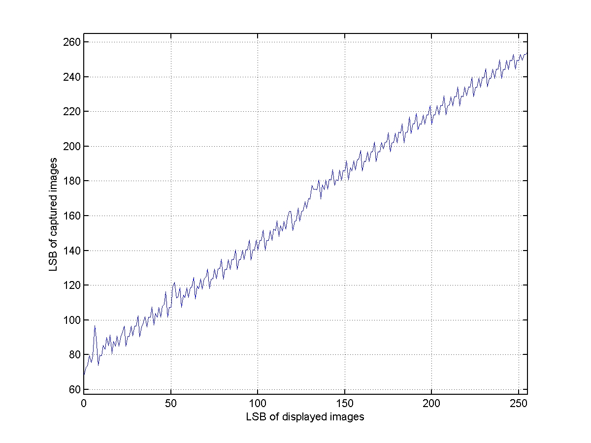

I'm using DLP5500 with X3 board from Keynote Photonics. My application is to generate structured light with the DMD and laser, so I use a fixed-on illuminator. When I use 8bit gray patterns, the output intensity is not linear to the input images. The vendor said this is because the DMD makes the LSBs with both turning on/off mirrors as well as controlling illuminators, so some LSBs do not have linear relationship to the input images when I use a fixed-on illuminators.
Is this issue limited to specific vendors or entire family of DMDs? If the all DMDs have same issue, is there any way to obtain linear and smooth response for 8bit gray images with a fixed-on illuminators?
I attached a graph that I measured the DMD intensities when I display 256 steps of gray levels.

  • Hello Yun-Ho,
    The issue is not specific to the vendors. The DLP display sequence are designed in this way for the LightCommander chipset, in short you will find this behavior common to DLP5500 (i.e., DLPC200 + DLP5500) chipset alone. For the fixed illumination we need to modify the sequences of the DLP5500 chipset. This is going to be new requirement and a development effort.

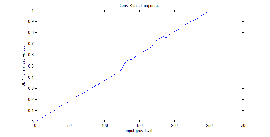

    I have a similar issue. I've  connected the DMD (DLP 5500) to a Lumencore solid state light engine (multiple LEDS) and find that the intensity reponspe of hte DMD for 8 bit gray images from 0-256 in steps of 4 cannot easily be inferred to be linear nor non-linear: I see a small S_shape but the small elevation after shade 124 can easily be due to experimental errors. Can you please take a look at the response curve I have attached tell me based on your experience whether the DLP is non linear or linear. I have used the software in static buffer mode so no video processing.

  • Hello Mira,
    Welcome to the DLP section of the TI-E2E Community.
    I suspect that the characteristics of the Lumencore engine are a little different than the Rapcur LED driver and/or the PhlatLight PT54 series LED's used with the LightCommander.
    It is a little difficult to tell from just the picture if this is within your measurement error or not. It could also depend on your measurement methodology.  Without knowing your set up it is difficult to tell.

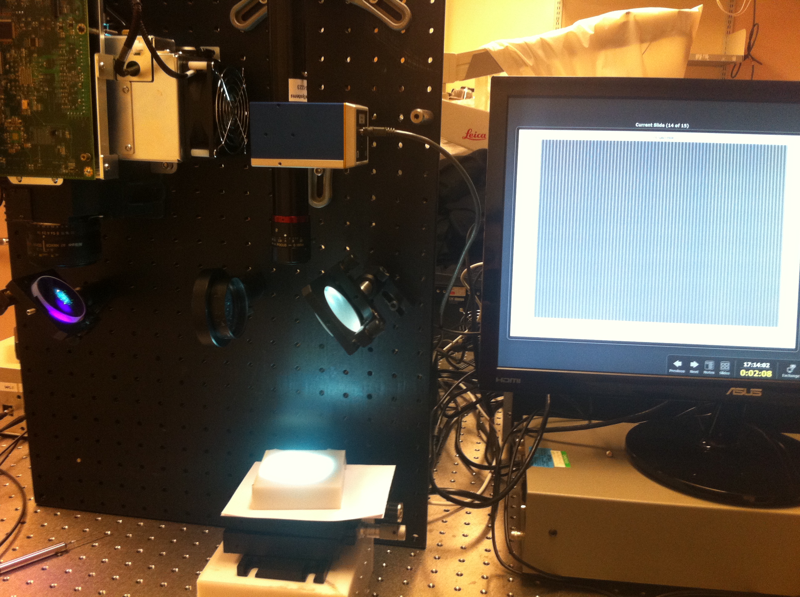

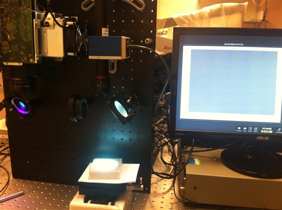

    My setup looks like the image attached.
