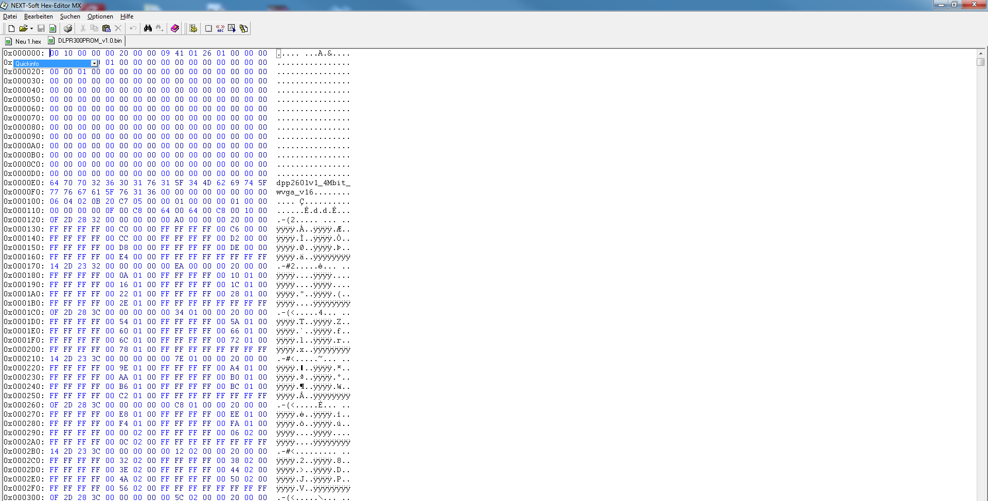

    Can you pls. disclose the data structure of the Flash SPI, i.e. how should the data be organized in the PROM.

  • Hi, thanks for your answer. We want to change the splash screen for our own design (no lightcrafter hardware). In order to do this we need to known where to put the image (i.e. at which address does the image start and what size does it have). if we look at the data of DLPR300PROM_v1.0, where does the image start? Is there a description of address blocks, image sizes etc?

    Here is the utility with readme you can download from http://www.ti.com/tool/dlpr300 look for DLPR300SPLASH:
    Splash Screen Utility for DLPR300 section. You can download from here.
    The readme allows you to update the splash screens with new ones.
