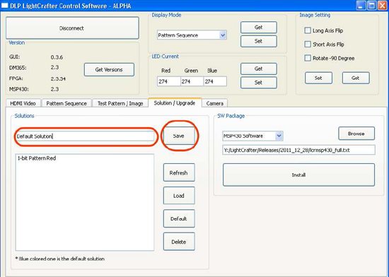

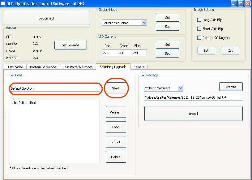

  • 1. Open the “LightCrafterGUIv3_8 .exe”, click on  Pattern Sequence tab, Set the appropriate settings such as LED Current, Pattern Sequence bit depth, number of patterns, input trigger, trigger period, exposure, time, display mode, etc.
    2. Click on Solution/Upgrade tab.
    3. Under Solutions box, enter a name and click “Save.”
    4. To manage stored solutions, use the following buttons:
    • Refresh: lists stored solutions
    • Load: load the currently selected solution
    • Default: sets the currently selected solution as the default solution when DLP® LightCrafter™
    boots.
    • Delete: erases the currently selected solution
    After you finish all the steps above, the lightcrafter will show the designed patter  sequence you have been set instead of showing the default static image when lightcrafter is booted next time.

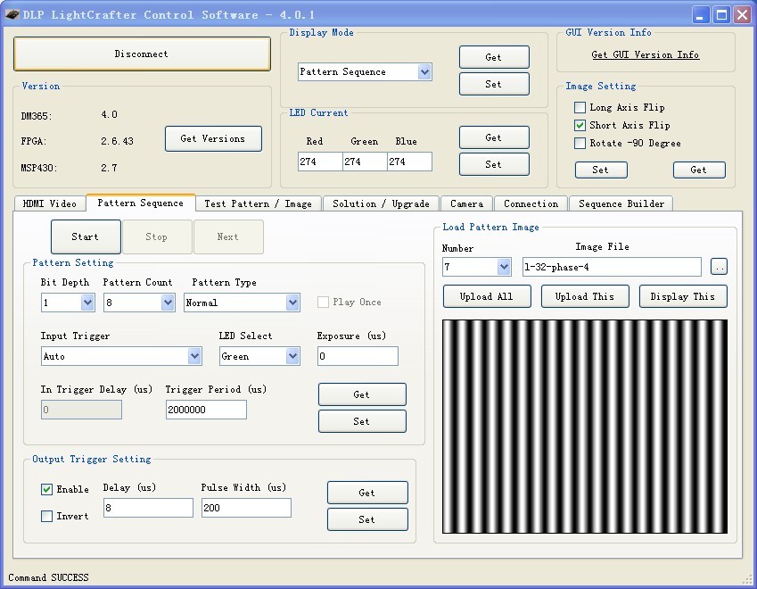

    i tried, the lightcrafter can enter "patter sequence mode"  when booted, but cann't show the image automatically. i need to press the "start" button on PC to start showing the patter sequences.
    i chooesed "auto" input trigger . it says"Auto:patterns displayed after end of TriggerPeriod" in the manual. But it didn't work.
    is a external trigger signal necessary?

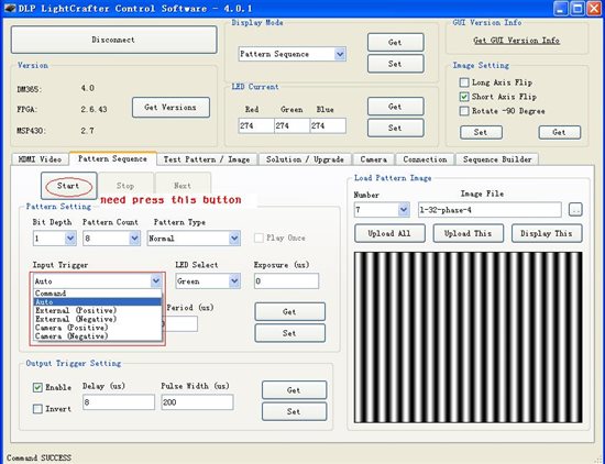

  • I tried again just now and I have found your problems.
    You should press the start button before you save the solution, because the solution saves not only the
    parameter you have set but also the commands you have given.
    try  it again, good luck !
  • hi:
    thanks very much!
    it worked!
