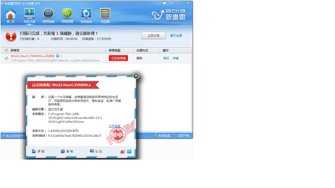

    1. Virus in LightCrafterGUI.exe of DLP3000 for Windows Bundle
    I downloaded DLP LR 3000 Bundle DLPLCr_FW_SW_v2.0.1_WIN_06_14_2013for Windows from your website. No Virus was detected at the time.
    Then I installed it on my computer and start to launch LightCrafterGUI.exe
    A KCloud virus  (a kind of Trojan house virus) was detected.
    The following is a screen shot of the KCloud virus information in Chinese.

  • The virus name is Win32.HeurC.KVM099.a.  please see the following screen shot for  virus information
  • I do not see the screenshot. However, we have checked the v2.0.1 package, and the LightCrafterGUI.exe, and we do not detect a virus.
    I can't say why you are detecting the virus. Did you use software to remove or isolate the virus? Did you remove the detected virus, then remove the LightCrafter software? Scan your computer to see if you find the virus. If not, then try reinstalling the LightCrafter v2.0.1 package, and the GUI. Do you see the virus again?

    1. Virus
    I scanned everything on my computer, no virus was detected except the one in LightCrafterGUI.exe file.
    I uninstalled your windows bundle and installed it many times. the same virus was detected. I isolated the LightCrafterGuI.exe, My virus protection software simple removed it from GUI folder. Although the virus was detected in the GUI application, I still launched it,  but I didn't have any luck to get USB connected.
    I also compiled your GUI source code with QT Creator. There is no virus in my generated LightCrafterGUI.exe. However, I still could not get USB connected.

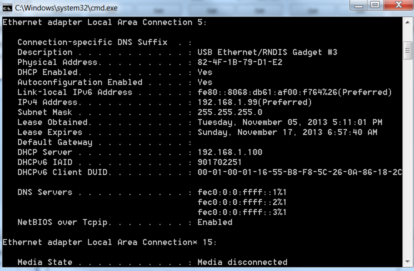

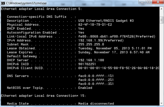

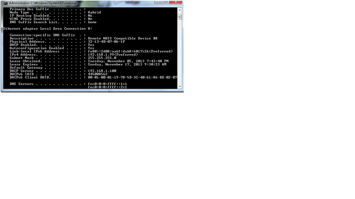

    1.  Make sure you have followed the steps in section 2.3 of the Users guide regarding " First time connection to the PC". Are you connecting to a Windows PC or Ubuntu PC?
    2. In the Light Crafter GUI, go to the Connections tab and check the current IP address. It should be 192.168.1.100 (default address of the Lightcrafter)
    3. Also open a command prompt and type "ipconfig/all". You should be able to see Local area connection for RNDIS Gadget. Verify that the IPv4 address is 1 less than the IP address of the device in the GUI. So the IPv4 address should be 192.168.1.99. Refer to the screenshot below:

    I tried many times to uninstall and install EVM windows bundle. I still had the virus issue in LightCrafter.exe, Can you email me that file to my personal email account?
    BTW, I pasted a screen shot of the virus. It seemed your server blocked it.

    In the LCR GUI, the IP address is 192.168.1.100.
    The result of ipconfig/all from my computer is shown below
    I am very frustrated with the issue. Can we use a teamviewer or skype to solve the problem together?

    the following is a screen shot of the virus I mentioned before. Please  read English part only  if you don't know Chinese.

    1.  I suspect that since your Virus scan is giving you a virus warning while extracting the GUI, it might be blocking some of the GUI USB support features and hence the USB connectivity issue. So I would recommend using the attached zipped folder that contains the QT libraries and GUI executable scanned and tested by me. Try to run the GUI executable from here and verify that it does not throw any Virus warnings.
    2. After you can successfully open that GUI, connect the Lightcrafter to your PC let it boot up successfully, wait for about a minute or two for it to be recognized as RNDIS device and then hit Connect on the GUI.
    3. If that still doesn't work, we need to make sure that the Windows Firewall is not blocking the communication to this network device.
    4. To ensure that, open a command prompt and hit this command:
      • ping 192.168.1.100    (IP address of the device)
      • See if you get reply back from the device
    If you are able to successfully execute these steps, and still have issues connecting to the lightcrafter over USB, then we would have to investigate deeper into this issue.

  • Manasi,
    It is strange, your zip was scanned with the virus. it may due to my virus scanning software is so sensitive.
    Anyway, I tried on other computer, no virus was found.  I also got usb connected only if I disabled my wireless connection.
    If I enabled wireless connection, I will get a connection error=7.

  • Min,
    I am glad it worked on other computer.
    And disabling the wireless connection for this USB to work is an expected behaviour. But ethernet connection should still work with this RNDIS connection.
