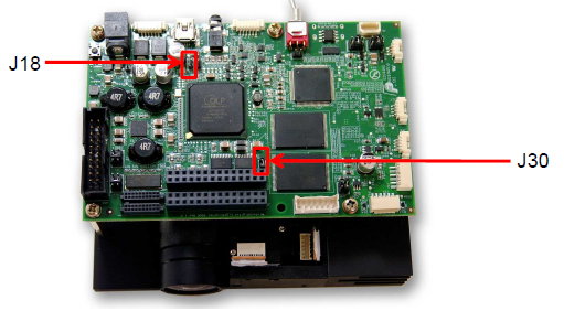

I have a emergency problem with my DLP4500,it can't quick start after the power is on,but the fan can start but without projecting,and,what's more ,the board can't connect to the computer,the D4 LED on the board can turn on and off,so I want to know that what the wrong is with my DLP4500.
Liao
  • Hi Liao,
    It sounds like the board is in a programming mode. Look at jumpers J18 and J30. If either have a jumper installed, remove them.
    Let me know if this solves your problem!
    Blair
  • I have the same problem.
    There is no jumper installed at J30 or J18.
    The power supply is the one that TI recommand : http://www.digikey.com/product-detail/en/CENB1060A1203F01/271-2718-ND/2533054
    The LED under the board lights up green but the D4 LED on the top doesn't.
    Sometimes the fan start and stops indefinitely when I put on the power supply and other times it just stays on.
  • Hello Steph,
    It sounds like your firmware may be corrupted. Does the EVM connect to the computer via USB?
    Blair
  • Hi Blair,
    I can't connect via USB. There is no activity (automatic detection) on the USB bus when I connect the LightCrafter.

  • Hey ,
    It looks like i have the problem with the firmeware as u have described above after an error during the firmeware upgrade  :-( is there any possibility to fix it by my self?
    Thanks for your help
    Michael

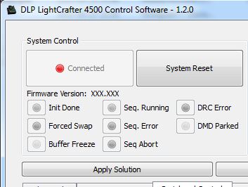

    Hi have the same problem with the LightCrafter 4500 kit. It doesn't start properly and the GUI application never connect through the USB port. Does anybody can provide a solution?
    Jordi
  • I just solved the problem placing the J18 jumper and then powering up the board. I found the answer at the lilnk suggested by Sanjev, then... Thanks Sanjev!
    Jordi
