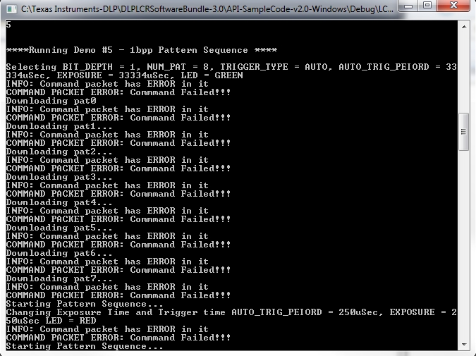

I downloaded the DLP LCR software bundle 3.0 and tried to run the demos in LCR_Cmd_Interface.
Demo1, 2, 3 run OK, but demo 5 and 6 give command packet errors as shown below. How to correcting the error?

Hello Dong Chen,
I believe the error condition might have occurred even before running Demo #5. Can you attach complete log i.e., which demo code was run before running demo #5?
Also can you run one more test? Power on the System, just run demo #5 alone. Let us know if it fails.
Sanjeev
Usually that kind of error happen when you try to load a set images but or the path is not the right one or the image is missing in the path you're indicating. Try also to check this and let us know.
