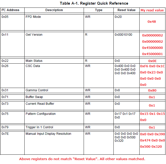

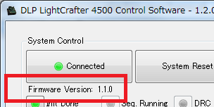

Hello.
I am evaluating LightCrafter4500 using I2C command from external mcu.
I could read values in each registers from mcu.
Some values matched "Reset Value" which is described in Table A-1(dlpu010b: P51-52).
But, Some values did not match it.
I would like to confirm whether my read value is correct, or not.
Could you check this?
