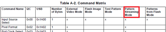

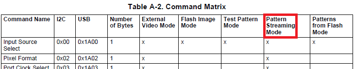

a) There is "Pattern Streaming Mode" in dlpu010b Table A-2(P52-54).
Could you let me know more datail about this mode?
I think this mode means both of them below:
  - Display Mode Selection Command (I2C: 0x69) = 0 (Patten Display Mode)
  - Pattern Display Data Input Source (I2C: 0x6F) = 0 (Pattern is streamed through the 24bit RGB/FPD-link)
 Is that right?
b) There are NOT listed some commands in Table A-2.
I would like to clarify whether the following each commands are available in "Pattern Streaming Mode".

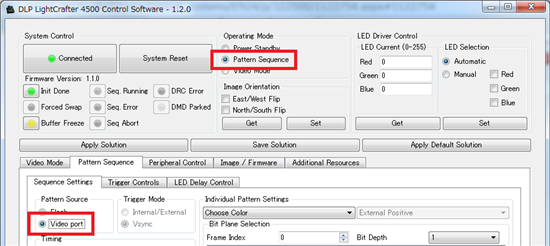

    Pattern Streaming mode refers to "Pattern Sequence" mode in the GUI when the video port is used as the data input source for patterns.
    I believe all of the commands you listed should be available in Pattern Streaming Mode, but I will confirm this for you.

    a) "Pattern Streaming Mode" is below configuration. Right?

    The configuration you've shown is correct. All of the commands you listed earlier, except the read commands, can be used within that operating mode. However, we recommend that you issue a sequence stop command first and then use the commands to ensure those commands don't affect sequence operation.
