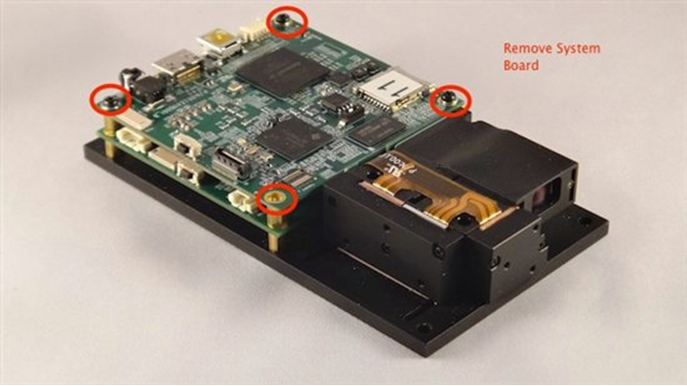

    To ensure that the connection between the top board and the bottom board and between the bottom board and the light engine is intact, follow the steps below to disassemble and reassemble the system:
    • Remove the top board (systems board) and double check that the ribbon connected from the connector on the driver board to the light engine is intact. Following screenshots would give you step by step instructions of disassembling the Lightcrafter and reassembling it.
    • remove the system board (top board) by removing the four screws in the corner posts.

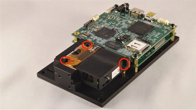

    • remove the three screws from the top of the light engine, you will need a Phillips P00 screwdriver

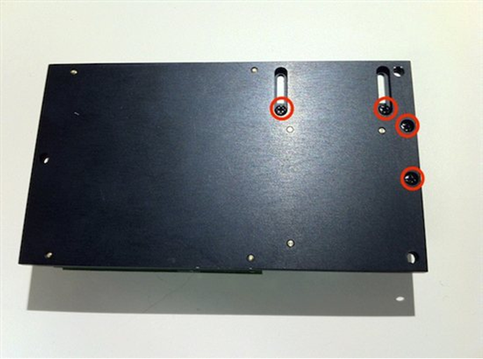

    • remove the four screws on the bottom thermal plate holding the LED heat sinks

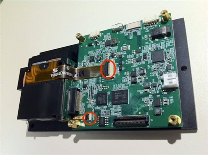

    • Make sure that this ribbon is intact (not broken), remove the ribbon cables from the driver board (bottom board). Just pull-up the plastic tab and pull-up the ribbon cable. Be careful, these ribbons are fragile and easy to break while pulling. Then just make sure you push the ribbon all the way in the connector snap it back on and put the system board back on top.
    Try booting it up and let me know if this fixes the issue.

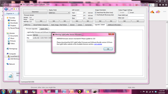

  • Which firmware download is it? There is DLPR300PROM and DLPR300SPLASH.
  • It's the DLPR300PROM.
    Manasi
  • I recieved this error message
  • Okay, figured it out, I now have light display, however, it got rid of the MSP430 firmware (saying 0.0 in the firmware version).
    I tried re-updating the firmware through the Upgrade/Splash tab, and it said "Command SUCCESS" in the bottom left corner but the firmware did not update when the get firmware button was hit.
    Any ideas?
    Thank you,
    Heather

    You should be able to choose MSP430 from the Upgrade drop down menu and then browse to the C:\Texas Instruments-DLP\DLPLCRSoftwareBundle-3.0\MSP430 v3.0 - FW directory to pick lcr_msp430_v3.txt file and hit Install.
    Remember that after you finish upgrading through GUI, you would have to hard reboot the system (unplug the power cord an plug it back in).
