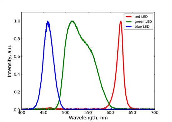

measured LightCrafter LED spectra
In case anyone needs it, here is LightCrafter LED spectra measured by a spectrometer. When measuring spectrum of individual LED, its current was set to maximum, current through other LEDs was set to minimum. The mode was set to 'Internal test pattern', pattern was set to 'solid red/green/blue'. Spectra were normalized and baseline subtracted.
