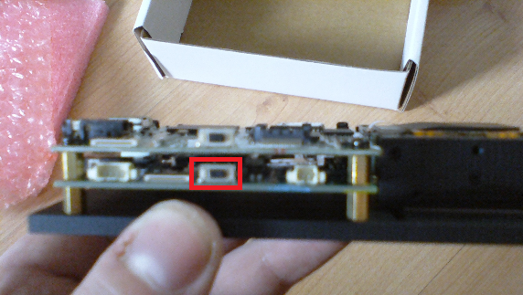

  • Hello Raymond,
    #1. You can use the push-button marked below first before removing the main power supply. The MSP430 on the system would ensure sending proper commands to DLPC300 to set DLP3000 in proper PARK state.
    #2. yes, it is true, there won't be any damage to the device. For the device reliability and longevity it is suggested to power off the device systematically.
    Sanjeev
