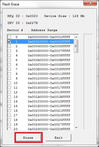

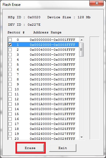

I have a problem with my DLP4500,it can't quick start after the power is on. The fan can start but without projecting.
The board can't connect to the computer via USB. There is no activity (Windows automatic detection) on the USB bus when I connect the LightCrafter.
There is no jumper installed at J30 or J18. The LED under the board lights up green but the D4 LED on the top doesn't.
The power supply is the one that TI recommand : http://www.digikey.com/product-detail/en/CENB1060A1203F01/271-2718-ND/2533054
