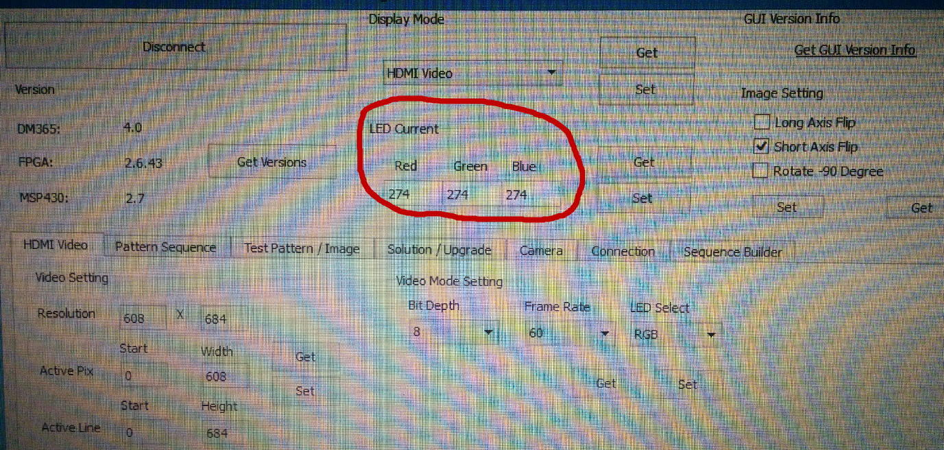

    It looks like the LED currents are probably set to certain value that is causing one of the LEDs to burn out. If the LEDs are heating up, then its going to lower the light output. On the LightCrafter EVM, there is one heat sink for both Green and Blue, so if the blue and the green LEDs are heating up or burning out then, its gonna lower their Light output and the supposed to white output might start looking pinkish.
    What are your LED current settings? Also refer to section 2.4 in the LightCrafter Users guide which talks about "Setting up the LED Current" and the maximum allowed LED current without any extra heat sinks.
    Adjusting the LED current will also be a good way to fix the white point.

    Thanks for your reply. I thought I has something to do with LED currents too, all currents are default to 274, I did not change it since day one. I don't have any external heat sink for the EVM. The device is sitting on a aluminum bar, hope the bar will transfer some heat away. Here is a screen shot of the current setting:

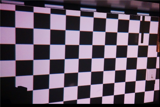

    This morning, the pinkish happened again, and this is the first time I turned it one since last Friday, the EVM should be cool down, here is the screen shot of the pinkish chess board, pay attention to corners.

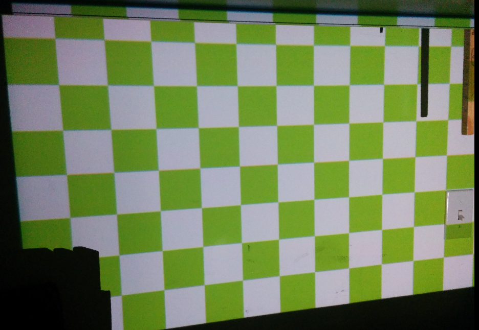

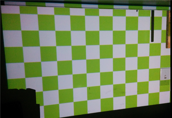

    When I turn it on second time, it showed some greenish chessboard, here is a screen shot:

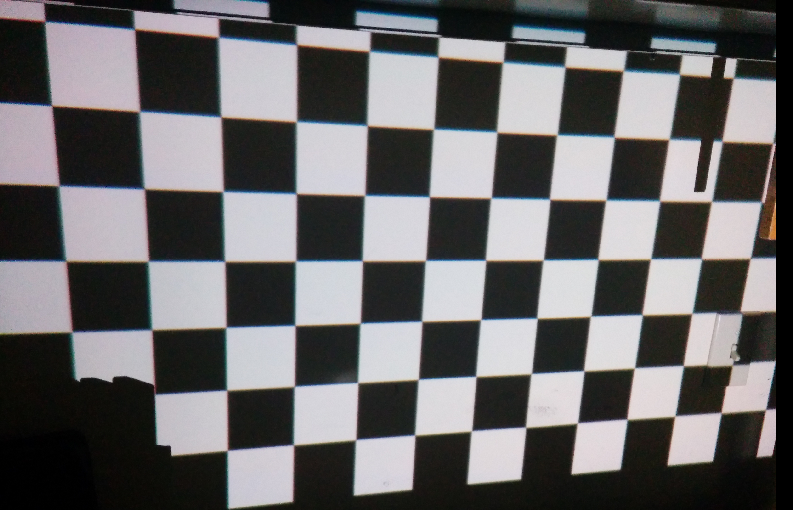

    After several tries, it finally went back to normal, this is what it supposed to be:

  • Hi Hongsheng,
    We've seen this phenomena sometimes in our lab. Either the Blue LED connection on the flex-circuit has become bad, or their is a component in the Blue LED driver section that has a cold solder joint on the DMD Driver board. You can also try to reseat the LED flex-circuit going into the DMD driver board to see if that is not making a good connection.
