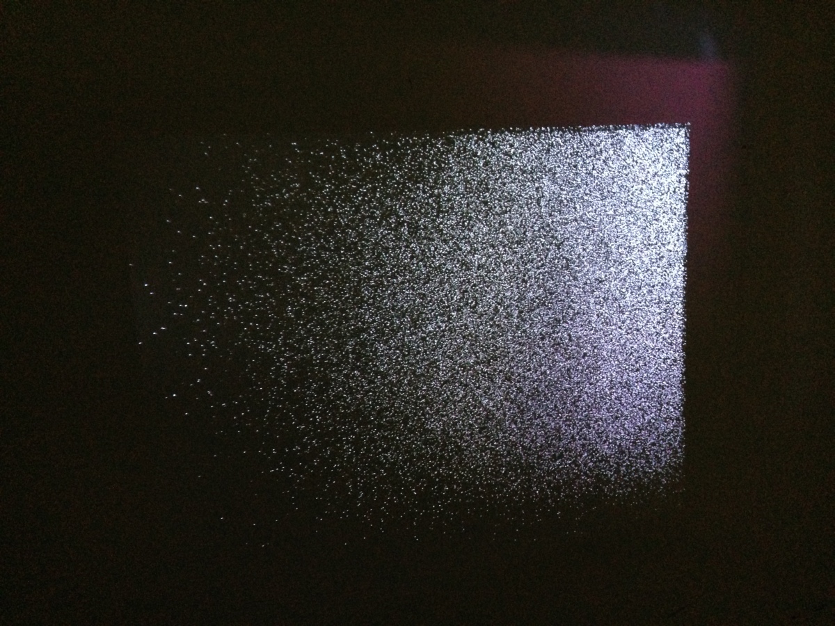

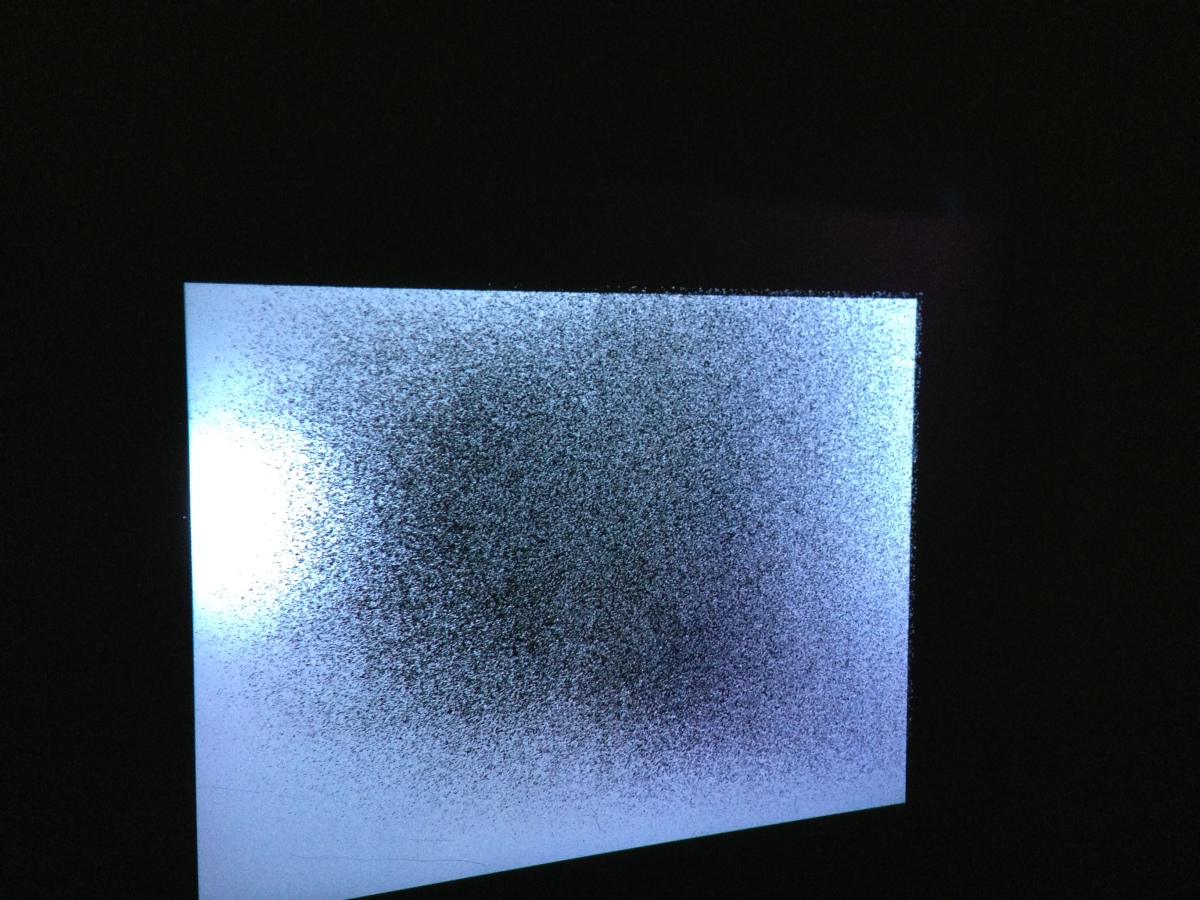

We're using the DLP5500 DMD for academic research. But plenty of micromirrors in our DLP5500 DMD doesn't work. In videos projected by the DMD, some pixels are always bright or always dark. Could you help me figure out the problem?
Our DLP5500 DMD is a part of LogicPD's DLP LightCommander Kit which is discontinued.  If it's a hardware problem, is it possible to replace it with a new DLP5500 and fix this problem?
Below is a "black" image the LightCommader projected:
And below is how it looks when projecting a white image:
When the white image or the black image is projected by the DMD, some "pixels" are always black or white.
I've upgraded the firmware of DLPC200 (MCU 2.2.0) but it didn't help.
Any help would be appreciated.

  • And there's another symptom. When display static images, a few certain pixels keep flipping over and over, which is also abnormal.

    I uploaded a video to Dropbox revealing the problem. I projected an white image (1-bit) to the wall at the beginning, and at ~00:05, a black image (1-bit) was projected, and at 00:17, the white image was projected again. Only a part of the full projection image was captured.
    https://www.dropbox.com/sh/aeh2zof3zlguo3o/AAADGEjps5oMS9gB3CvMk63Ra/DLP_problem.MOV
    You'll see:
    (1) There are many "bad" pixels when displaying white or black images.
    (2) When white images were projected, one pixel in the middle kept flipping (before 05:00 or after 00:17).
    (3) When the projected images altered from white to black or from black to white, the transition of many pixels lagged.
