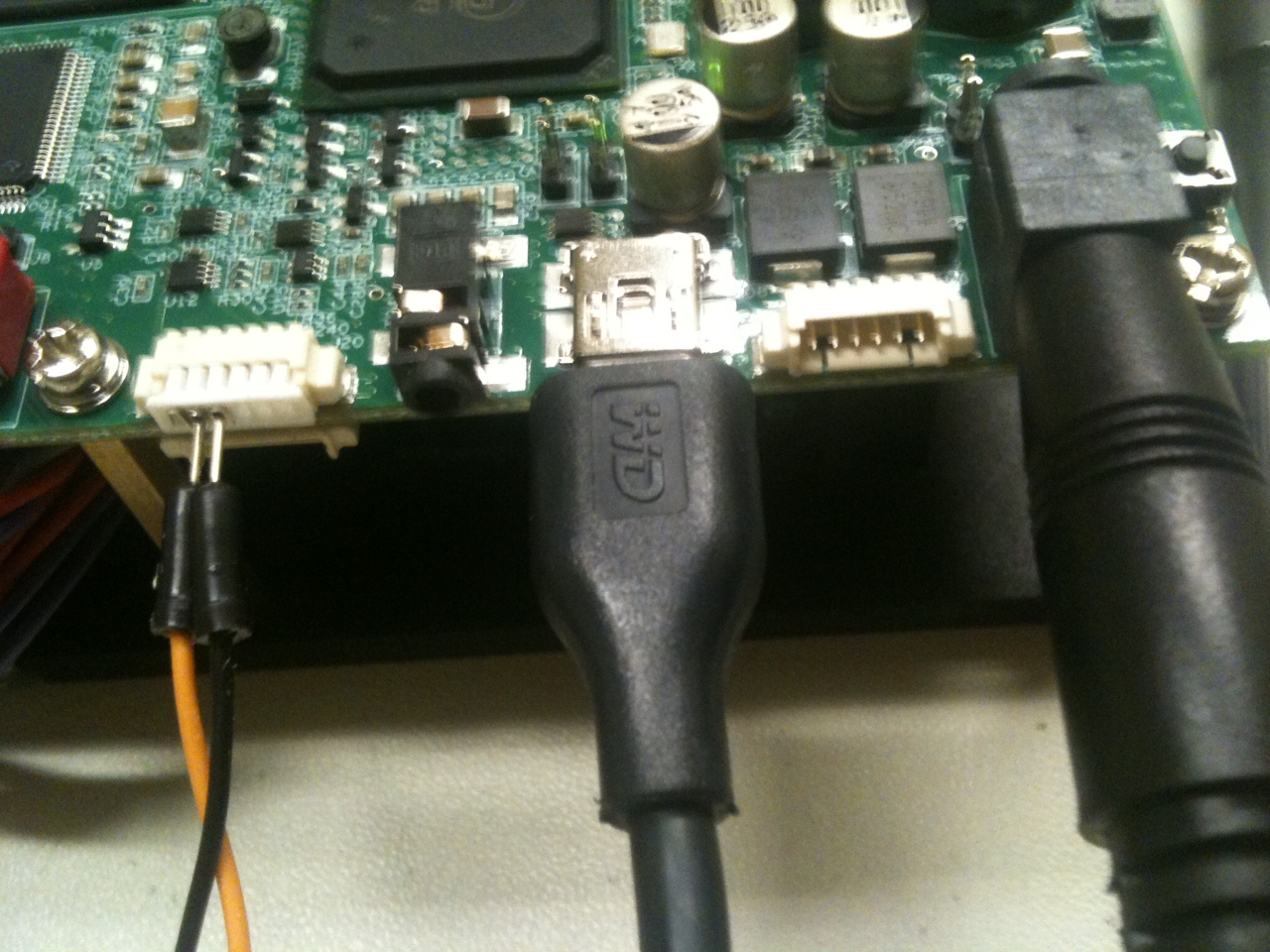

My second question: In my past triggering experience, all I needed to do was connect the to TRIG_IN_CON to the source of my 5V square wave pulse, and a ground pin to the ground of my source.  I tried that by connecting my system in the following way:
and I didn't get any sort of indicator as to whether this does anything after I tried to use the external trigger setting in the GUI.  The black wire leads to ground and the orange wire leads to the square wave.  Is this connection correct, or do I need to also connect a 5V VCC supply to the first pin in J11 (i.e. the one directly to the left of the orange wire)?  I'm sorry if this is a stupid question, but I didn't have to connect to VCC in previous triggering hardware.

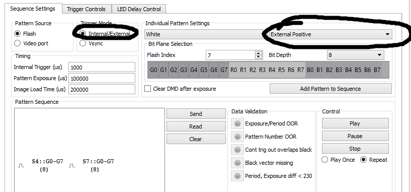

This leads me to my last question:  With the GUI, I believe the following (black circled) settings are correct, but I would like some verification:
It seems that using the external trigger setting in the GUI does not change anything - when I have it selected, it seems to continue displaying patterns as before, even if there is no trigger signal at all!  Does the LightCrafter4500 use the internal trigger by default if no external trigger is detected?  What do I need to change to get it to try to use the external trigger?

  • Hello Patrick,
    J11 - don't attempt 5V signal on the board, please read this technical advisory published in the forum http://e2e.ti.com/support/dlp__mems_micro-electro-mechanical_systems/f/924/t/345079.aspx
    Now, you can use either 1.8V or 3.3 volt trigger signals, for this you must make sure the jumper is appropriately set on J10 jumper selection switch. So try 3.3V or 1.8V it should work.
    [Sanjeev] No, it strictly goes as per the trigger configuration settings, there is no automatic selection if a trigger is missing. You must select the trigger properly in Pattern Look configuration.
    Sanjeev
