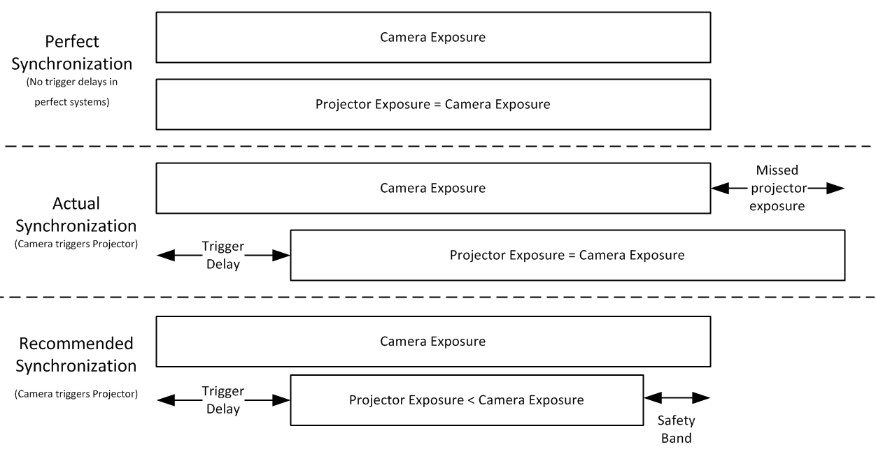

    Yes, you are correct that the frame rates would ideally the the frame rates would be identical. The issue is not necessarily the output frequency, but the exposure times and delays between the camera and projector.
    Before I go into further detail about the exposure timings, it is critical that you use triggering for proper synchronization. Either the projector needs to trigger the camera captures or the camera needs to trigger the projector. In other words, synchronizing the projector and camera becomes exponentially more difficult if both the camera and projector are in a "free-run" operation mode.
    As mentioned earlier, ideally there is no delay between the camera and projector which means they can have the same exposure times. The reality is that there will always be some delay between the exposures. In the case that the camera triggers the projector, this means the projector exposure goes beyond the camera's exposure and will miss some of the projected data. In addition to missing data, this also means the the next camera capture will have some of the previous projected pattern!
    In my experience, I have found the best practice is to have the camera trigger the projector and set the projectors exposure to be less than the camera's. Setting the camera exposure larger than the projector exposure guarantees the entire projected pattern will be captured during the camera exposure.
    The figure below show's: (top) what synchronization looks like in a perfect world, (middle) what really happens if no adjustments are made, and (bottom) the recommended mode of operation.
    If you are projecting 8-bit patterns with the LightCrafter 4500, the minimum allowable exposure is 8.333 ms which equates to 120 Hz, but your camera exposure probably needs to be closer to 10 ms to ensure the 8-bit pattern is properly captured. This means your overall frame rate would be 100 Hz.
    If you can use a lower bit-depth pattern, say 7-bit, the LightCrafter 4500's minimum exposure is 4.5 ms. With such a configuration your camera could easily be set to 120 Hz and the projector exposure set to 6 or 7 ms to achieve good synchronization.

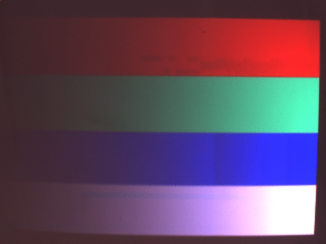

    In theory, yes you are correct, however in practice you'll find that the frame rates won't be an exact match and you'll run into the problem I described previously.
    To show you what I mean, I setup my projector to project a simple RGB ramp at 60Hz and my camera at 60Hz. You can see in the GIF below that there is are differences between capture frames even though their frame rates are supposedly equal to each other.
    It is possible to adjust the frame rates until they are as closely matched as possible, but using triggers is the simplest solution is to guarantee proper synchronization.
    For your second question, the DMD constantly updates the mirror positions even when the image does not change.
    Blair
