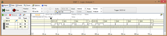

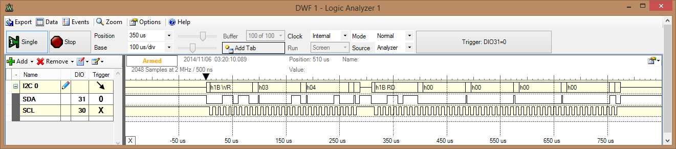

    Attached you will find screenshots from my oscilloscope and logic analyzer.  I'm attempting to read 4 bytes from the DLPC status register 0x03.  I have the i2c slave address select line tied low, and I can see that the DLPC is correctly acknowledging i2c traffic addressed to it.
    The logic levels all look good, there's no ringing going on in any of my transmission lines, and the DLPC's INIT_DONE line pulses as expected long before I attempt any kind of i2c operation, and yet no matter what address I target, I always get zeroes back from the DLPC.
    Any thoughts on what I should try next?  I can probe most of the pins on the DLPC, they are broken out to various test points.
    Cheers

  • Hello Geoffrey,
    Couple of inputs for you to try, please look at section 1.1 I2C interface, especially at the 1.1.1.5 and 1.1.1.6 for Read and Write protocol.
    First, since, I2C_ADDR_SEL is LOW, the DLPC300 7-bit address therefore is 0x1B, so for write and transaction to the device the address would be (0x1B << 1) | 0x01 (for read) and (0x1B << 1) | 0x00 (for write), in short the device address would look like 0x37 and 0x36 respectively.
    For example, to read the status register the protocol should be as follows -
    0x36 <register-address-> <number-of-bytes-to-read>
    0x37 <read-data-bytes>
    So, your command bytes must be sent as
    0x36 0x03 0x04 //Issue command to read status register
    0x37 0xXX 0xXX 0xXX 0xXX   //read number of bytes
    Sanjeev
  • Hey Sanjeev,
    Once again, thanks for the assistance.
    We have in fact been sending those commands.  The logic analyzer represents the read and write as 1b WT (36) and 1b RD (37).  We also get ack bits from the dmd.  The issue is that our reads are all returning zeros.
    Cheers

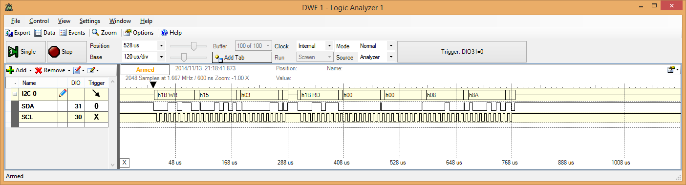

  • Hey Sanjeev,
    That's still not working for us. Here's an image of the new trace:
  • Hello Geoffrey,
    Okay,
    Try below additional options
    Option 1.
    Don't include number of bytes,
    0x36 0x15 0x03 0x04
    then read
    Option 2.
    0x36 0x15 0x03 0x04
    //add 10ms delay
    Option 3.
    0x36 0x15 0x03 0x04
    //add 10ms delay
    I think Option #1 or #2 should work, let me know.

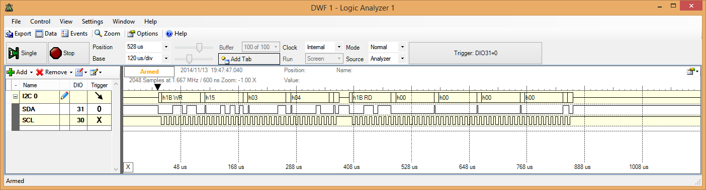

  • Hey Sanjeev,
    Option #1 worked.  I was able to read an address with a well known value.  Here's a trace.
    Attached

  • Hello Geoffrey,
    Good.
    Can you please re-attach the trace? we are not able see the trace, also for others who read this thread it will be very helpful.
    Write protocol also need correction.
    <I2C_device_address> <register> <four_bytes_of_data>
    0x36 <register_address> <data_byte_3> <data_byte_2> <data_byte_1> <data_byte_0>
    So, the register 0x30 is general purpose read/write register of size 16 bits but the protocol accepts 4 bytes always for data, so you must append MSB bytes with 0x00
    0x36 0x30 0x00 0x00 0xXX 0xXX  // 0xXX are the  actual bytes to write
    Example - 0x36 0x30 0x00 0x00 0xAA 0x55  // will store 0xAA55 in the register 0x30
