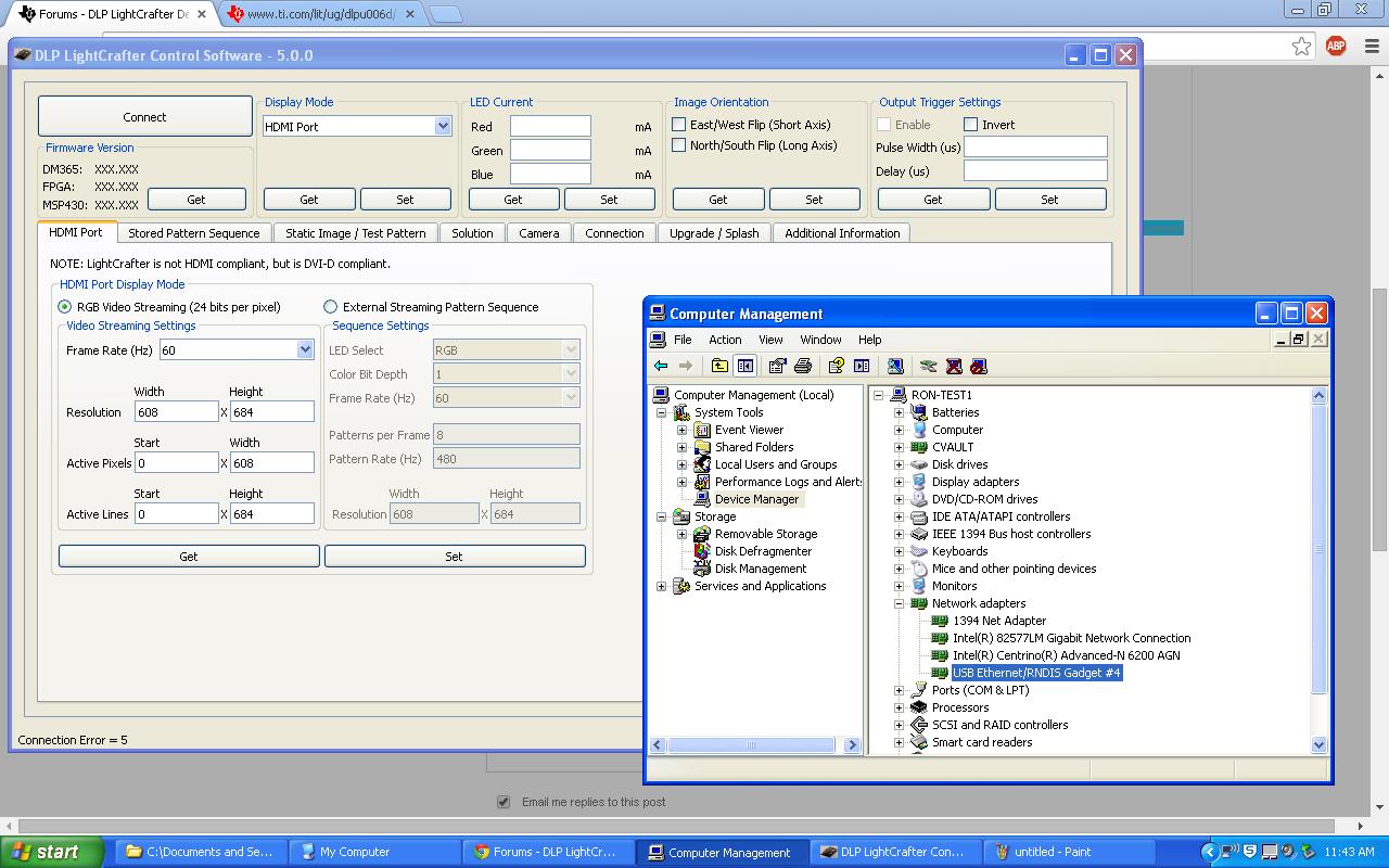

As  Xinyi Fan described in his post (http://e2e.ti.com/support/dlp__mems_micro-electro-mechanical_systems/f/850/t/358368.aspx), I cannot connect the DLP LIGHTCRAFTER anymore.
I could control the lightcrafter 3000 to project static images, but recently it can't be connected. The device can boot up and show the RGB stripes normally and can be recognized by the computer when it's connected via USB. However, It cannot be connected with the GUI provided. I checked the RNDIS network which is normal.  I've tried both the XP and Win7 OS . It shows "connection error =5" in the windows XP OS. In the Win 7 OS, nothing is shown. It just cannot be connected.
Please help me with it.

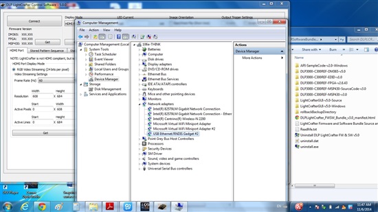

      1. For the Win 7 64bit OS, I get this,

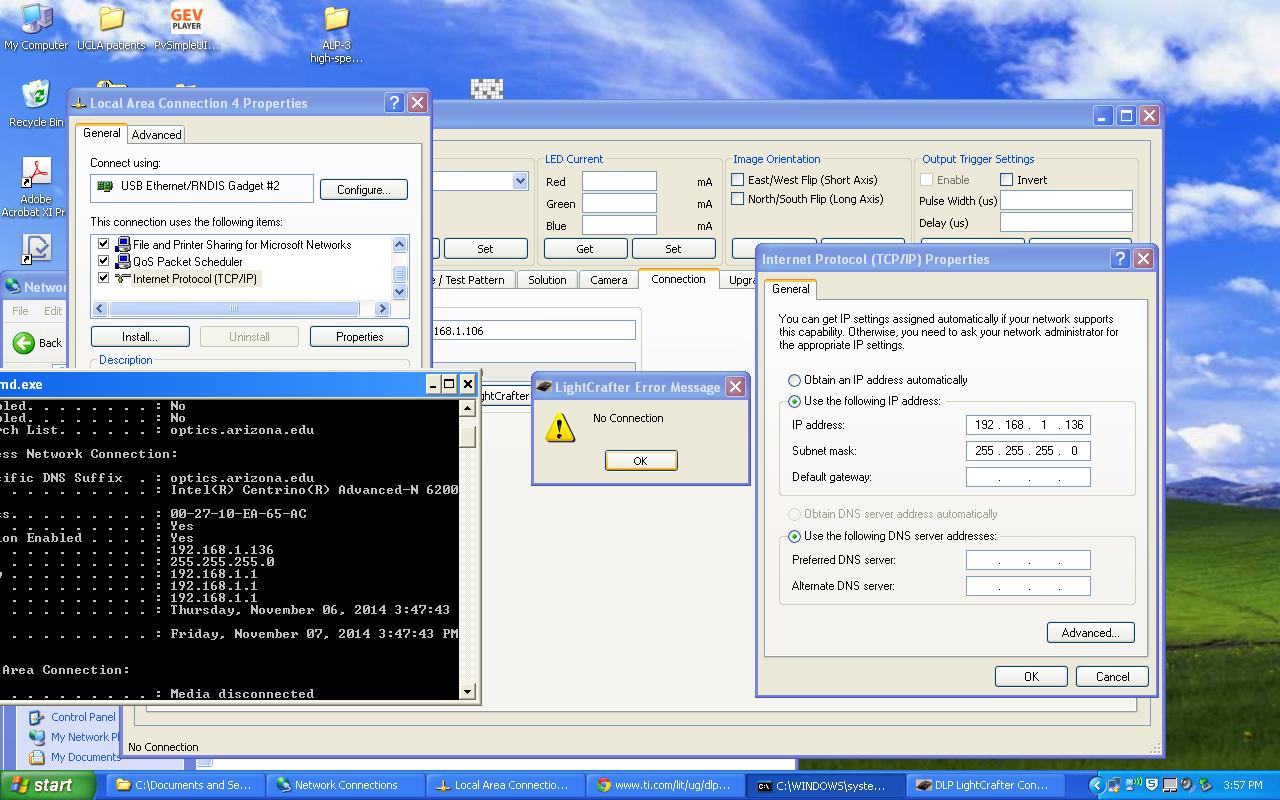

      3. Hi Clinton,
        I took your suggestion. Unfortunately, it doesn't work. Check the attached image below. For the step to change the ip address for the LightCrafter, it shows the warning "No connection". It still cannot be connected. The result for ping 192.168.1.100 is request time out.

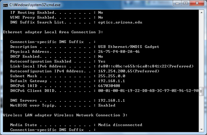

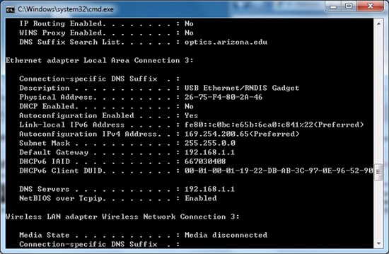

      4. Hi Clinton,
        However I set the ip address for the USB Ethernet/RNDIS gadget, the information for it is always shown as follows:
        Ethernet adapter Local Area Connection 3:
        Connection-specific DNS Suffix . :
        Description . . . . . . . . . . . : USB Ethernet/RNDIS Gadget
        Physical Address. . . . . . . . . : 26-75-F4-80-2A-46
        DHCP Enabled. . . . . . . . . . . : No
        Autoconfiguration Enabled . . . . : Yes
        Link-local IPv6 Address . . . . . : fe80::c0bc:e65b:6ca0:c841%22(Preferred)
        Autoconfiguration IPv4 Address. . : 169.254.200.65(Preferred)
        Subnet Mask . . . . . . . . . . . : 255.255.0.0
        Default Gateway . . . . . . . . . : 192.168.1.1
        DHCPv6 IAID . . . . . . . . . . . : 667030408
        DHCPv6 Client DUID. . . . . . . . : 00-01-00-01-19-22-DB-AB-3C-97-0E-96-52-90
        DNS Servers . . . . . . . . . . . : 192.168.1.1
        NetBIOS over Tcpip. . . . . . . . : Enabled
        How can I solve the problem?
        Zhenyue Chen
      5. Hi Zhenyue,
        It looks like your last post was info from your Windows 7 machine and the post before that was from your Windows XP machine. Both show different IP addresses for the LightCrafter.
        It looks like for your Windows 7 machine, you put your wireless router's IPv4 information for the LightCrafter properties. In the cmd prompt, you need to find the Ethernet adapter with the 'RNDIS/Ethernet Gadget #' description.
        For your WIndows 7 machine, you did not provide as much information in your screen shot, so I'm not completely sure what you have done in the IPv4 settings of the LightCrafter. You did capture the correct Ethernet adapter settings. Make sure the IPv4 Address and Subnet Mask match these values. I would initially leave the Default gateway empty and test that configuration.

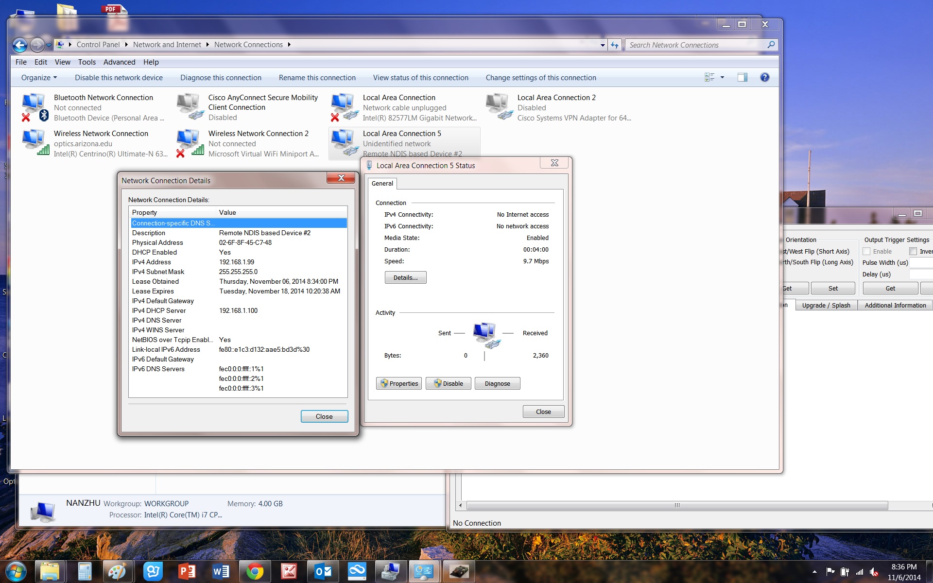

      6. Hi Clinton,
        I tried another Win 7 64bit computer. This time the ip address for the DLP LightCrafter and "RNDIS/Ethernet Gadget #" is in the same domain. Everything looks alright. However, the LightCrafter still cannot be connected. What's the problem?

      8. Hi Zhenyue,
        I'm glad you were able to connect to your LightCrafter and confirm it works. The LightCrafters can work on laptops. I actually use a Windows 7 64-bit laptop most often with the LightCrafter.
        I would suggest closely following the steps to update the IPv4 address and subnet mask, as described in the LightCrafter's user's guide. You have not posted a screen shot where I've seen settings that match the directions in the user's guide.

      9. LC can work on Laptops. My crystal ball is telling me that your Wifi network uses the same network range as the LC. For debugging we would need the output of "ifconfig /all" on the command line when the LC does not work.
        C.
      10. Hi  Curtis,
        You're a genius. I disabled the WIFI connectivity. It works now. Awesome.
        Zhenyue Chen
