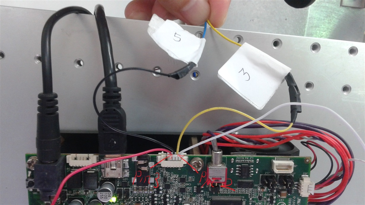

First situation, We use trigger out1 (pin 2) and ground (pin 3). The DLP at step4-6 can't project any patterns.
Second situation, We use trigger out2 (pin 5) and ground (pin 6). The DLP at step4-6  just can project one pattern at each step.
How can I fix the problem? Thank you very much.

    Did you make the connections stated in the trigger cable assembly guide? http://www.ti.com/lit/df/tidu457a/tidu457a.pdf
    Please make sure that you connect the trigger cable to the input trigger connect on the LightCrafter 4500 as well. Please reference the schematic for the correct trigger connector: http://www.ti.com/lit/df/tidr933/tidr933.pdf

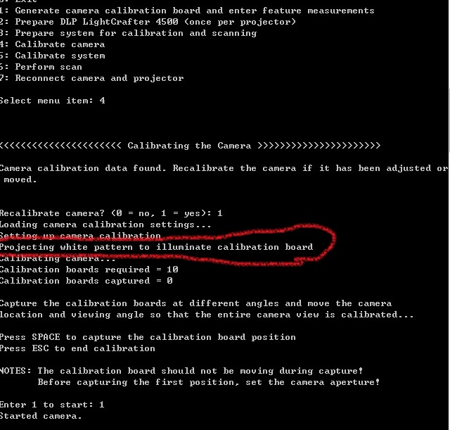

  • Hi Sanjeev,
           Thanks for your reply!

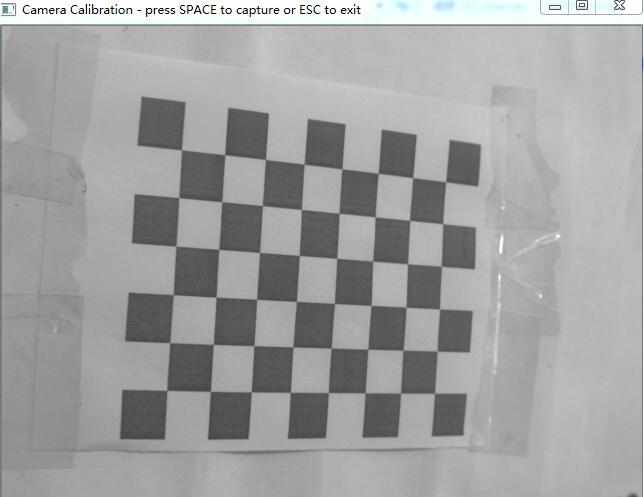

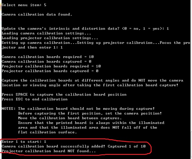

           I am referring to the steps in  http://www.ti.com/lit/ug/dlpu019/dlpu019.pdf Section 3.2 Camera Calibration Procedure and Section 3.4 Projector and System Calibration procedure.
           1、At the step Section 3.2, the  Command Line show "projecting white pattern to illuminate calibration board" as labeled red in the follow picture. However, the projector does not cast a white pattern as the next picture,
           2、 It's similar to the Section 3.4 that there is not Checkerboard casted by the projector.

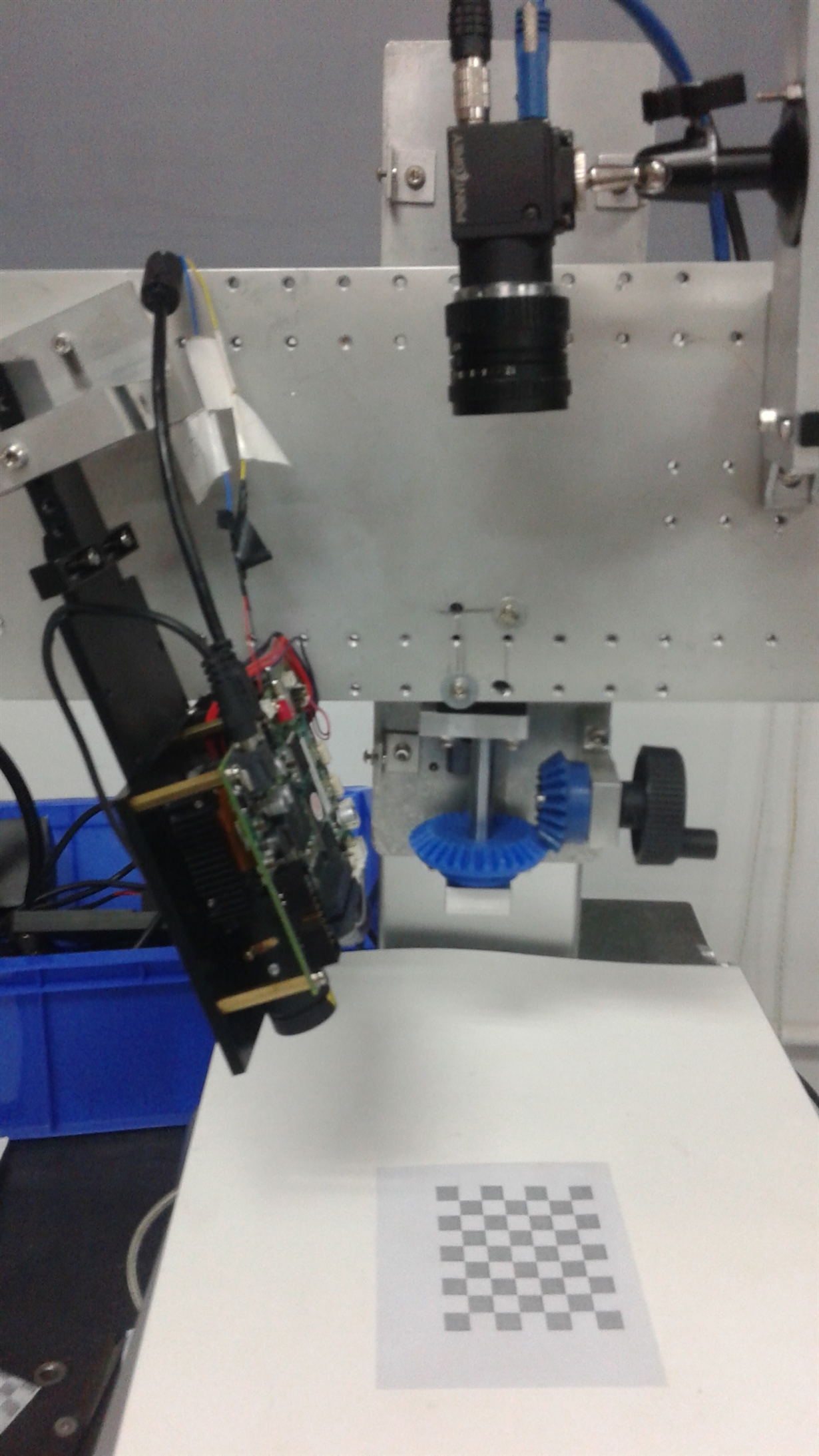

         3、I connect the camera,DLP,and PC  based on  http://www.ti.com/lit/ug/dlpu019/dlpu019.pdf and www.ti.com.cn/.../tidu457a.pdf:
         The actual connections :
    Yu Peng.

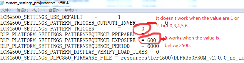

  • Hello Ssnjeev,
           I have solved the problem. In the calibration procedures, the projector can cast corresponding patterns now, and the calibration procedures are successful. I changed tow value:
               Actualy, I don't know why, what's the meaning of the "LCR4500_SETTINGS_PATTERN_TRIGGER = 0".
              And I have noted "5.1 General Troubleshooting Steps" of "TIDA-00254: Accurate Point Cloud Generation or 3D Machine Vision Applications using DLP® Technology and Industrial Camera":The formula for the conversion to and from frame rate to exposure is:
    106 = Camera Frame Rate × Projector Exposure Time
    If it's true, then the Projector Exposure Time is too low because the Camera Frame Rate will not be so high.

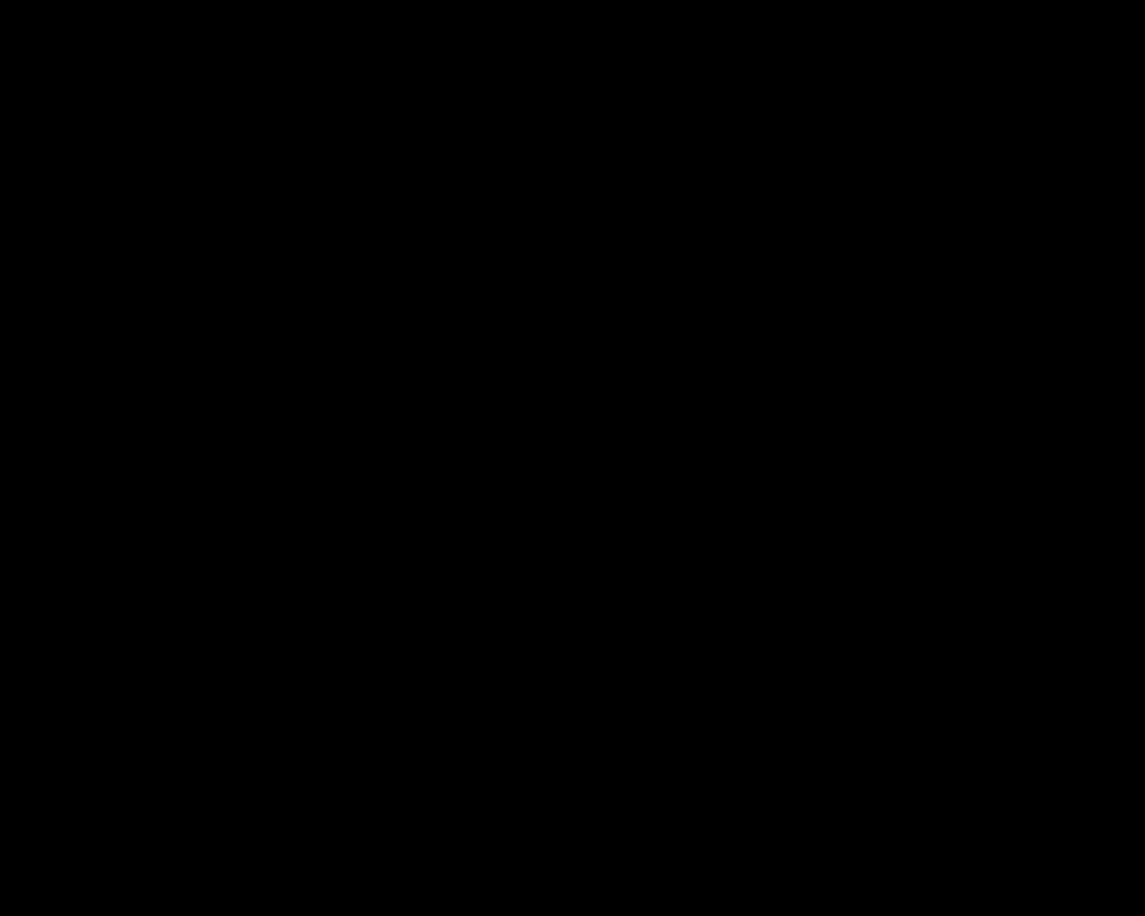

            Besides,I can not generate a Depth Map but a black picture,and the"point_cloud.xyz " is empty:
                                                                                                      Depth Map
         At last, I have not detected any trigger signal from the camera via the cable beteewn DLP and Camera in whole process.I don't know if there should be some trigger signals from camera to trigger the DLP4500?
         Thanks a lot!

  • Do you mean when you set "LCR4500_SETTINGS_PATTERN_TRIGGER = 0" values to 0, 3, 4, 5, ... it works?
    Because now we are able to perform calibration doesn't me the calibration is successful. Did you perform both Camera and projector calibration. What are the xml settings generated in the Output directory? What are the results of the calibration...
    A poor calibration result can also lead to poor point cloud. So i think we should still go back and look at the calibration.
    Sanjeev

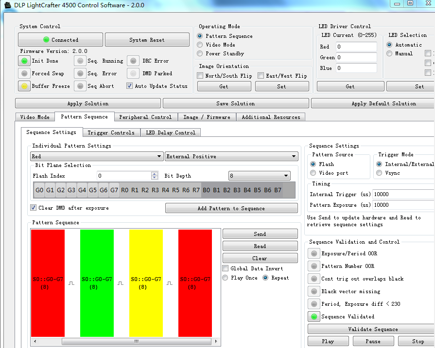

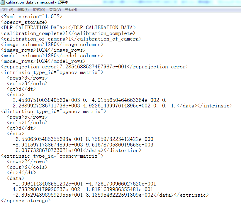

  •       Yes,when the values are set to be 0, 3, 4, 5, ...the projector can cast white pattern or chessboard, and I do the calibration well.
          I think: the circuit of the external trigger is damaged,so the DLP350 can't receive trigger from the camera.
          The "LCR4500_SETTINGS_PATTERN_TRIGGER" = 1 or 2 are corresponding to the Trigger 1 In and Trigger 2 In(J11) for external trigger from camera,respectively. But when the circuit of the external trigger is damaged, the DLP350 can't receive trigger signals from the camera. However, when the values are 0, 3, 4, 5, ...the projector don't need external trigger from camera, but receive some internal triggers from system. That's why when 1 or 2 it does not works,but when others it works.

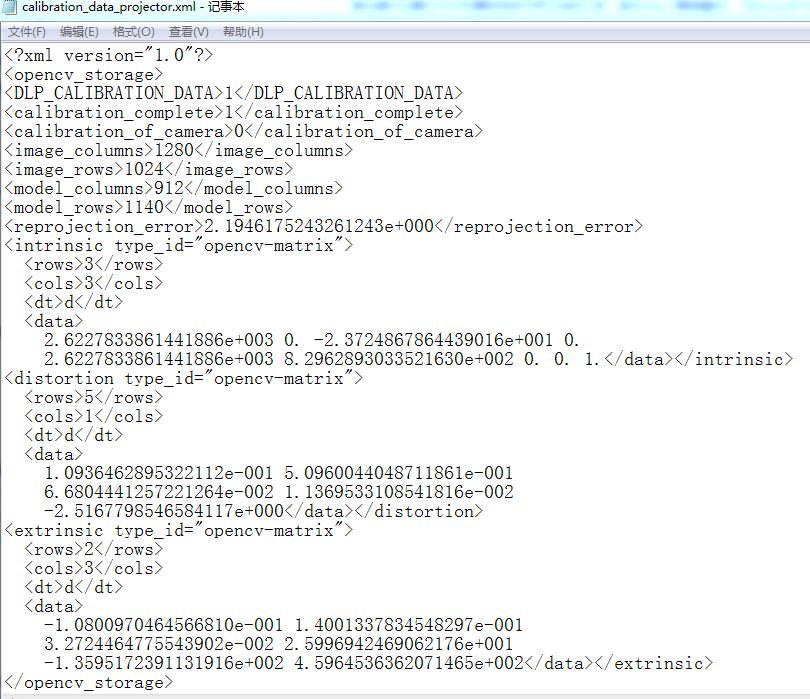

       The "calibration_data_camera.xml" is :
          The "calibration_data_projector.xml" is :
      The reprojector erros may be lower sometimes.
    Yu Peng
  • Hello Yu Peng,
    Yes, could be problem with DLPC350 not getting the trigger signals from the Camera.
    Note the 1 and 2 map to external trigger signals the definition is as follows
    INTERNAL = 0, /**< Internally triggered pattern */
    EXTERNAL_POSITIVE = 1, /**< Externally triggered pattern by a low to high transition */
    EXTERNAL_NEGATIVE = 2, /**< Externally triggered pattern by a high to low transition */
    NONE = 3, /**< No trigger */
    INVALID = 4
    So you have just 0 to 3 valid settings.
    There is another parameter for mode settings :
    MODE_0_VSYNC = 0, /**< Mode 0 triggering, uses Vsync signal */
    MODE_1_INT_OR_EXT = 1, /**< Mode 1 internal or external trigger */
    MODE_2 = 2, /**< Mode 2 triggering */
    MODE_3_EXP_INT_OR_EXT = 3, /**< Mode 3 expanded internal or external trigger */
    MODE_4_EXP_VSYNC = 4, /**< Mode 4 expanded triggering with VSYNC */
    INVALID = 5
    Here the default settings is taken as MODE_1_INT_OR_EXT
    Was the Camera triggering projector ever worked for you?
    Since you are able to trigger the camera you are using a valid INTERNAL = 0 option setting, in this mode you should configure camera in external trigger mode, so projector triggering the camera, further, you must adjust the camera exposure setting matching the projector trigger period. If possible set it to lesser value so that Camera completes it exposure before receiving the next trigger pulse.
    Also enable the debug mode to see how the captured images look. If you are able to compile the code, refer to main.c

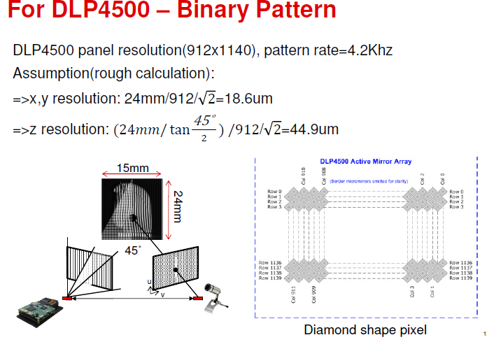

  • Hello Sanjeev,
            I have some questions about DLP4500.
    1、I have noted that the resolution of Z-axis can be 44.9um:
                I want to know it's only the theoretical value or actual value we can obtain? I have fond that we cannot do scan in such a small view field of 15mm*24mm because of the physical size of DLP and camera.
               At the same time,  the view field must larger than the pattern projected by DLP. But the pattern size is always much larger than 15mm*24mm when we get a clear pattern, as the focal length of the projector lens of DLP is 140mm.
               And why the angle between DLP and camera is 45 but not 60 or 90 in the formula upon?  Is it an experience value? Based on the formula, the angle is bigger the resolution is higher.
              What is the best resolution or precision have you obtained as far as now?

    3、In the calibration procedures, if camera is perpendicular to the calibration board or object,and DLP project pattern tiltly on the calibration board,or object, can we get a better reprojection error and point cloud?
           We find it is very difficalt to do calibration and the reprojection error is much larger than 2, and the depth map and point cloud we get are very bad. How can we do the optimization?

  • #1. We are working on this. The values are theoretical calculations.

    #3. For Perform camera calibration -
    You can actually keep camera free i.e., not hooked to fixture; this way you can capture many chessboard snapshots at different variation. Once the camera calibration is done; for Projector calibration step, you can mount the camera at the fixture and then perform the Projector calibration.
    Also looking at Projector and Camera fixture; the projector seems to be too close to the chessboard, is it in focus? What is the distance from projector lens to the flat surface. You mentioned 140mm as minimum focus distance, so is the current distance b/w projector and the surface > 140mm? Have you changed the projector lens in case if you have kept close to surface?
