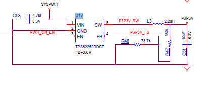

I received a DLP 3010 EVM. When I powered on the EVM the projector is not turning on. D15 (SYSPWR) led is “ON" but D16(PWRNON) led is “OFF” even after I turned on the SW1 switch. Could someone advise how to resolve this issue?

Hi Manoj,
Sorry to hear that. Are you using power adapter INPUT: 100-240V, 50-60Hz, 0.5A. Output: + 5V, 3.0A?
Without flip SW1 switch, you should see D15 and D16 LEDs lit immediately.
If you use the correct power adapter and still cannot turn on the projector, please consider to send the unit back and exchange for another one.

Hello User,
Can you please measure the voltage on U17 pin 5? This is the 3.3V voltage regulator which is connected to D16.

Hello Andy,
Can you please measure pin 5 on U12 and U1 ? U12 should put out 1.8V and U1 should put out 1.2V. I would like to see if the other supplies are still working.
It might be that only U17 is damaged.

Hello Andy,
I might be that only U17 is damaged. Do you have a way to replace this part ? If not, TI has a 90 days return policy. Have you purchased this EVM less than 90 days ago ?

Hello Andy,
1 Ohm is a little bit low. I measure on a good EVM 10kOhm.
If you really want you can try to change U17 but I would recommend to send the EVM back and we will replace it.
You can request a sample for this part see following link: https://store.ti.com/TPS62260DDCT-225MHz-600mA-Step-Down-Converter-in-2x2mm-SONTSOT23-Package-P17277.aspx

Hello Nadine,
I've tried to remove U17 and C51 but the resistor from U17 pin 5 to GND is still low.
I think that send it back for checking will be better. Could I have the address and contact window to do that?

Hello Andy,
You should have received with your EVM an information page. You need to contact our Product Information Center. The phone number for your country is listed on the back of the information page.
