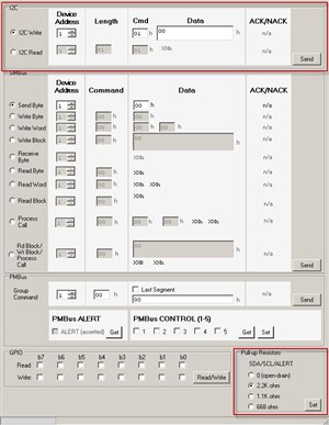

I have my USB to GPIO Interface Adapter. I download the software given in the TI website http://www.ti.com/tool/usb-to-gpio. A page where I could enter my I2C commands PMBUS GPIO, etc commands pops up. ( I will provide a picture of the page that I am talking about below) Everything is so far so good. I connect one end of the 10-Pin ribbon cable (that came in the same package as the USB to GPIO Interface Adapter) to the USB to GPIO Interface Adapter. I then connect the USB to mini USB cable (that came in the same package as the USB to GPIO Interface Adapter) to the USB to GPIO Interface Adapter and the other end of the USB to mini USB cable was connected to the PC. Basically, I followed exactly what was described in the user manual. The green light on the USB to GPIO Interface Adapter lit up and everything is fine.

After everything was set up, here is what it looked like in my computer screen:
I am using the DLP PICO CHIPSET Programmer's Guide User Manual for the DLP Pico Projector to help me with issuing I2C commands. I have read through it but I do not understand how to use it. I am an extreme beginner at I2C. I have read past forums, user manuals, google, and basically everything but I still do not know what exactly needs to be put in that screen.

If I want a checkerboard pattern to be displayed, (that is, I want the digital micromirrors to have a checkerboard pattern so that whatever is in my computer screen gets "checkerboarded" so to speak.), what needs to be put in Device Address, what needs to be put in Cmd, and what needs to be put in Data for when I2C write is bubbled in? After I have set everything up in I2C write, do I then send or do I have to set things up in I2C read. What needs to be put in I2C read then: what do I put in Device Address, in Length, and in Cmd. I tried playing around with things (putting in numbers that I thought was right) under the "guidance" of past forums and the programmers user's manual, but unfortunately I just get errors. I played with the I2C Write and pressed Send and I got Error under ACK, then I played with the I2C Read and pressed Send and I got Error under ACK. I then tried to set Pull-Up resistor to 2.2K ohms and I got an error.
In conclusion, if someone can provide detailed step-by-step instructions on what numbers needs to be put where to and when I press the Send button, I would really appreciate it. If I can I have some dictionary and examples that translates  and shows how to put whatever is in the programmers user's manual to the screen above in the respective places. I only see in the Programmer's Manual things like (I2C:X0B) and then a column that says BITS and a column that says Description and a column that says TYPE and I do not know what to put in the Device Address, Cmd, Data, length, etc. Can you please tell me what needs to go where. Please tell me exactly what numbers or whatever needs to go where to do the checkerboard example as discussed above. I have read the USER Manual for the USB to GPIO Interface Adapter and still do not get their instructions.

    The USB to GPIO Interface Adapter has a software that I could work with, but I just don't know how. The picture of what is on my computer screen (that is what the software lets me work) with is above in my original question above. Here is the link where I downloaded the software; it is from the TI website. www.ti.com/.../usb-to-gpio. I am not sure about these questions that you asked though: Does it connect directly to the i2c bus going the the DLP controller? Does the projector also use this bus? All I know is that I could use the Auxillary Port of the Pico Projector to issue I2C commands and that I have seen from one or two past forums that they were able to issue I2C commands through the Auxillary Port using the USB to GPIO Interface Adapter. (I tried posting my question there, but I was not able to get any answers).
    My primary question, I guess, would be what do I write in the space provided by the USB to GPIO Interface Adapter Software ( The screen shot is above in my original question) if I want to have a checkerboard pattern. The Programmer's User Manual for the Pico Projector doesn't really tell me anything forcing me to not know what to write on the space provided. If I could have some translation of what the manual says to how I could use it with the software that would be great. For example if the manual says (I2C:x0B) , does 0B go under Cmd? Then, what do I put for the data? Again, the user manual doesn't tell us. (It just gives bits and description) Then what would I need to fill in for the I2C read section. In conclusion, I believe, (but please correct me if I am wrong) I have everything set up write and the using the adapter and auxillary port is fine it is just that I can't know for sure because I can not even begin to issue one command because I do not know what numbers need to go where in the space provided (because the programmers and the usb to gpio interface adapter is somewhat unclear and vague for me at this point.)

    I am going to jump in here on this.  Kevin was thinking this was a consumer projector, but this was an EVM made by Young Optics.
    The following two threads are for Linux using the Beagle board, but Pascal describes how to read the command information.  This should allow you to determine what to put into the various command boxes on the GUI interface you have.  For example one part of the Linux command is "wb4" which means write 4 bytes.  You will then need to look at the GUI for the USB-I2C adapter you are using and find what to populate to have it write 4 bytes.  The threads are:
    http://e2e.ti.com/support/dlp__mems_micro-electro-mechanical_systems/f/94/p/99395/348345#348345
    http://e2e.ti.com/support/dlp__mems_micro-electro-mechanical_systems/f/94/p/138021/505326#505326
    The second thread has a number of command spelled out in Linux format for use on a Beagle Board.  You will not use the port listed there, but the rest of the command can be decoded using the information Pascal spells out in the first thread.

  • Ok thank you. I am trying what you suggested. I have written 27 as the device address and 0B as the command and 00000000 as the data and then clicked send. But I got an error. I tried 36 and 1 as device address but still error in the ACK/NACK column. The manual says wr4 is C times the number of bytes which I do not understand what it means. This is shown on page 14. here is the link www.ti.com/.../sllu093.pdf
  • Ok, this does help. Thank you for your response I really appreciate it. I issued a command (it says ACK instead of error now) but I still do not see a checkerboard pattern so I think I need to issue another line of command. So I still have a few questions and I would really appreciate your time if you could help answer them. You've been a great help!!! Thank you!
