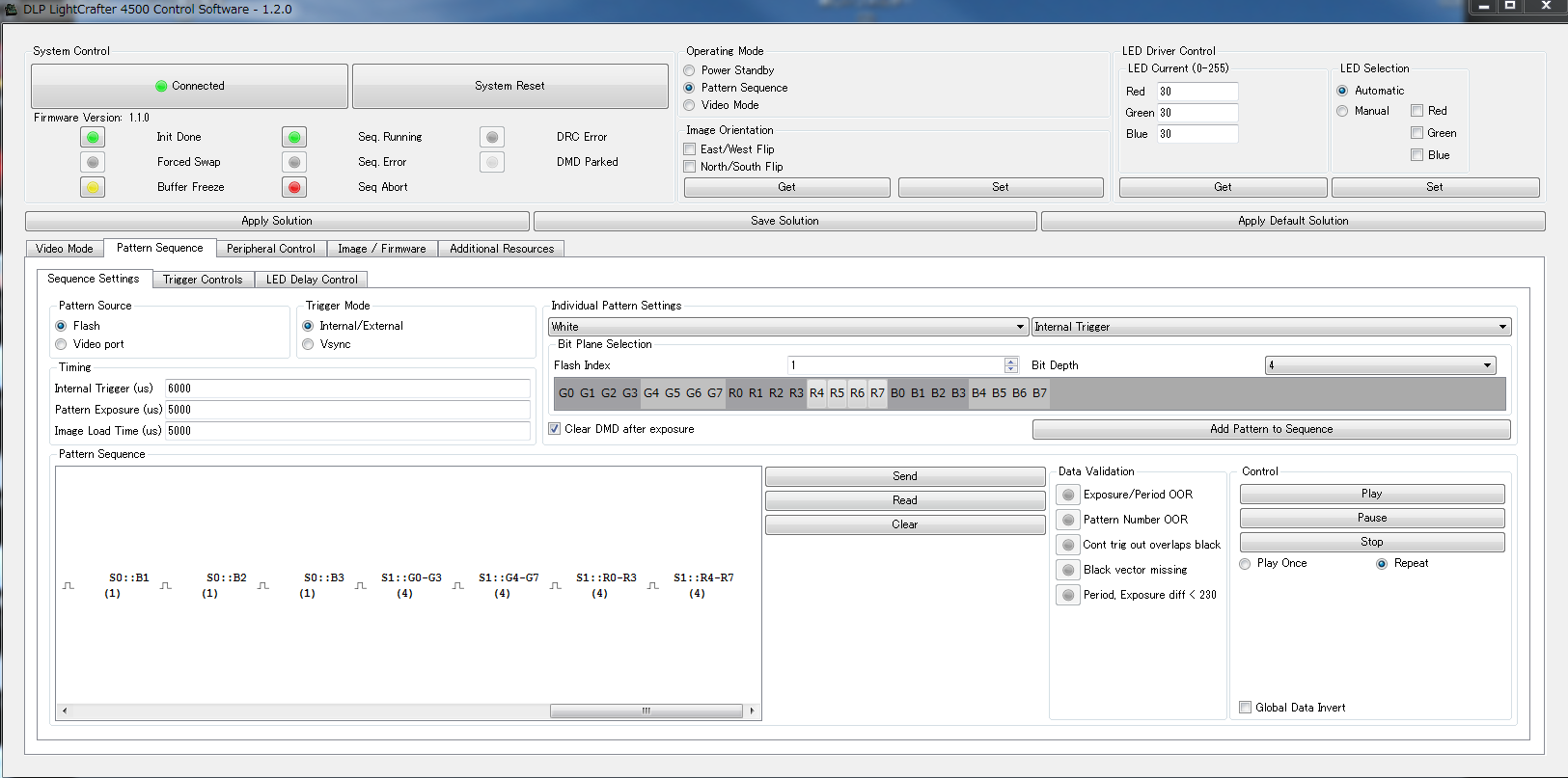

My customer is using the Pattern Sequence mode of DLP4500.
My Customer gave a confirmation following operations using the DLPLCR4500EVM.
● operating environment
 DLPLCR4500EVM
 Firmware Version: 1.1.0
 GUI: DLP LightCrafter 4500 Control Software - 1.2.0
● Checking the contents
 Flash Index: 0
 Bit Depth: 1
   G0 ~ G7, R0 ~ R7, B0 ~ B3(Sub Total : 20pattern)
 Flash Index: 1
 Bit Depth: 4
 G0G1G2G3, G4G5G6G7, R0R1R2R3, R4R5R6R7(Sub Total : 4pattern)
 Displays can be a mix of the above Pattern.
I will attach the setting screen of the GUI.
It was confirmed that it has been projected at the set time.
Total bit number is 36bit,
Is it possible to write the mixed the 1bit and 4bit pattern in the internal buffer of DLPC?
