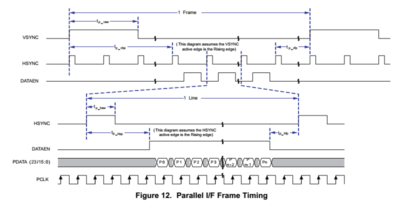

    Thank you for your prompt reply, I am a bit puzzled
    1. I use sequence mode, not with the video mode. You give the third point above (Refer Section 6.11 Video Timing Input Blanking Specification DLPC350 datasheet www.ti.com/.../dlpc350.pdf
    ) The timing, I can understand that you are based on Figure 7. Horizontal and Vertical Blanking Diagram own definition of it? Because I did not find in DLPC350 datasheet. My question is this timing sequence diagram can be used to model?
    Timing 2. The trig 0 mode timing chart and DLPC350 Programming Guide on how to understand?

    Your FPGA don't need to perform extra things, it can generate proper video timing like any other monitor device. The key is the resolution and minimum blanking timing requirements.
    Part - 1: Generate 912x1140 given frame rate (upto 120Hz), for RGB Parallel Signal timing we have provided you the Figure 12 for reference.
    Part -2: Configure LightCrafter 4500 in Trigger Mode - 0, here you have flexibility to choose bit(s) from incoming 24-bit  frame data, so you can select any combination of pattern(s) bit-depth color with one requirement is that the SUM of total patterns selected from display is LESS THAN the incoming video frame rate. For example - Incoming video rate is 60Hz, so available time 16.67ms, so if you chose pattern 1, pattern 2,.... pattern N, so sum of (Pattern 1, Pattern 2 , ... Pattern N) < 16.67ms.
    Further as explained in DLPC350 programmer's Guide, Figure 2-9, Trigger Mode - 0 timing example, Sum of  P1 + P2 + [P1 P2 P3] + P4 < FRAME TIME, we have not given exact timing because pattern exposure is user selectable, Similarly, Trig_Out_1 and Trig_Out_2 behavior and signal delay timings are user selectable.

    [Sanjeev] We are not able to understand your query exactly. The FPGA should generate the 912x1140 video signals as specified in the data sheet.
    The video signal for example 60Hz should as follows
    Pixel Clock : 83.6 MHz
    Horizontal:
    Active Time : 912 Pixels
    Blanking Time : 280 Pixels
    Sync Offset : 40 Pixels
    Sync Pulse Width: 64 Pixels
    Border : 0 Pixels
    Frequency : 70 kHz
    Vertical:
    Active Time : 1140 Lines
    Blanking Time : 30 Lines
    Sync Offset : 10 Lines
    Sync Pulse Width: 6 Lines
    Border : 0 Lines
    Digital Separate, Horizontal Polarity (+), Vertical Polarity (+)
