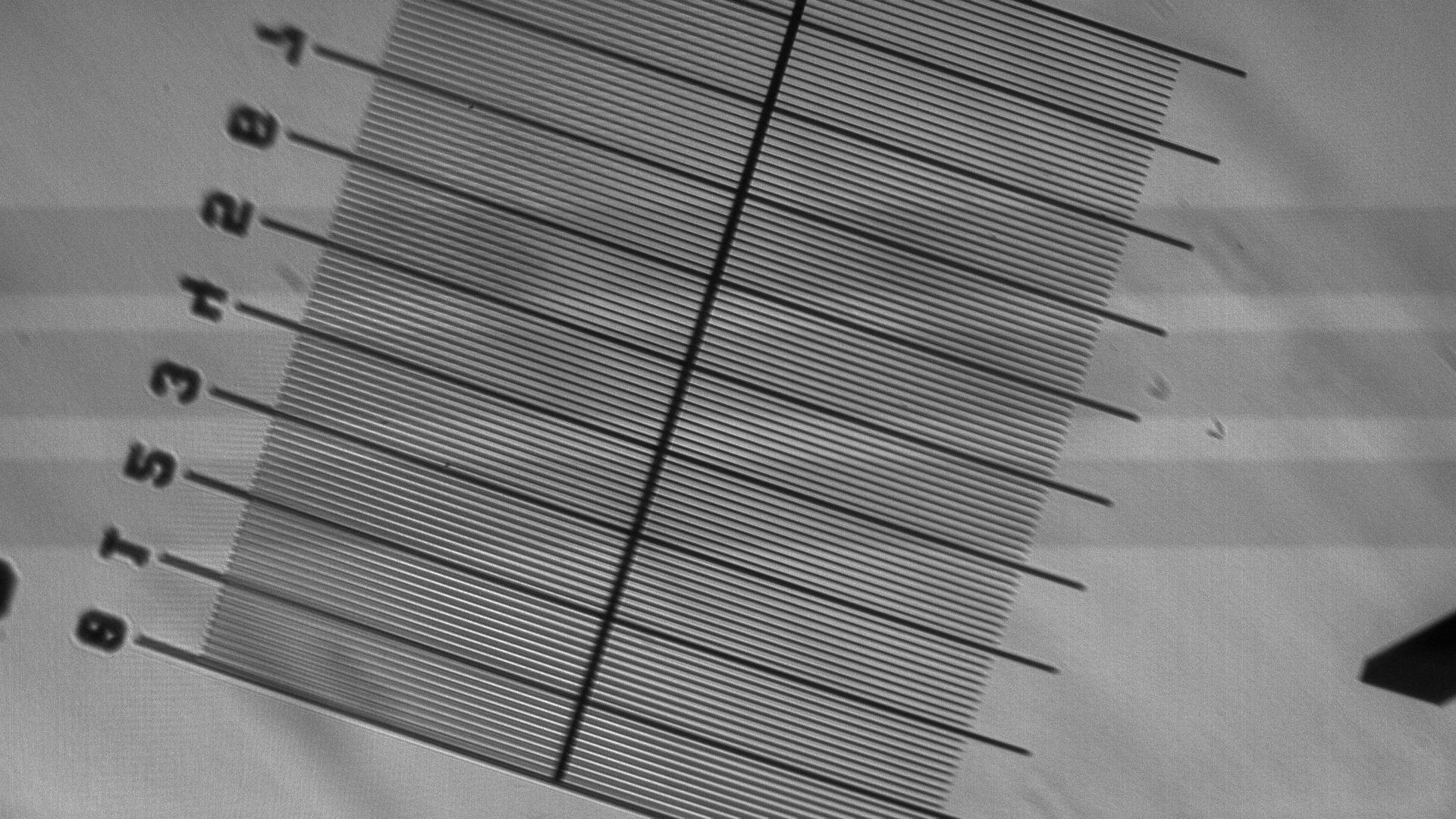

However, i can see that, while the "off" pixels seems to be completely off, the "on" pixels keep flickering a little bit. If i use short exposures i can see the image "striped" along the horizontal axis. This happens with the hdmi port, displayport, and even with the internal pattern named "Solid field". I can not recall this happening in pattern mode.
You can find attached an image of the dmd screen, acquired with 1 ms exposure time, while using it in a microscope with the "solid field" internal pattern on it. looking at it live, the stripes maintain their width and seem to move randomly across the field of view.
Is there a reason for this? Possibly an easy fix? I can still use it, but having the stripes on all images is definitely annoying.

    I believe what you are seeing here is the micromirror reset. Video mode (unless you are operating in dual pixel mode), operates at 60 Hz. This means that a frame is exposed for 16ms. You might want to try lengthening the exposure of your camera closer to that value and seeing if that improves the effect you are seeing.
