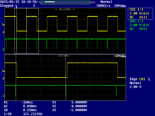

FIG2 Timig Image(CH1:TRIG1OUT,CH2:VSYNC)
    I see the input VSYNC from o-scope CH2 is 121.212Hz (8250us) which is LESS than the pattern display time 8333us. So DLPC350 is not able to complete the display sequence. So you are seeing trigger out appearing every alternate frames i.e., @ 60Hz.
    I suggest to do the following -
    reduce the frame rate to say 199Hz, then you can see trigger output appearing every frame.
    Let us know if it helps.
    Sanjeev

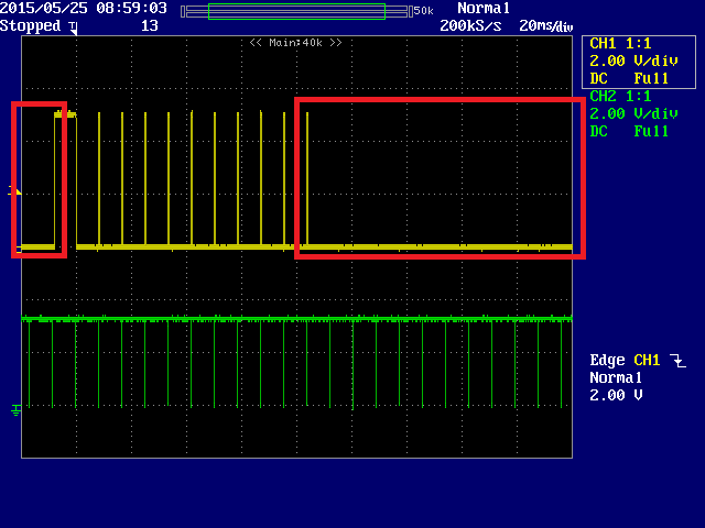

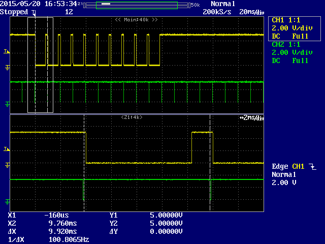

    It will attach an image at the time of 120Hz and 100Hz display.

    FIG2 100Hz(CH1:TRIG1OUT CH2:VSYNC)

  • Setting for inverting the polarity of TRIG_1_OUT we can.
    Only when at 120Hz of VSYNC, we have heard that TRIG_1_OUT after output TRIGER does not return to the Hi-Level.
    Operating Mode: Pattern Sequence
    Sequence Settings: Video port
    Timing
    Internal Trigger (us): 8333
    Pattern Exposre (us): 8333
    Pattern Sequence: 9images, Play Once
    Invert Trigger 1 Output:Check
    FIG VSYNC120Hz(CH1:TRIG1OUT CH2:VSYNC)
  • Looks like a issue in the firmware, could you run the same configuration now VSYNC @ the source to much lower say 100Hz, can you see still see the OUT_TRIG signal not going high problem.
