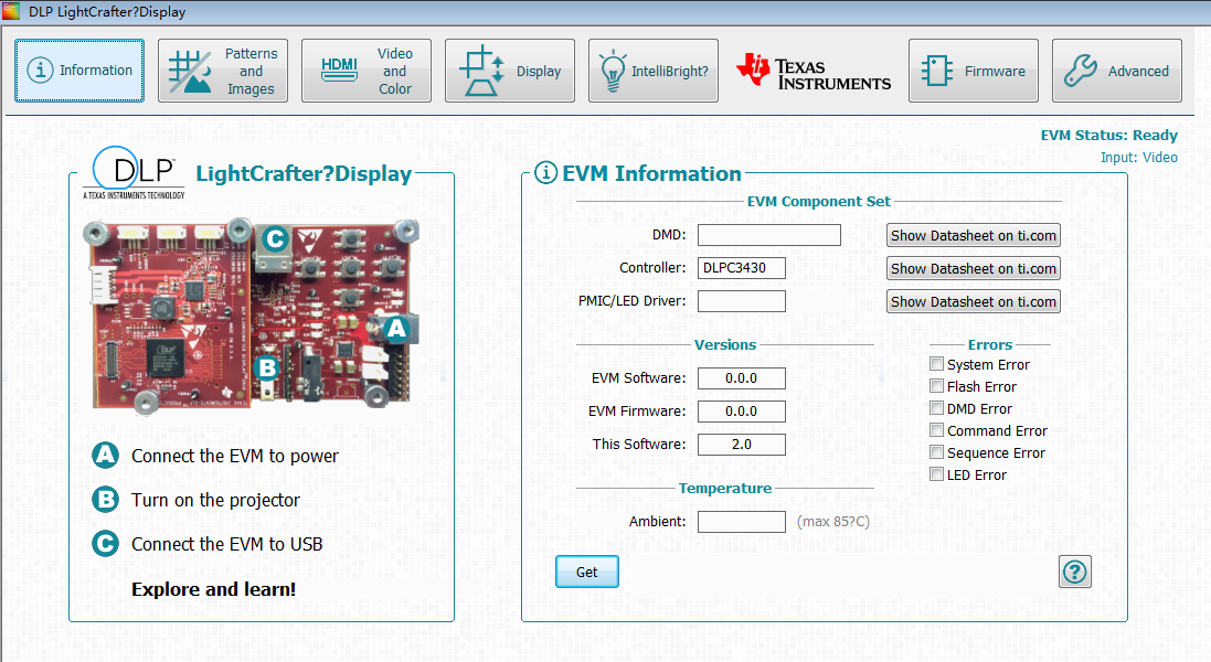

    Below is the DLP LightCrafter Image after turning the projector ON, and I cannot get correct information via "Get Button"
    It looks like the DLPC3438 is not booting. This will be the case when there is no connection to the DMD or the flash software is corrupted. Can you please verify a good connection of the flex cable to the LightCrafter Display board? I would also reload the firmware just to ensure that nothing got corrupted.

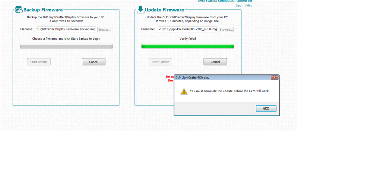

  • I tried the flow that you suggested.
    1. Reload the flash firmeware.(I backuped the image file before 3 months)
    And now while updating the firmware ,it shows:
    It seems got error !

    Can you please retry to load the flash firmware? If necessary multiple times. The flash image is now corrupted and we can not identify any issues without a good flash load.
    The VBIAS, VRST, VOFS voltages are correct in this case.
    Nadine

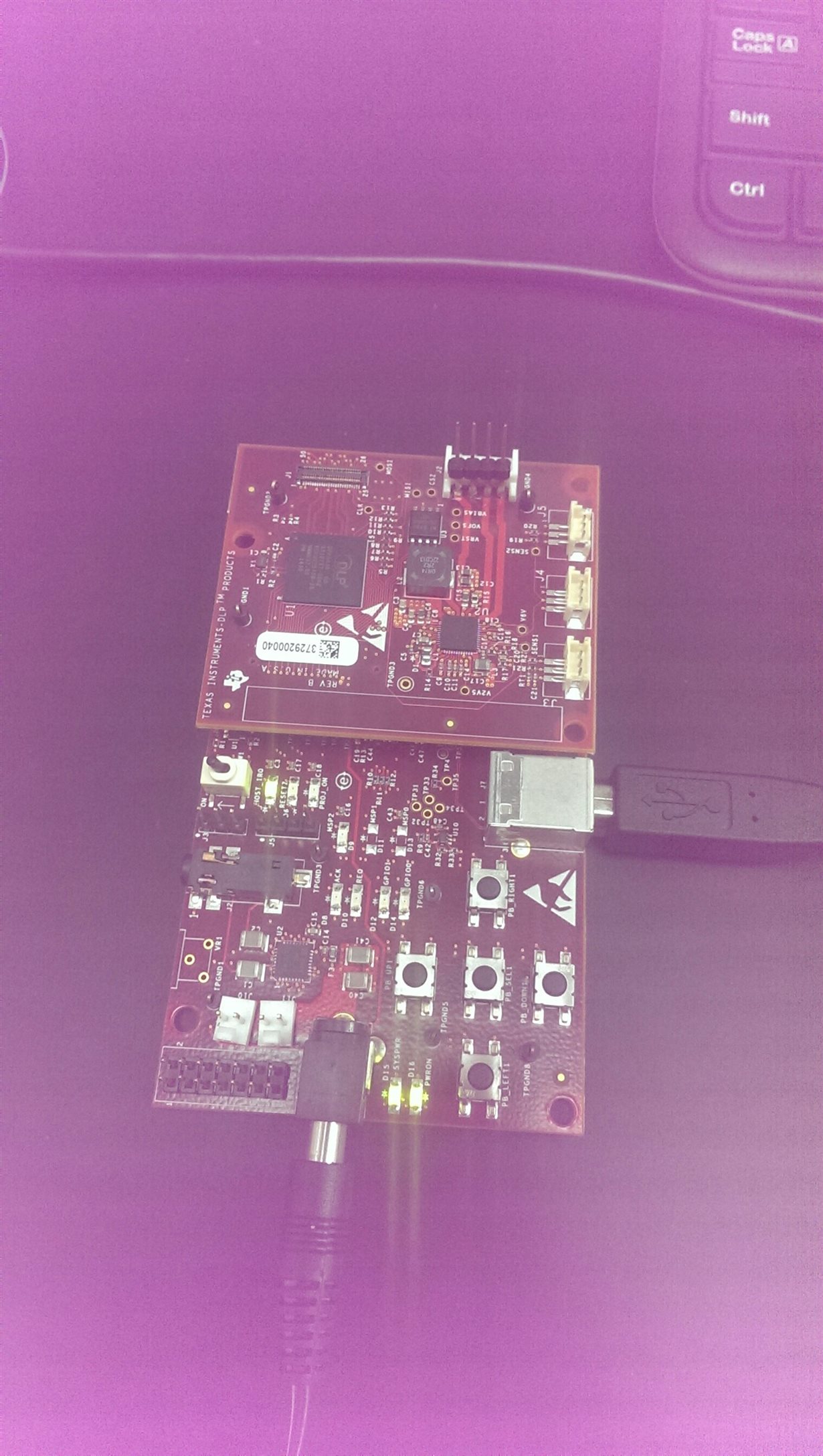

    the hardware configuration is like this :
    Any idea ?
    It could be that your flash image is not correct. Can you please provide an email address and I will send you a known good image to load into your flash ?
    I am also wondering about your LED status on the attached image. It looks like the switch is ON position and D7 is in an OFF state. Is that correct or does the image is not showing it correctly ?

  • Hello Nadine,
    I had sent you my Email address via a private message. Do you see that ?
    LED D7 is always ON when I plug the power.
    But D7 is OFF when loading firmeware.

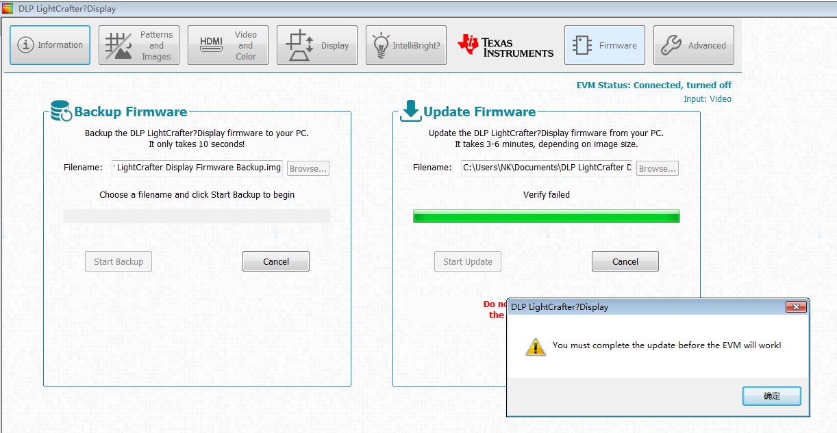

  • Hello Nadine
    I'v got the image from your coworker . I still can't load image success.
    All the loading situations are the same like this as before :
    Any ideas?
    LED D7 Proj_ON should be only ON when the power is connected and the switch is in the ON position otherwise it should be OFF.
    Can you please clarify the status of D7 and measure on the flash device if 3.3V is supplied ?
    Thanks,Nadine

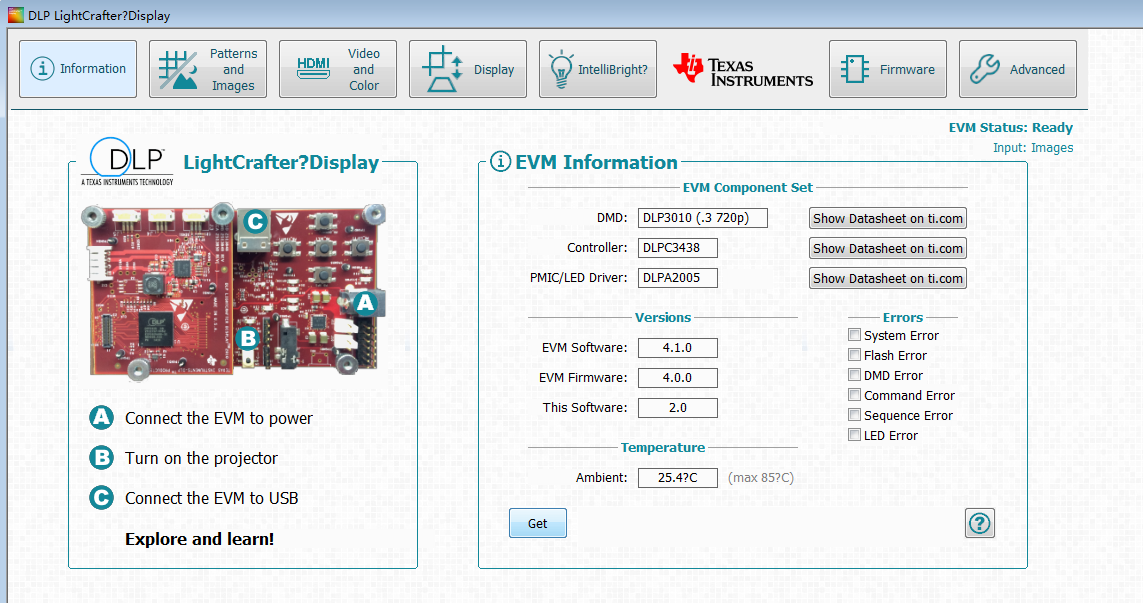

  • I was resoldering some "pins of DLPA2005" and "incuctor L2".
    FortunatlIy I can get informations correctly, like this(even in advanced tab can be read) :
    But Light Engine is still no light...

    Since the voltages are correct when the DMD is not connected I think it is very likely that the DMD or the flex cable got damaged. With your current setup you are bending the flex cable extremely have you tried to put the engine underneath the board and connect it again. It would be interesting to see if that makes a difference.
    To go forward, I would recommend to buy a new eProtech engine and this should solve the problem. Please let me know if you have any further questions.
