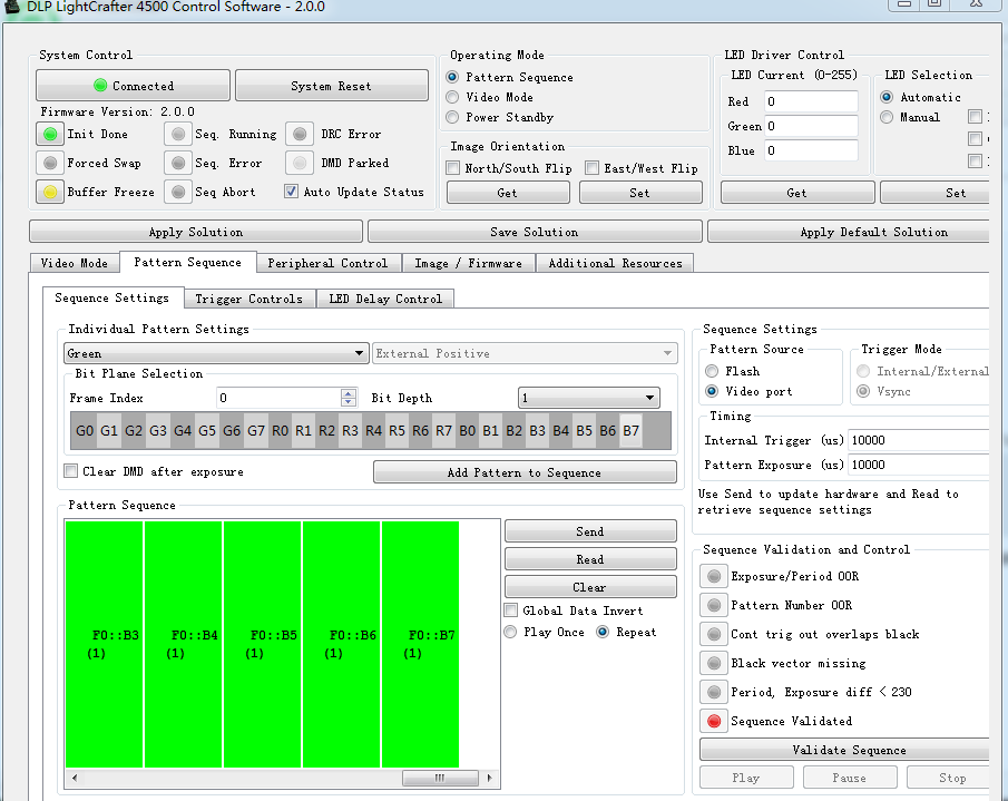

  • Thank you for your answer! USB communication is successful commissioning. I encountered a problem: during the sequence mode setting, use vsync trigger, as shown settings
    After setting, click on the "send", click "Validate sequence", appears GUI does not respond (software already dead).
    (When the test I just used a USB connection LCR4500 module is not connected external video source).
    I use monitoring software to monitor USB data, click "Validate sequence" USB return (0x1A1A) after 0x88. This warning and did not take an external video source and a relationship?
    If you have a relationship, then after sending 0x1A1A is how to detect an external video source?
  • Make sure video is connected and available before entering the Pattern Sequence Mode, once you find video is detected by DLPC350, try the steps it will work.

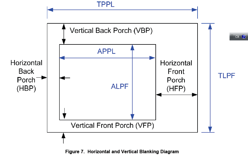

  • Thank Sanjee! I proved my raise this issue, it should be detected Vsync trigger pulse.
    I have a question:
    "The video signal for example 60Hz should as follows
         Pixel Clock: 83.6 MHz
    Horizontal:
        Active Time:        912 Pixels
        Blanking Time:  280 Pixels
        Sync Offset:       40 Pixels
        Sync Pulse Width: 64 Pixels
        Border: 0 Pixels
        Frequency: 70 kHz
    Vertical:
        Active Time: 1140 Lines
        Blanking Time: 30 Lines
        Sync Offset: 10 Lines
        Sync Pulse Width: 6 Lines
        Border: 0 Lines "
    1)"Blanking Time, Sync Offset, Border" and "HBP, HFP, VBP, VFP" numerical relationship? I know the Active Time = APPL (ALPF), also know Sync Pulse Width.
