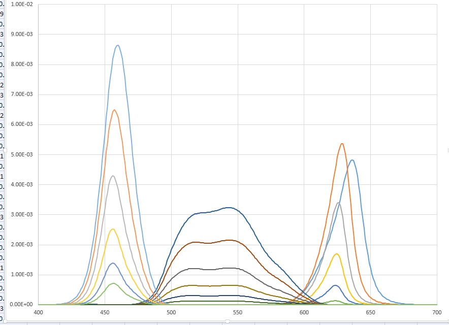

  • Hi Clinton,
    I am still having the same problem. My boss ended up buying me another 4500 so I was able to continue moving forward with the project, but ideally I'd like to get to the heart of this. I am hoping the first LightCrafter is salvageable! It's been a long time since the initial post, but I was wondering, still, if you had any further thoughts for us. I appreciate all your help so far.
    Just FYI, I'm going to attach the light measurements I had taken from the Red primary between 5 and 255 inc 5, and from the R, G, and B primaries at a much courser resolution. The Blue and Green LEDs look like you might expect with small shifts in the peak wavelength as a function of current. However, the Red primary (this is obviously before we had all this trouble) looks very different and, in reality, the highest intensity red value was at 190, not 255. Plus there is a very strange shift. Might we have had a defective unit from the getgo (all measurements taken before it stopped working)?
