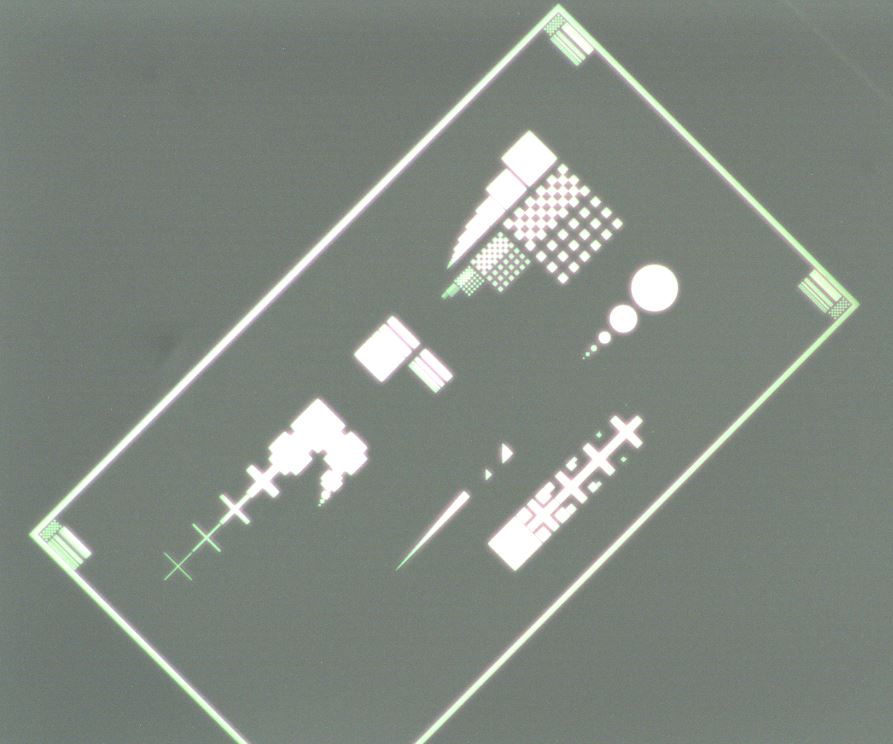

ive got an urgent question. I bought the DPL6500 evaluation module. I illuminate the DLP chip and image the chip with an objective on a plane.
My Problem now: On the imaging plane i didnt have on each pixel the same intensity (see attached picture). Can i eliminate this problem with a pattern frequency of each mirror? Can i controll each mirror with an other frequency? If yes, how can i controll it? Is it also possible to work with grayscale? If yes, how can i work with a grayscale?

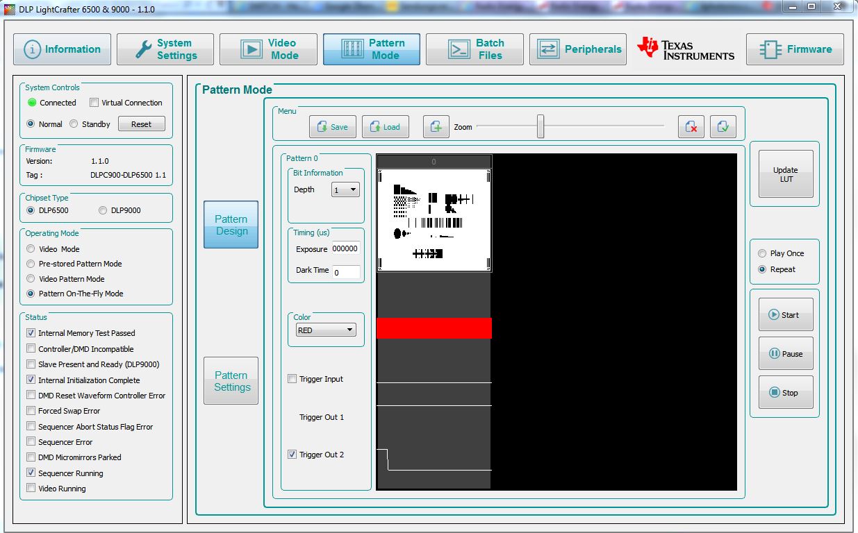

At the moment i use the free software to controll the Chip. I work in the "pattern on the fly mode" (see attached picture).

    Yes, you can use gray scale. The result of using gray scale, as you suggest, would be that the pixels would show up with different intensity when integrated over time. I see in the picture above (thank you for attaching the picture, it is helpful) that you are using a 1-bit depth image. This uploaded image appears black and white as is set as 1-bit depth. If you upload a gray scale image, and change the bit depth drop down box in the GUI to 8, for example, the DMD will display the gray scale image.

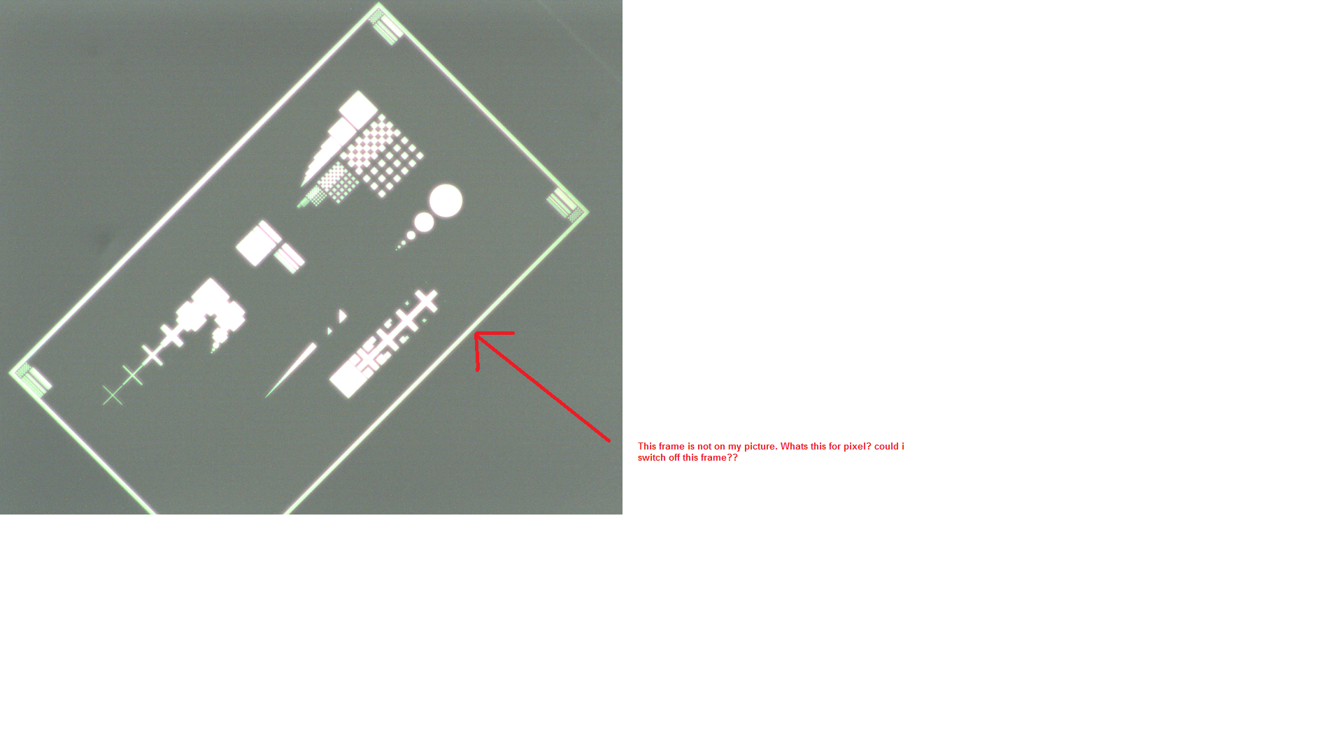

    i hope my last question :) : why i have in the projected image a frame? This frame is no in my picture (see attached picture).

    Looking at it more closely, in addition to a "frame" appearing around your image, the image seems to be inverted. What is white in the preview GUI image is black and black is white. Knowing this, I believe your illumination is coming from the opposite side that it should be. With your illumination 180 degrees off, you are illuminating the "off-state" mirrors.
    As background for what's happening, the active DMD array of mirrors is surrounded by a few rows of mirrors that remain in the off state during operation, we call this the Pond of Mirrors or the POM (this should be covered in the array characteristics of the datasheet). With your illumination coming from the opposite angle, you are illuminating the areas of the image that should appear black, including the POM.
    Therefore, if you flip your DMD or optics 180 degrees, this problem should go away.
