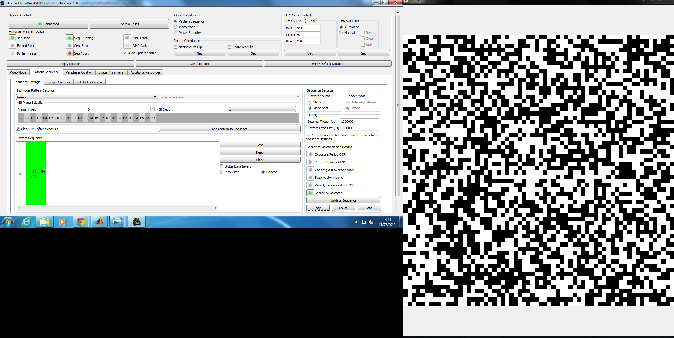

  • Below is a voltage/v against time/s plot of the photodiode detector reading. The large spike near 0.07s is probably the DMD clearing after a pattern exposure.
    Here is a screenshot of the UI, and the static black and white image being displayed via HDMI.
  • Since you have configured the source as external RGB video input, let me know what is the incoming source rate?
    A pattern display time of 1000000us requires the source to be @ 1Hz. The DLPC350 works b/w 10Hz to 120Hz so I suggest you to look at reducing the pattern exposure times. To begin with experiment for 60Hz fps, for this you can set value to like 16000us.

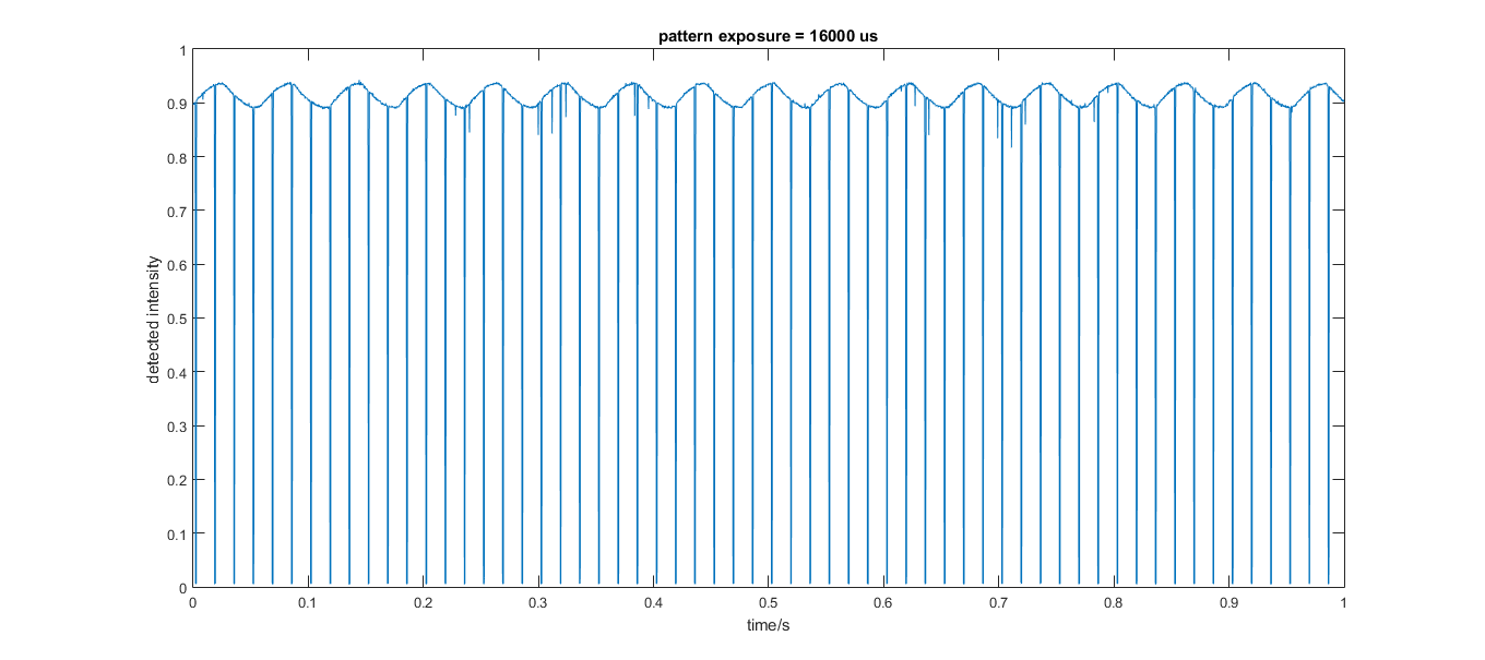

    I'm Joe's colleague who is also working with the DLP LightCrafter 4500. We are running the DLP as if it were a second screen to the computer from which we are controlling it from, and this second screen is set with a refresh rate of 60Hz (and resolution of 912 x 1140). I have tried your suggestion of setting it to 16000us, for both input sources (flash and video mode) but it does not change this oscillation. I attach the screenshots below. Any idea of where these oscillations may be coming from?

  • Hello Cheryl,
    Sorry for the delayed reply; i was out for sometime.
    There are two things in the w/f for either case -
    A)  vertical lines going all the way to 0.  This is clearly happening after DMD exposure completion for example in 100ms at 16.67 ms you will find 6 dips 100/16.67.
    B) Sinsuoidal behavior - I am guessing it is more to do with the LED driver and LEDs analog output, DLPC350 or DLP4500 not coming into the picture for this variation. Looks like for the same current and exposure duration, the intensity building for three iterations and falling after that in cyclical fashion. Just to rule out the Detector you can look at the analog output of the detector, when it is looking at LED powered directly i.e., without modulating.

  • Hi Sanjeev,
    I think I found the reason for the oscillations. I believe that it's due to the voltage input to the LEDs being modulated by PWM. When I set the LED current to 255 (maximum), the oscillations disappear, as would be the case if PWM was causing the oscillations. I attach the measurements below. The data has only been filtered for the spikes in the data.

  • Hi Cheryl,
    Thank you for sharing your experimental results. That proves the LED driver associated circuit causing issues at lower PWM current settings.

    I'm Mark's colleague (post above). As Mark said we have seen the same 15Hz oscillation which goes away if the LED currents are set to maximum. After a good amount of head-scratching, we think that this 15Hz signal is not real, but an aliasing artifact from digital sampling of the photodiode signal. When we increase the sampling rate on our ADC (originally 10Khz), use a faster digital oscilloscope, or an analog oscilloscope, the 15 Hz oscillation disappears. With sampling rates greater than ~50Khz there is no 15 Hz oscillation, but there is an oscillation around 10-15Khz. This fast oscillation does appear to be real, and also disappears at maximum LED currents. For our purposes this is oscillation is way too fast to be a problem.
    Cheryl - I suggest looking at the photodiode signal with a faster sampling frequency or with an analog oscilloscope to see if your 15Hz oscillation disappears and a faster (~10-15Khz) oscillation appears. If you check this, would you please let us know the results? It would give us some more peace of mind that the 15Hz signal is just from aliasing this faster oscillation.
