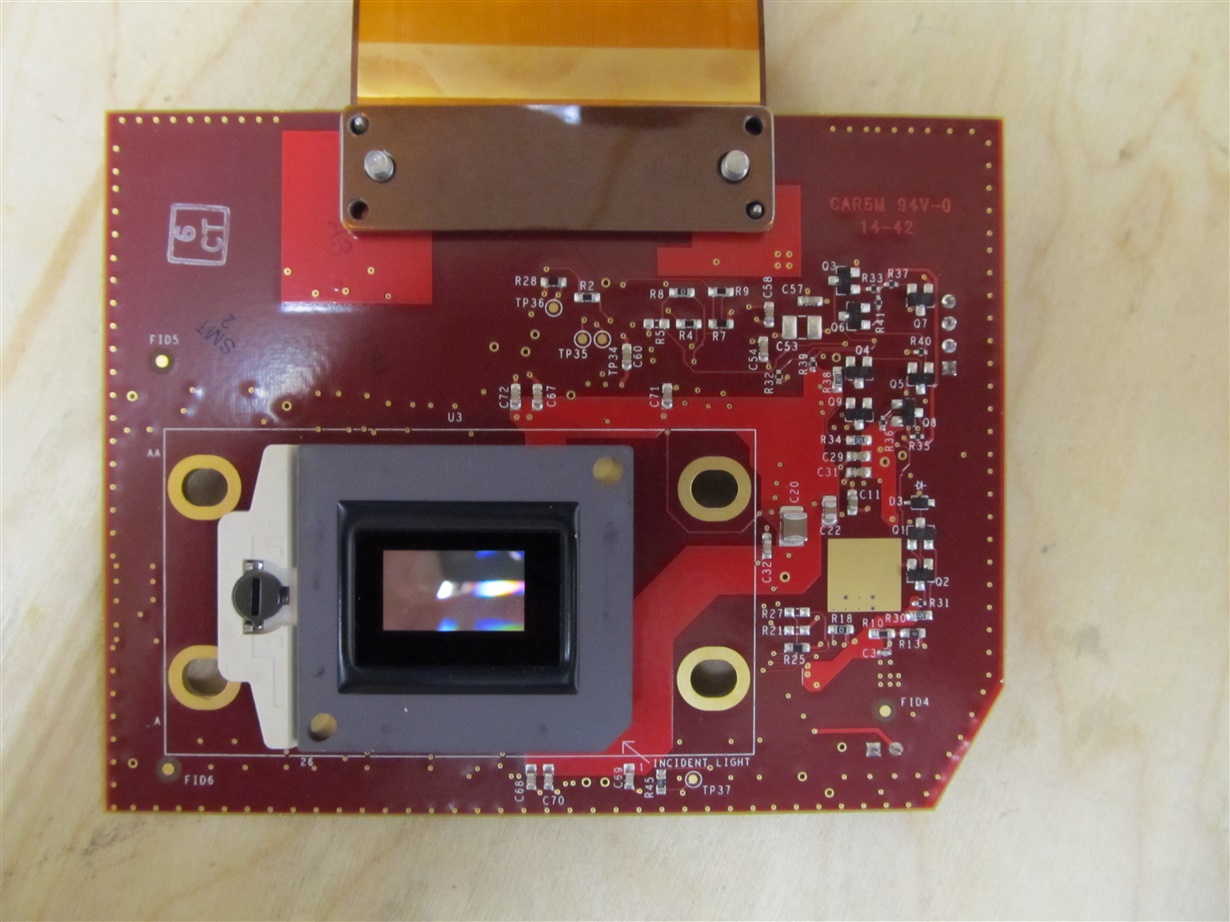

    I'm sorry you are experiencing an issue with your LightCrafter 6500. I have a few questions:
    1) When (roughly) did you purchase/receive your LightCrafter 6500?
    2) Can you attach a picture of the EVM (showing both the controller board and the DMD board)?
    3) I am guessing the green "Connected" light is lit up in the upper left corner of the GUI, am I correct?

  • In response to your questions:
    1) Our PO to Digikey was issued 6/8/15, we received the Lightcrafter 6500 6/24/15.  The date code on the package appears to be 12/19/14.
    Package label
    2) Here are pictures:
    DLP Board
    Controller Board
    Mounted for use in our system.

  • Bill,
    From your pictures, it definitely looks like a DLP6500 DMD and controller board.
    It is possible that the firmware was somehow corrupted, so try re-loading the firmware on the board and see if that fixes the problem.
    The LightCrafter 6500 and 9000 User's Guide should be able to walk you through that process. Let me know if new firmware (make sure you are using version 2.0 -or later for future readers) corrects the issue. You should see default splash images on the DMD at startup.

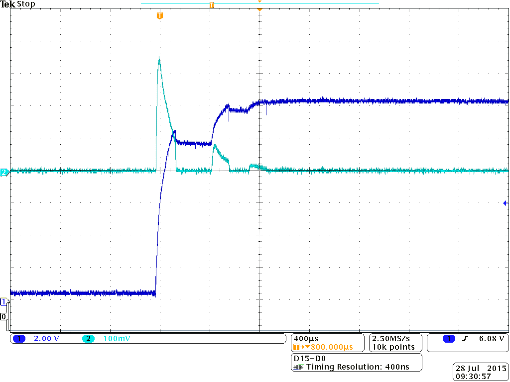

  • Hi Bill,
    I wanted to let you know that I am investigating your problem further.
    In the meantime, can you send me the voltage and current specifications on your power supply?
    Trevor
  • Power supply is an I.T.E. Power Supply model CENB1060A1203F01  output +12 Vdc, 5.0 Amps (Digikey 271-2718-ND) as recommended in the documentation.
    My voltmeter reports the operating supply voltage of 12.067 Volts, a current draw of 211 mA.
    Power on transient as shown. Trace 1 supply voltage, 2 V/div, trace 2 supply current 100 mV/Amp.
    I also ran the unit from my Agilent E3649A lab supply with similar results.
    Bill
  • Hi Bill,
    Everything seems to check out correctly on your EVM and your power supply, thank you for your thorough replies.
    I think it's possible that the tight "S" bend you have on your flex cable could have caused some damage. Can you inspect your flex cable and let me know if you see any signs of damage on it?
    Trevor
