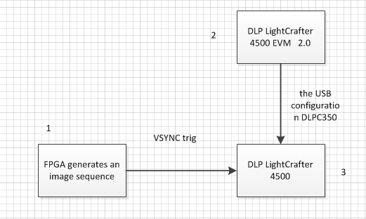

  • I used DLP LightCrafter 4500 serial mode, an external video source. I would like to use vsync trigger, external FPGA generates an image sequence mode, my question is: Under this external vsync trigger mode, video source to generate the FPGA program how to write. Please describe in detail. THX! My system diagram is as follows:
    My mode of operation is as follows:

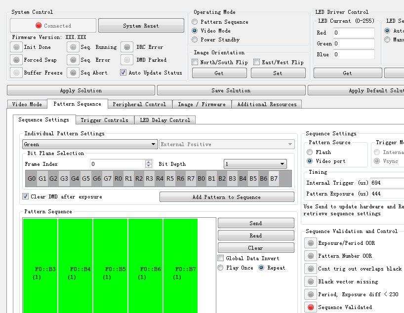

    1. Use an external MCU via the USB configuration DLPC350 enter sequence mode, using vsync trigger. This part is no problem.

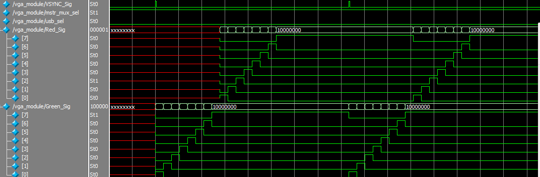

    2.FPGA Programming: program generation sequence is transmitted to DLPC4500 module. But I do not know how to program? My approach is:
    I wrote FPGA simulation generates an image sequence diagram, I do not know whether my approach is wrong or what other reasons, DMD has no reaction, it does not show anything.

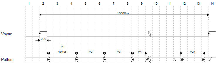

    Yes, you should still need to send video signal as you are sending in Video Mode. So signal timing wise it is all same. Only thing you should be aware about is that - In Video Pattern Streaming mode - based on the patterns you are interested to display from a RGB 24-bit frame, the SUM of ALL pattern exposure in that frame must be <= the actual VSYNC period.
    For example:
    To display 6 4-bit patterns with pattern exposure as 2000us; then the total display time of all 6 patterns 2ms * 6 = 12ms. So the incoming VSYNC period has to be > 12ms; therefore maximum frame rate you can send will be <= 83Hz.
    Now if you want to change the pattern exposure to 4000us then total time take to display 6 patterns from a frame will be 4ms * 6 = 24ms, so frame rate has <= 41Hz.
    Key is to generate 912x1140 video at frame-rate matching to the sum of ALL pattern(s) exposure timings.

  • How are you generating the video frames in FPGA ? It is going to be same in Pattern Sequence mode also, for example, if a image is stored on the flash memory, your FPGA can read the image data send it over the video port or video buffer of your FPGA.
    Regards,Sanjeev
