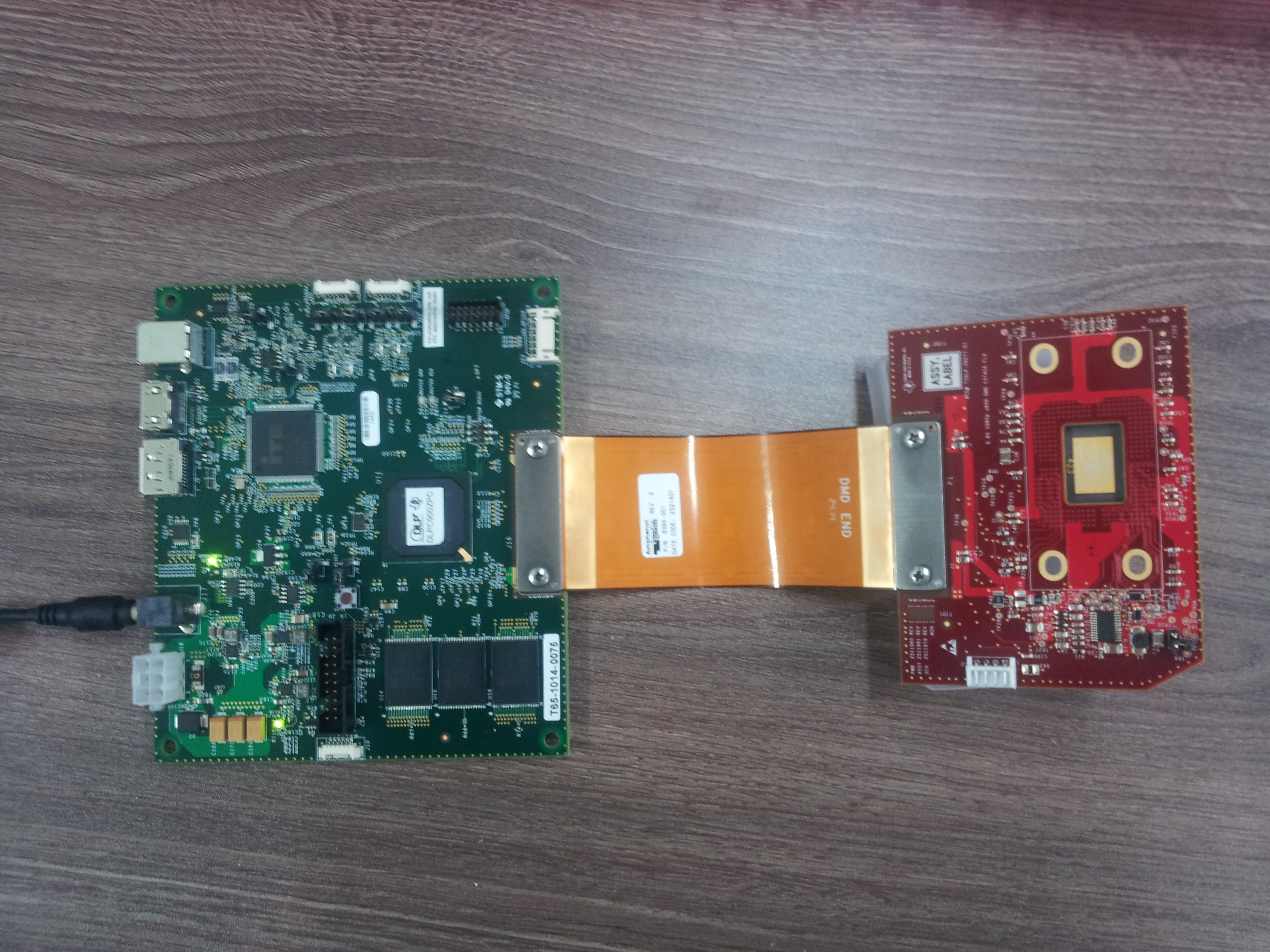

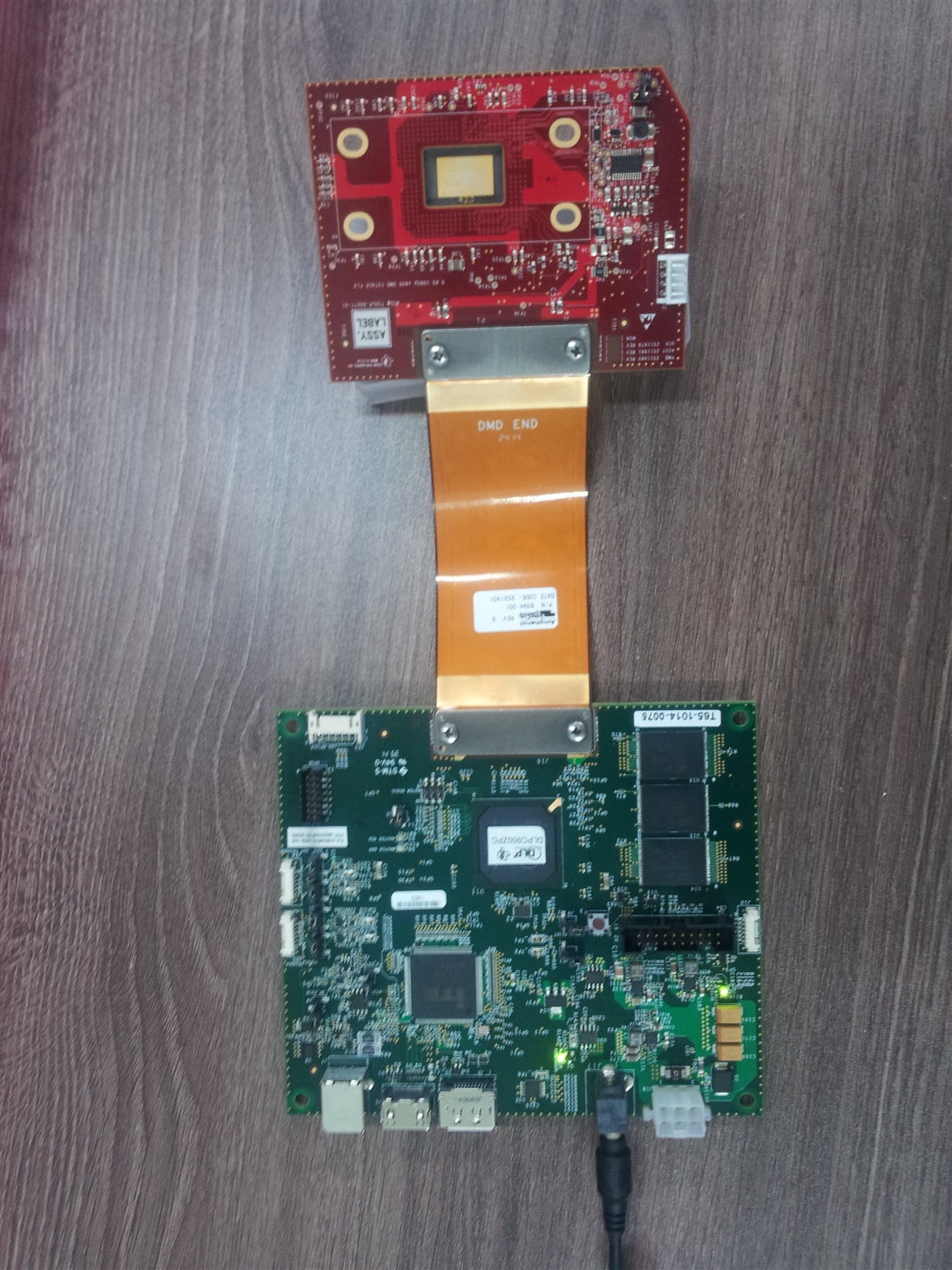

    I am studying DLP6500 with DLP6500 EVM board.
    I bought this board from TI estore.
    But, my 6500EVM board has two problems.
    The first problem is that the JTAG Programmer occasionally don't detect the board.
    In order to program boot loader image, I have to try to detect it many times
    This symptom happens from time to time.
    The second problem is very serious.
    The 6500 DMD chip is going to damage while running the EVM board.
    Already my 2 DMD chips were broken when it's running state.
    I want to know how to solve this problem.

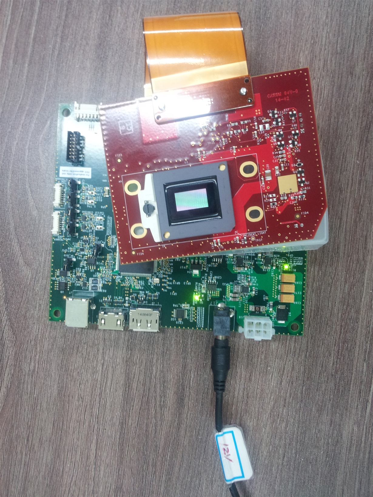

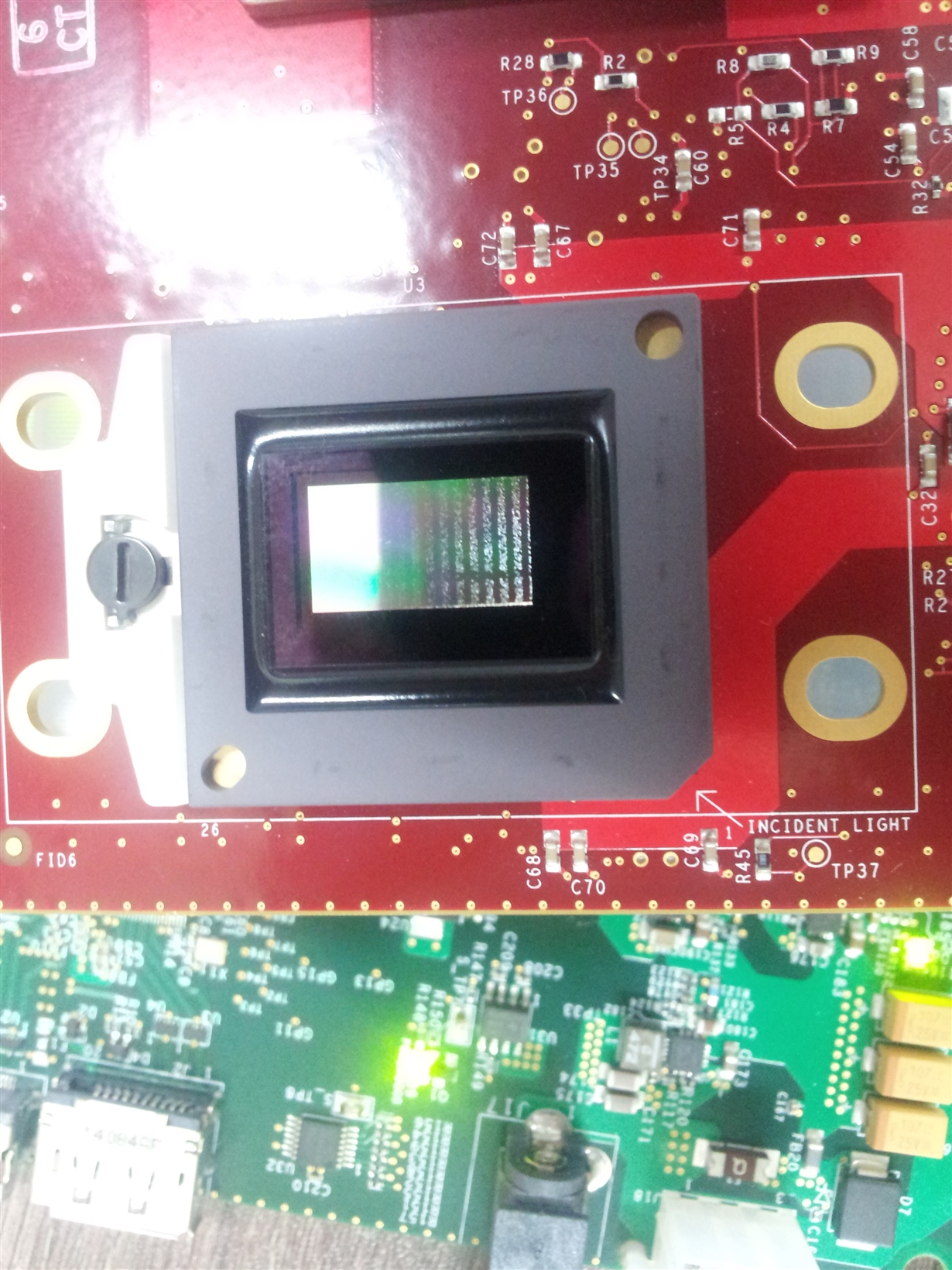

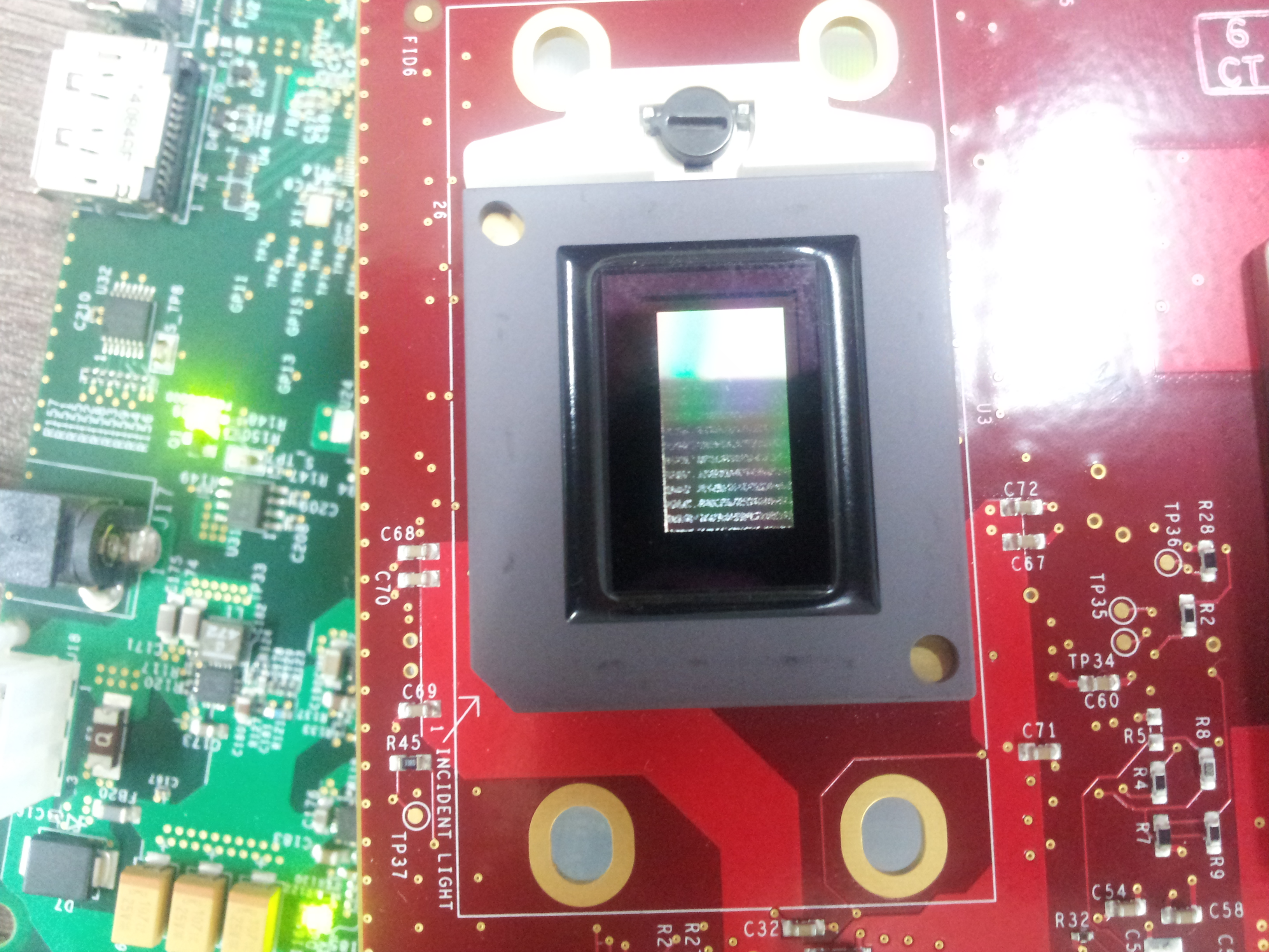

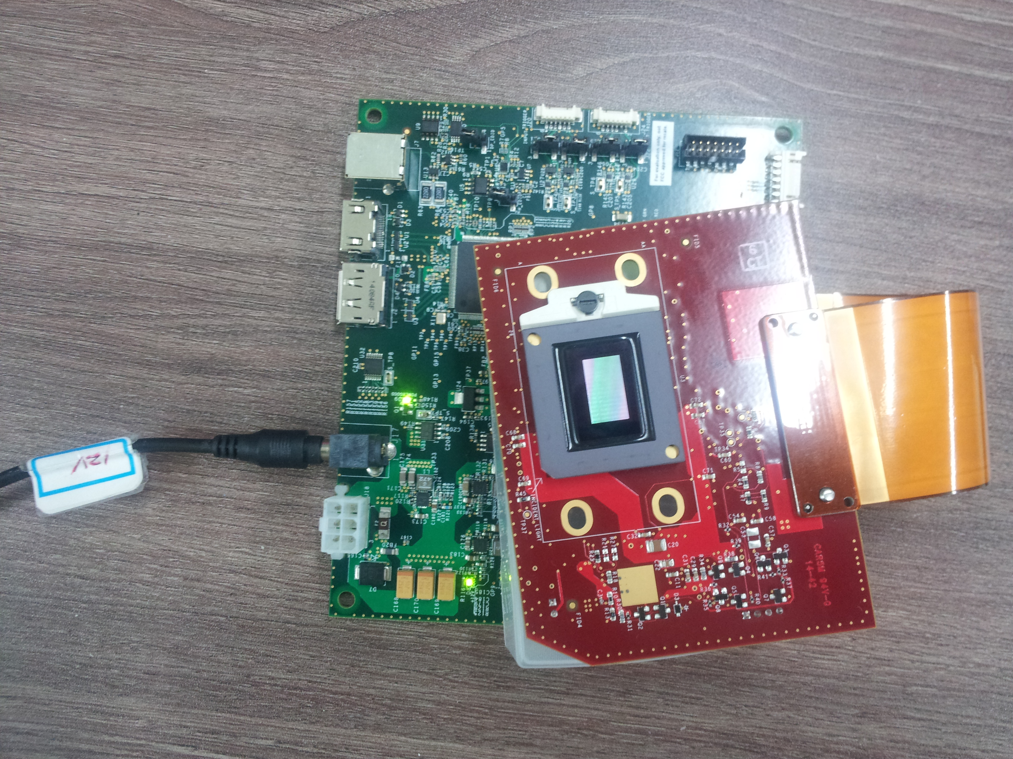

  •    Dear Trevo,
    Thanks for reply.
    1. When damaged, DMD do not display. I think the main board works well because LED D9 blinks
    2. After power on, it stops displaying in one hour, I guess. I didn't check the time
        After power on, the board runs itself without any action by anyone
    3. I attach the picture below
  • Hi YJ Han,
    Do you notice any of the chips on the controller board getting hot when the board is plugged in? Specifically, check the ITE chip (IT6530) and the DLPC900 chip. I would not recommend replacing the DMD on the board at this time.
    Trevor
