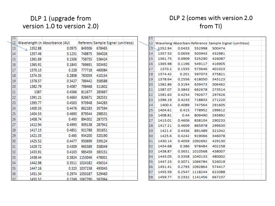

    The problem faced likely to be successful. We buy two DLP NIRscan, one comes with version 1.0 and the other comes with version 2.0. We are done upgrading DLP NIR Scan from version 1 to version 2. We tried to do measurement to compare the spectra of sample using both DLP NIRscan. DLP 1 refer to the DLP that we upgrade from version 1.0 to 2.0 whereas DLP 2 refer to the DLP that comes with version 2.0 from TI. We used palm oil as the sample and observed that the pattern of spectra is likely to be same but the wavelength is different (as attached). May I know why range of wavelength is not same for both dlp?

  • Hello Yaa,
    What you are seeing is the result of factory calibration.  The DMD is mounted in the system and then calibrated through software to account for mechanical variations in the system.  The nearest that it can calibrate is one pixel width.  Notice that all of the differences are less than a nm.
    The spectral resolution is at least an order of magnitude larger, so that the calibration differences you see will not affect your readings in any significant way.
    One way to handle this is to use a spline interpolation on both sets to map into a common set of wavelength values from each unit.
    I hope this helps.
    Fizix

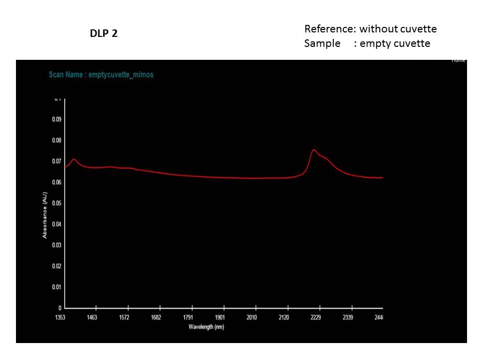

  • Thank you for your respond. Fr your information I also performed scan of empty cuvette and no cuvette used as reference. By compare using both dlp, I observed that the pattern of spectra is almost the same and peak of spectra fall on same wavelength. But for DLP 1 (DLP that has been upgraded), the range of absorbance is lower than DLP 2 (DLP with version 2.0 from TI) which is 0.05-0.07AU for DLP 1 and 0.06-0.07AU. I wonder this issue will affect the spectral measurement of sample.
  • Dear Fizix, I used sequential scan method with spectral range 1350-2450, 275 wavelength point with resolution 4 nm for spectral measurement as mentioned above. Does this setting will effect the calibration difference?
