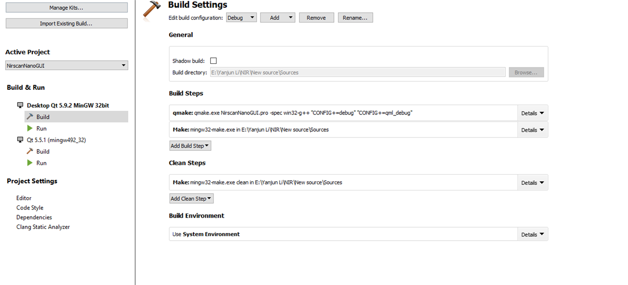

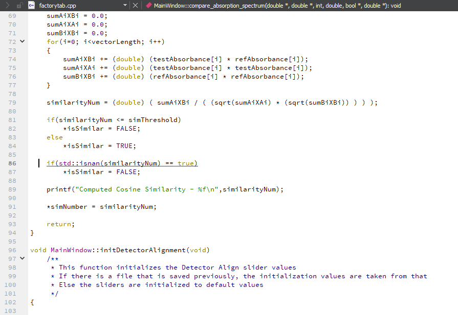

  • Hi Eric,
    I am trying to develop new scan pattern with the spectrum library 2.0.3 and GUI2.1.0. First I would like to learn from the original code, so I complied the spectrum library using MinGW530_32 and try to build the GUI using Qt Creator 4.2.2. But I have two errors with factorytab.cpp. Could you please guide me how to fix this? Thanks,
    Yanjun
  • Hi Yanjun,
    I faced this issue in the past and I am trying to remember what I did to fix this. Can you tell me what your project/build settings are? I believe you have to uncheck "shadow build" to get a successful build to work.
    If I remember correctly, the error being thrown because of the std name space call there.
    Here are my settings:
    Let me know if that works for you.
    Paul

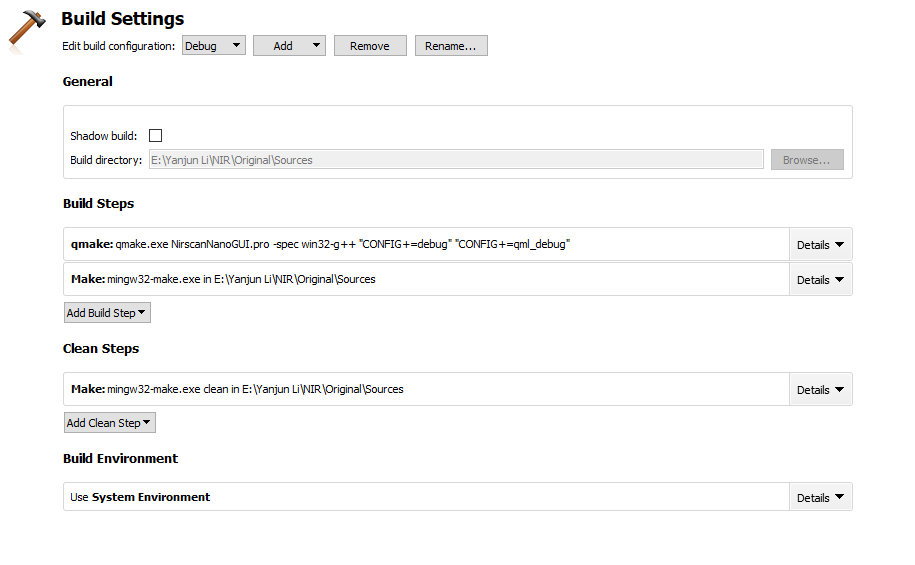

  • Hi Paul,
    Thanks for your information.  I tried to uncheck "shadow build", but it doesn't work. I still have the same error. Here is my build settings.
    Please let me know if further information needed. Thanks,
    Yanjun
  • Thanks for trying that out. I spent a little more time poking around and thinking about what I did to get around this issue.
    Can you try using QT MinGW 5.8 instead of 5.3? I believe that when I changed to 5.8 that the error went away.
    -Paul

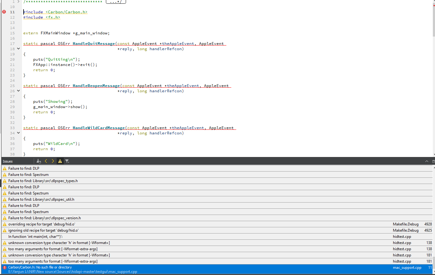

  • Hi Paul,
    I get around that error but have another error here. BTW, I use the latest Qt 5.9.2. Do you think this is the reason?
    Here are the setting and error.
    Yanjun
  • Hi Yanjun,
    I haven't seen that Carbon.h file before. Is that part of your custom software? If not, could you tell me where to find it?
    For the error - I would try to install 5.8 if you are able because I am able to verify that it works on that version.
    -Paul
  • Hi Paul,
    Thanks for your suggestion. I have figured out the problem. We need to use Qt5.8 to compile the GUI. But I have another quick question about the scan configuration in the GUI. How does the GUI calculate the "Max patterns used"? Could you please give me some hints? Thanks,
