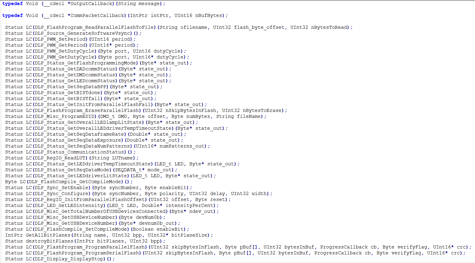

  • Hello, Sanjeev,
    Thanks for your help.
    I modified the PortabilityLayer.h file. The following images show how I modified this file.
    The following steps show I imported the PortabilityLayer.h and PortabilityLayer.dll files to LabVIEW.

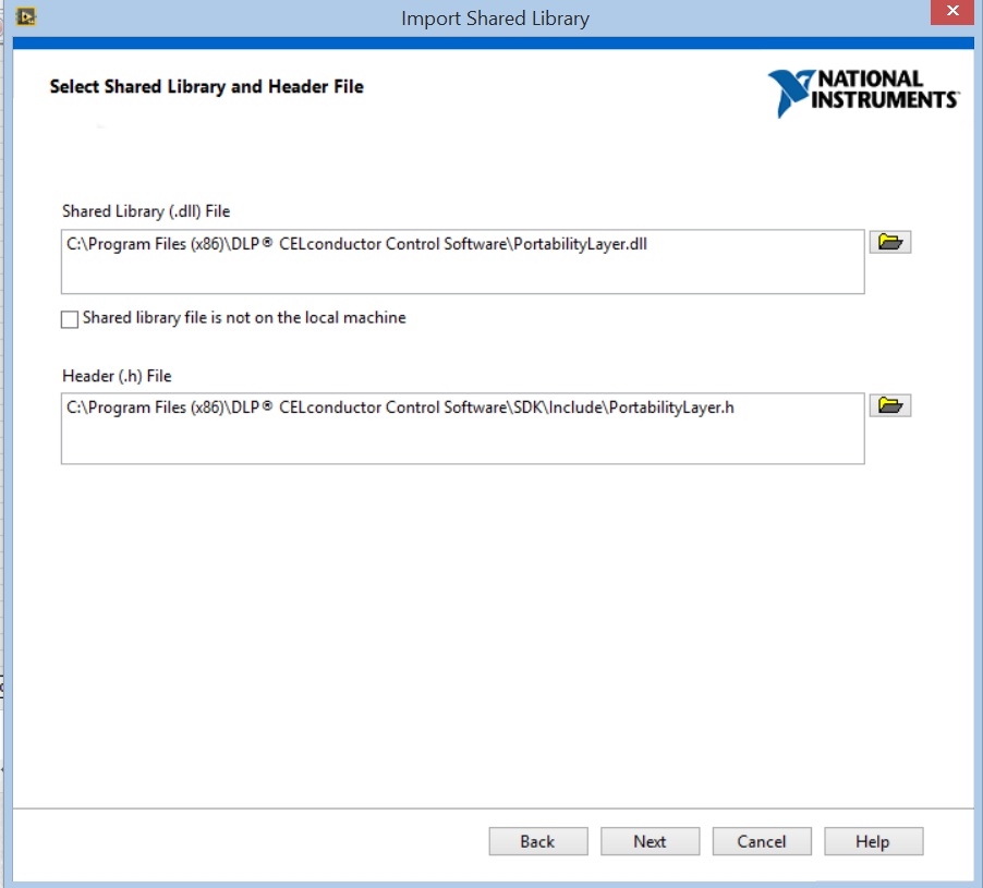

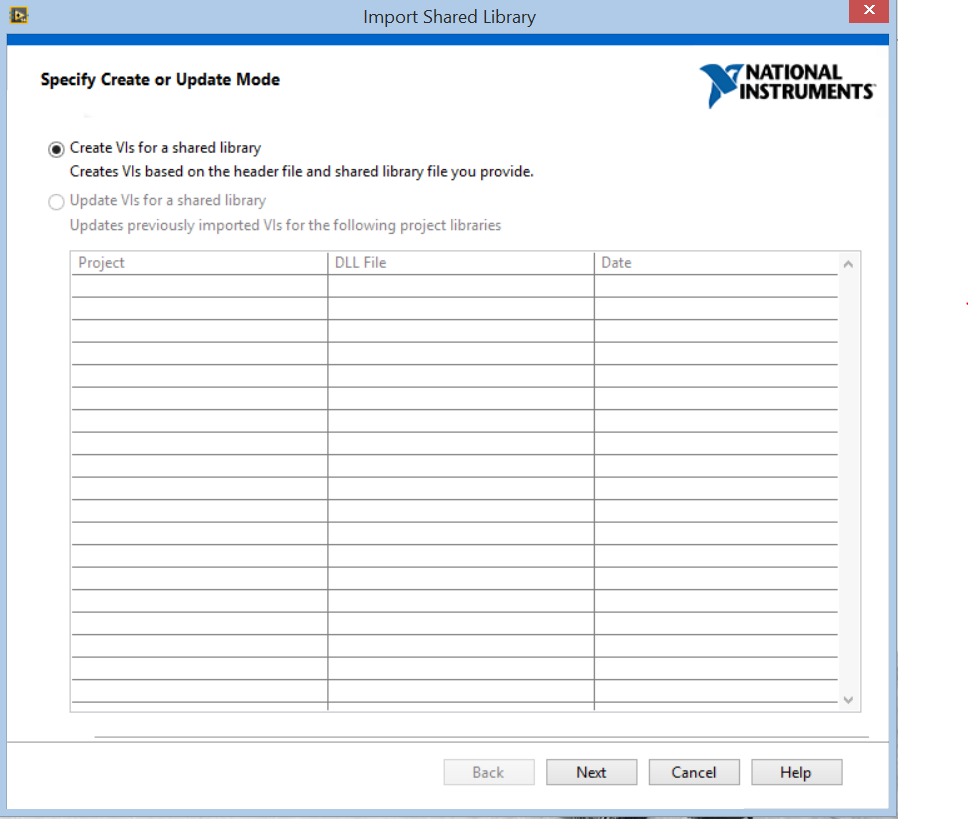

    Step 1: Import Shared library
    Step 2: Select the shared library file and header file.

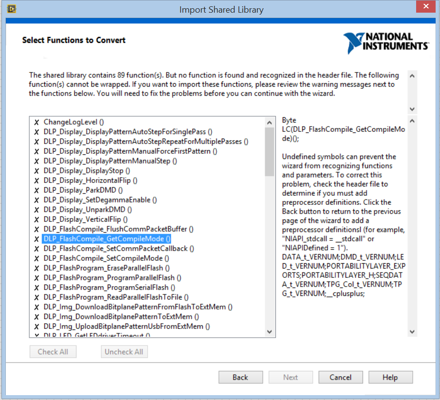

    Step 3: Include Paths and Preprocessor definition (I am not sure if this step is correct, I did not define any preprocessor here).

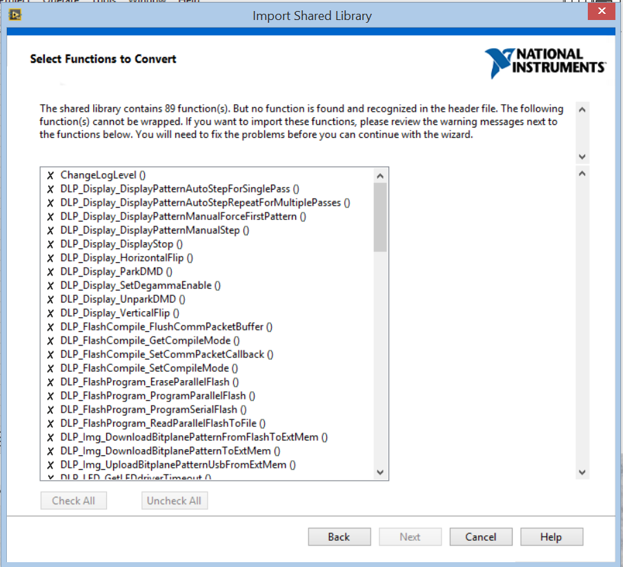

    Step 4: It said that no function is found and recognized in the header file.
    The following error information indicated that maybe I did not define the preprocessor correctly.
    Do you know how to solve this problem ?
