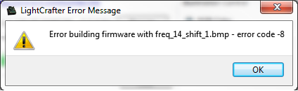

  • I have an error message while uploading.
  • Hi Bryan,
    Could you share the file sizes of the images you are uploading? Based on the error code that is being thrown, you are exceeding the flash memory size.
    This error is set in the 'DLPC350_Frmw_SPLASH_AddSplash' function (found in dlpc350_firmware.cpp) that is called when the 'Save Updates' button is pressed in the GUI. Pushing this button, executes the 'MainWindow::on_pushButton_FWBuildNewFrmwImage_clicked()' function (found in mainwindow.cpp).

    Each image is 2.97MB. Here are a few more questions regarding this issue.
    (1) I believe my evaluation module has 32MB flash memory storage. Would this mean that I can store only about 10 ~ 12 images of 3MB?
    (2) In the EVM manual, it says "Flash images: single-frame, 24-bit Still images stored in external flash memory. The flash memory supports up to 32MB of storage with up to 64 images." on page 29. What is the maximum size of image file if I'd like to upload full 64 images?
    (3) From our experience, we were able to upload 60 images of 2.97MB each with ver 2.0.0 GUI and Firmware before. I'd like to replicate it, but do you have any suggestion for me to do that?
